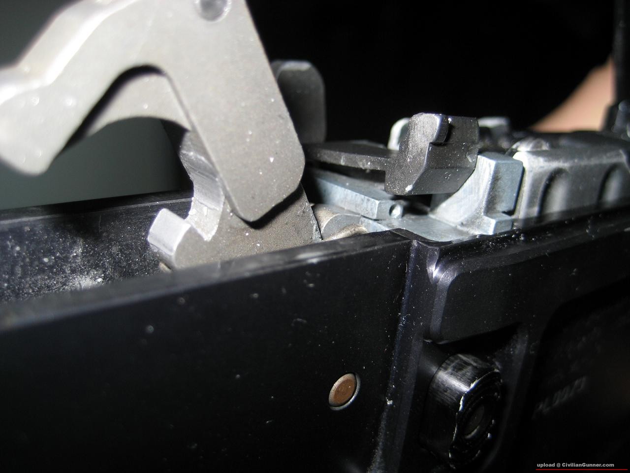

作者: F22    時間: 6-4-2011 07:38
原帖由 nok7689 於 6-4-2011 07:33 發表
而家最慘係我用返原裝個個BUFFER同彈弓都無連發
一陣我會試下成支打散睇下有咩問題~
多謝大家先~
用番原裝彈弓配重BUFFER睇吓得唔得?

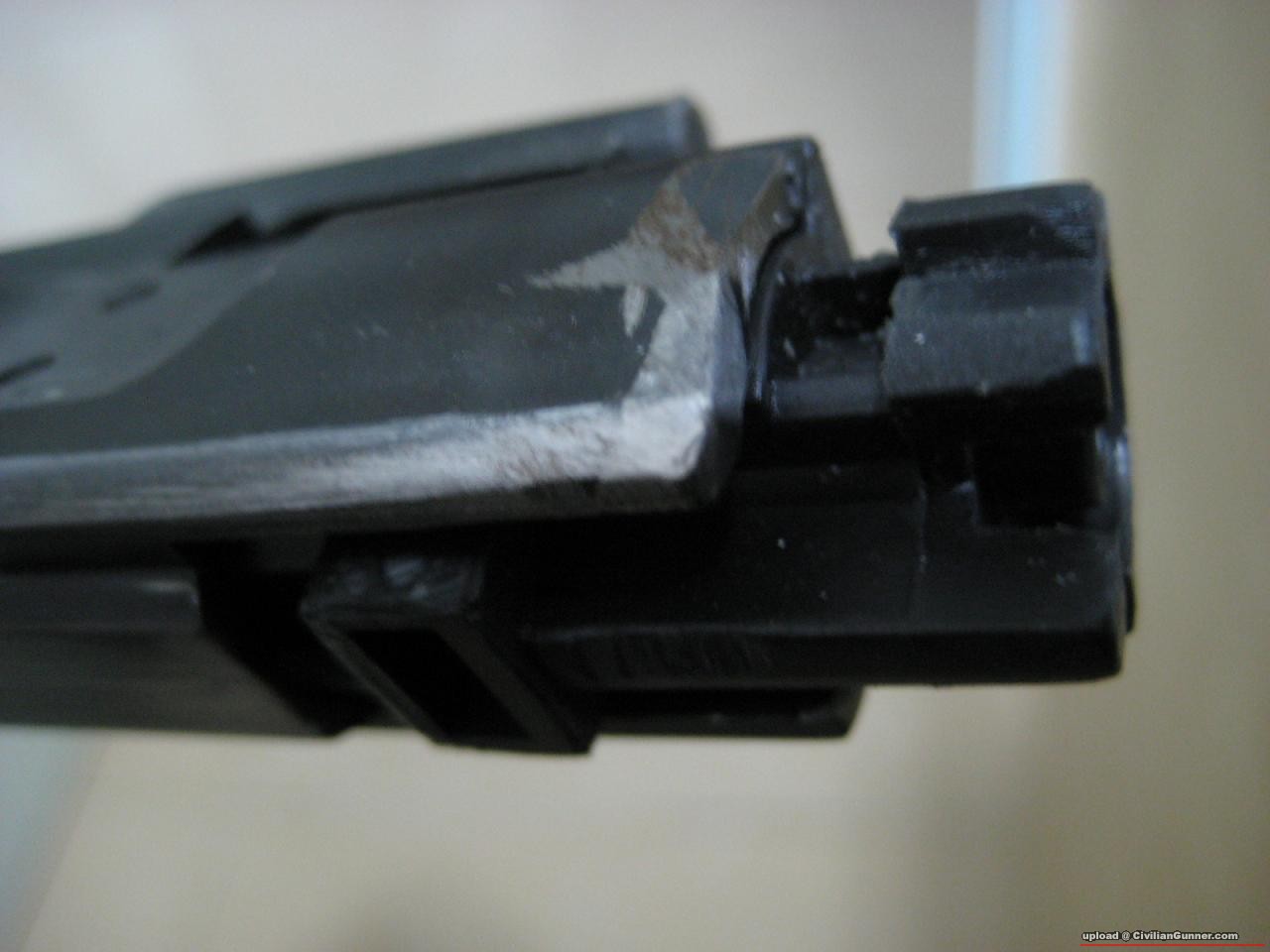

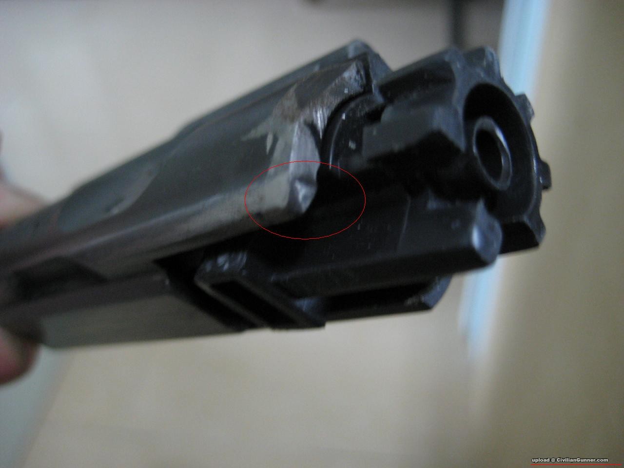

作者: F22    時間: 6-4-2011 07:48
原帖由 red_ant_tony 於 6-4-2011 07:25 發表
Thanks for your comments. This is surely a good solution.
Anybody got a good way to deal with the wearing out of the bolt locking area on the carrier?
I have been filing the part whenever it g ...
我啲英文都係半桶水,唔係好明你指邊度.........
可以指邊度有問題嘛?
圖片附件: IMG_3436.JPG (6-4-2011 07:48, 48.24 KB) / 該附件被下載次數 243
http://wargamehk.com/cgf/attachment.php?aid=129128
圖片附件: IMG_3439.JPG (6-4-2011 07:48, 28.93 KB) / 該附件被下載次數 257
http://wargamehk.com/cgf/attachment.php?aid=129129
作者: nok7689    時間: 6-4-2011 08:29     標題: 回覆 15# 的帖子
已經用原裝試...估計係BOLT低磨左條坑出黎..連發時BOLT低因為有條坑係到頂唔返個擊鎚個扣去前面
所以個扣仲扣住左
作者: F22    時間: 6-4-2011 09:20

作者: nok7689    時間: 6-4-2011 09:39
其實撥去連發....扣實板機...再係隻匣位望入去..佢推出氣個舊野有無出黎得唔得...
岩岩睇左...單發個時佢推曬出黎..連發推得一半...咁可以點搞搞佢~

作者: red_ant_tony    時間: 6-4-2011 20:45     標題: 回覆 16# 的帖子
Sorry my fault. I could only type in English......
I mean the position of the screw on picture 2.....
Did you put your own screw in or it is the one by Iron airsoft....?
Mine is a prime bolt carrier.....and they don't have screws.
作者: F22    時間: 7-4-2011 07:40
原帖由 red_ant_tony 於 6-4-2011 20:45 發表
Mine is a prime bolt carrie ...
嘩,乜你咁好眼睇得出係416條bolt? 粒螺絲冇錯係我自己上.......
咁你條prime bolt係鋁定鋼呢?可以燒焊救番喎........
作者: red_ant_tony    時間: 7-4-2011 21:17
I guess only bolt carriers made by iron airsoft have screws on them.....that includes 416 / Adams arms / POF bolt carriers.
I have both steel and aluminium bolts made by Prime. They all have the same problem after using for a while......
How do you drill such a small hole over that area??
