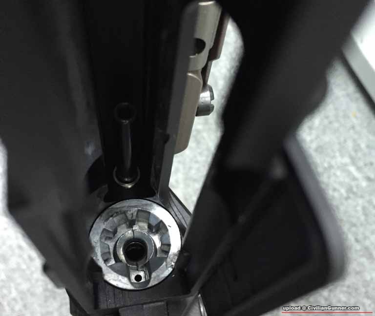

I recently purchased a Brand new Umarex HK416 10.5 GBB ( 2015 version) in late October. I took my gun out for an inspection and upgrade and I was told that my hop-up unit is incorrect, and it is not 2015 version. I am hoping chings can please clarify or confirm with me. I took a photo of my hop-up unit.
Can someone confirm with me, if I have a old hop-up unit?

小弟材疏學淺,但咁岩又有一支2015版,發現師兄你呢支真係唔多對路...
起碼2015版嘅5.1HOP-UP膠係外露膠皮
我有3枝2015版都唔係咁樣既
係邊到入先?不如返去問問
槍身selector 上面編號睇到年份version.

ching the serial says : 88-150400
Is that 2015 version?

係呀,15 即2015 version...

Thanks ching.... so that means the 416 that I purchased should have the new type of Hop-up instead of what I actually ended up getting?
So something must be wrong.

新版是5.1 手槍膠,舊版是aeg 膠,拆開睇清楚D...
睇樓主幅相,似2014VER 多D.....
但serial no顯示真係2015 version喎,樓主喺邊間買架?

ching do you have a photo of 2015 version?
But I purchased recently and also requested for 2015 ver.

我諗你拆出黎睇清楚粒HOPUP膠好D啦....咁就一目了然!!!!
正如其他CHING講,2015 VER應該係5.1HOPUP膠
