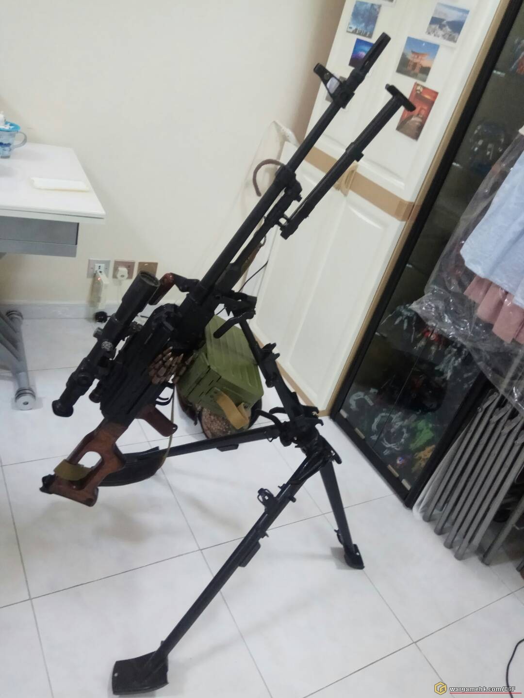

最近加裝了TWI的側橋和換了真品feed tray

WOW!C Hing支PKM裝上腳架和加左支鏡,威猛好多. Thx for sharing.
