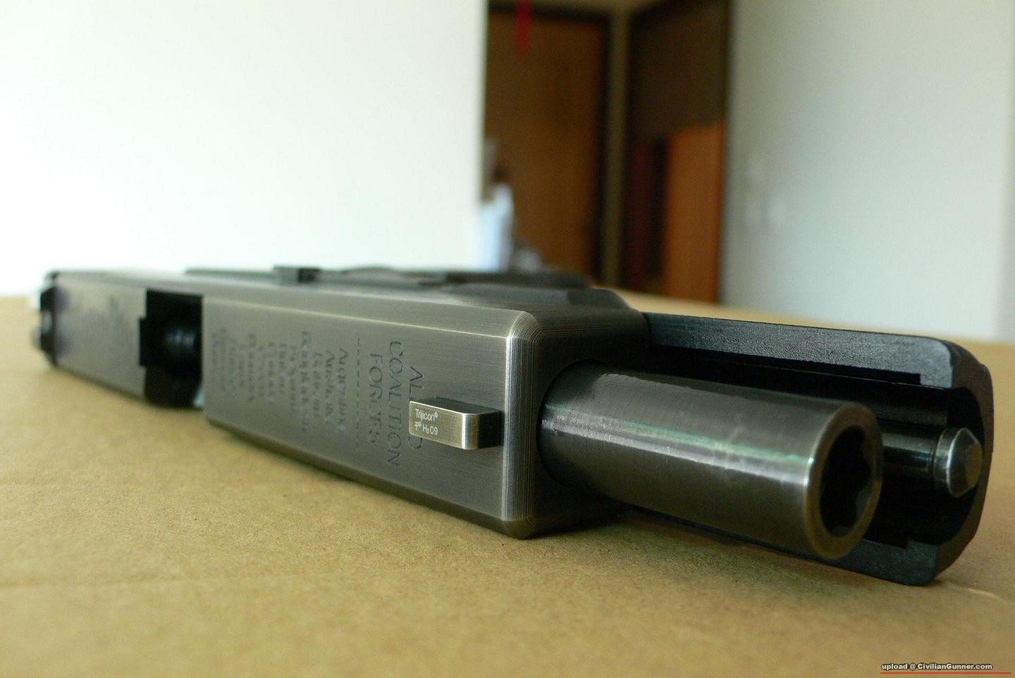

小弟剛買了沙漠風暴Slide 亦小改動下換到Marui G17 Custom上, 但發覺問題來了, 打了一發後不能回膛, Slide 死死卡左後方不能回前, 請高人相助

唔可以強行再拉後?
09" Giant TCR2
聽說Marui G17原裝frame 做肥左, so 加左吉打slide(副廠slide)會唔 fit
唯一在短時間解決這問題, 就是買一個吉打frame 不用煩

係. 仲有, 唔係下身唔fit.....係條slide厚左所以飛机座降低左頂左hammer.......
鋼slide一來斷左貨, 二來貴鋁slide 一倍以上, 所以我唔想亂搞搞瓜條slide

You may try to sand the "frame" of the aeroplane (the one inside the slide) until it cycles smoothly.  You need to sand mainly the center area, particular the area where it has 突出.
Personally i dont think the Guarder version is good at all since the dimensions are not too correct.
