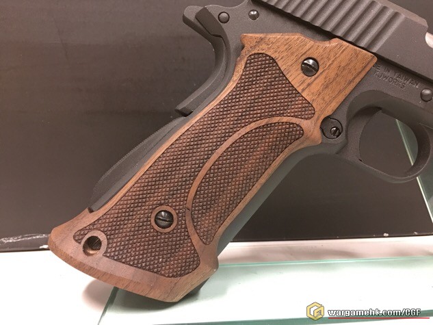

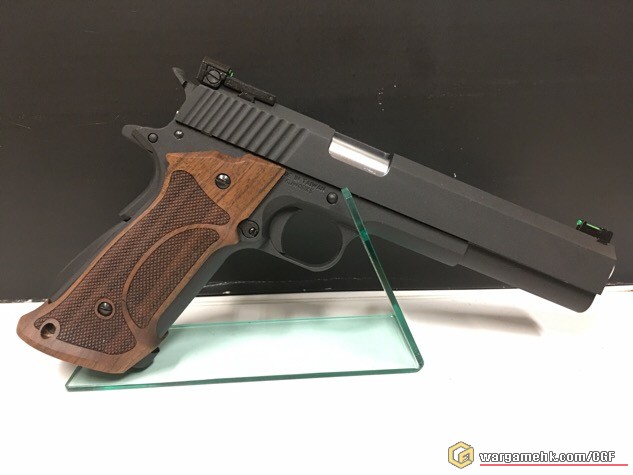

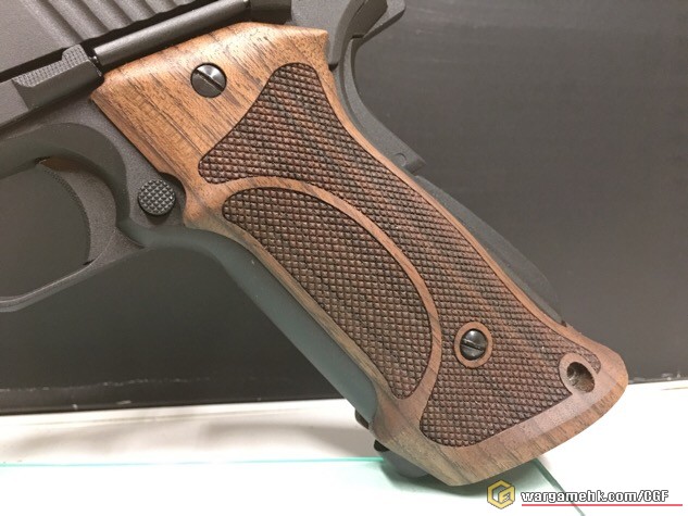

新Custom made pistol, 滑架為KJ Works KP-06, 為了襯托木握把,下身用了KJ Works 1911,木握把為土耳其KSD grips 出品,屬真槍1911使用,所以用在玩具上需有一定程度改位,填補及做色,最後少不了用Tru oil作保護

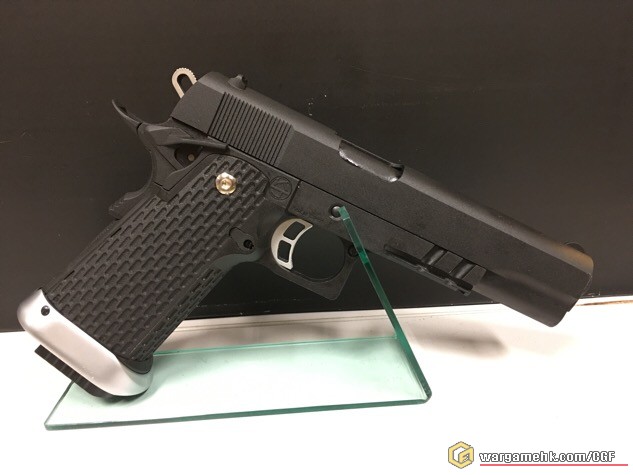

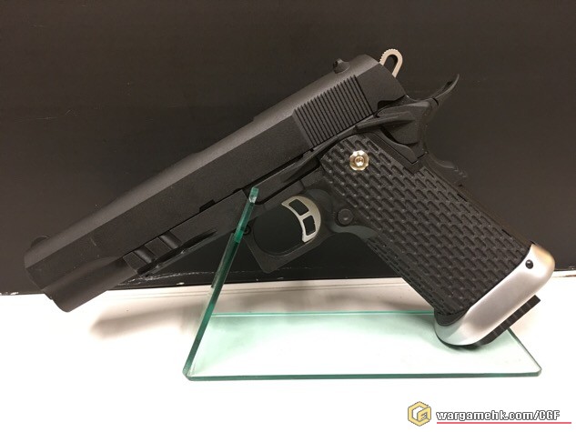

既然上一支custom made pistol 用了KJ Works 的KP-06滑套及KJ 1911的下身,那淨下的零件怎麼辦?當然不要浪費,二合為一,但因KP-06的中身太長,為配合1911的滑套,改短了KP-06中身,打磨後再用Gun Bule 染色,一支特色的1911 Hi capa生出來了

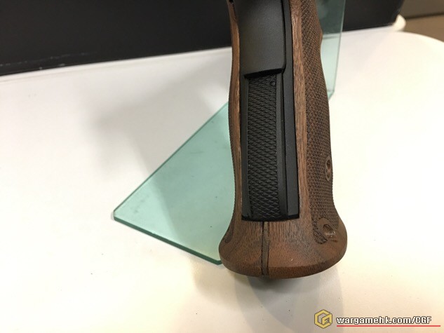

Jacko san, may you show the bottom of the wooden grip as well?
遲啲先得,支槍唔喺手

I am not sure how is it worked, like a mag well or any compatibility issues with different mags from different brands.

Btw,枝 06-1911 (06 上+1911 下)睇下就得,打真係唔掂,事關上身擔野實在太笨重,反而 1911-06 (1911 上+06 下)就絕對無問題
所以我打Co2匣

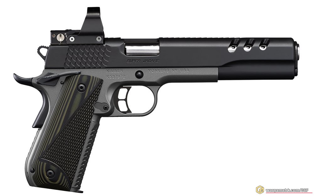

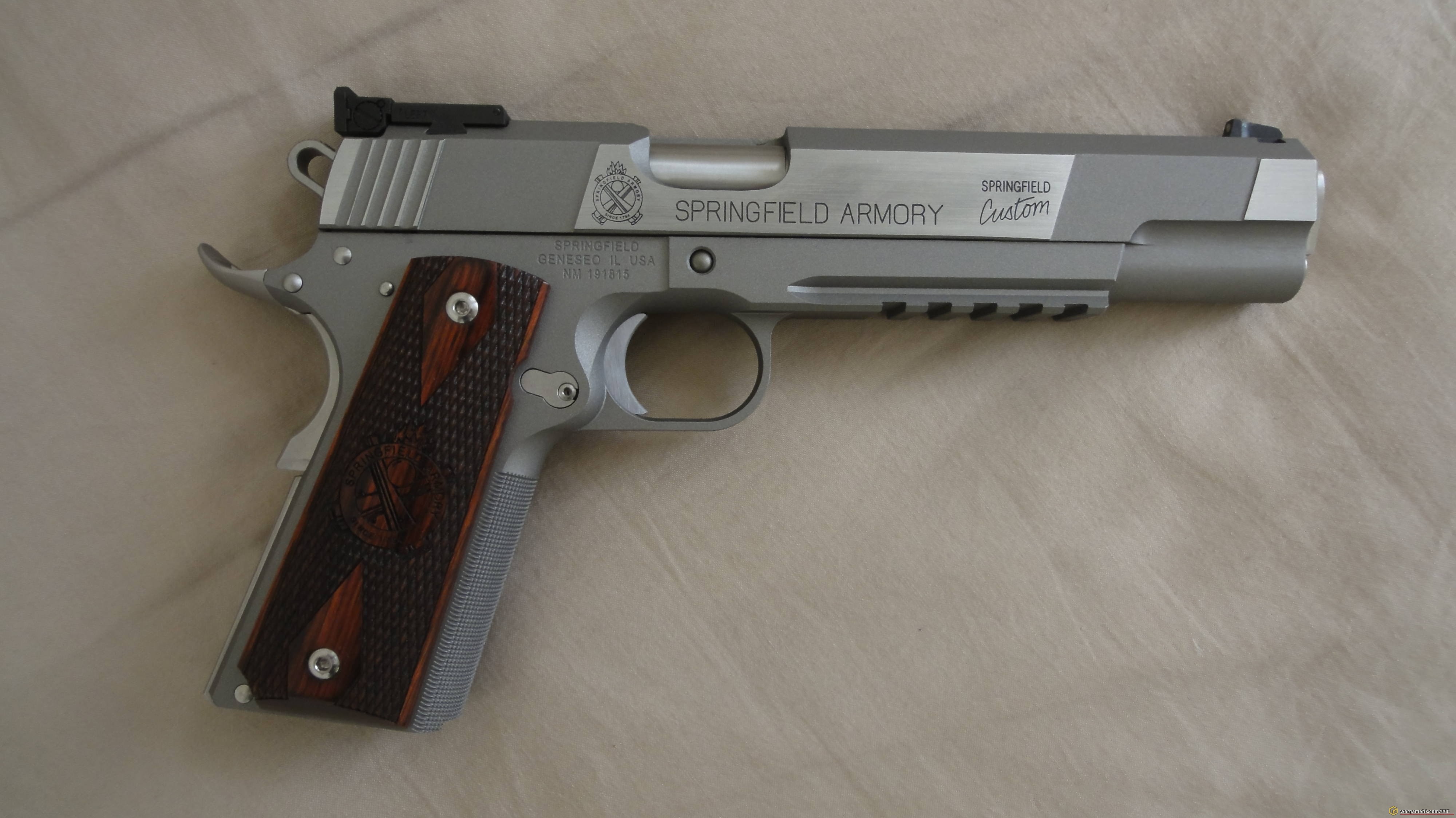

軍火熱有人將KP06改成6" Springfield Armory 1911
https://youtu.be/0yD-Kivsw18

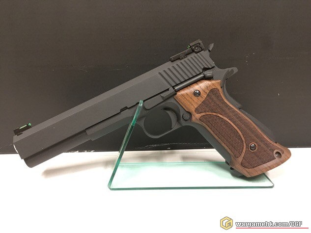

唔洗睇軍火酷,呢度都有放出嚟
http://www.wargamehk.com/cgf/vie ... &extra=page%3D1

其實我砌呢支嘅原因係我上年買左個KSD 1911 master grip,諗嚟諗去都諗唔到邊支槍襯到個grip,早排見yuihj兄改左支6” 1911,參考一下製作,yuihj兄支1911的確係正,但下身零件太貴,我窮 所以用KJ 1911下身算數,我又唔識刻字,又唔識cerakote,一切用原裝加熱情搭夠

睇相清楚啲嘛∼ btw,佢試打出嚟同我呢支用gas匣效果差不多,KP-06 slide真係太重,1911薄匣難推得到
