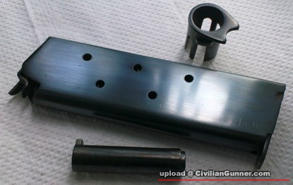

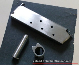

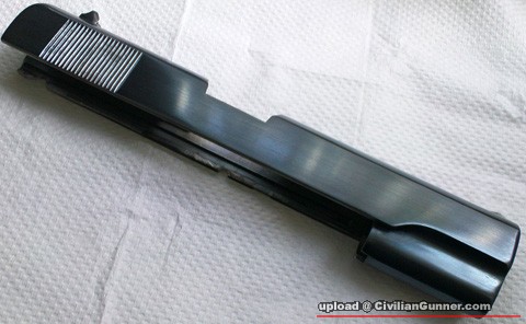

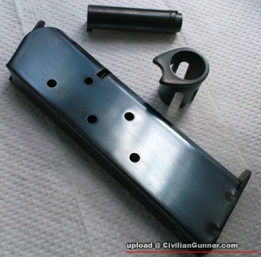

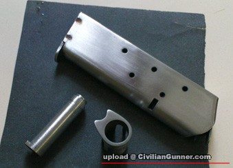

cap gun parts after bluing ( before & after ).
for your reference

i recommend (perma blue) is easy to handle for the beginners.
PROCEDURES:
                     1  sand out the original black coating to silver{as smooth as you can} by using sand papers
                     2  running water to clean and dry it by cloth
                     3  brush the bluing area(silver area) by brass brush and smooth it again
                     4  use brush to apply a layer of gun blue {must even}-note the effect will soon take place
                     5  running water and dry it by cloth and box tissue retouch
                     6  use brass brush to retouch slightly the bluing area (if necessary)
                     7  repeat steps 4 5 6
                     Good Luck and Cheers!!:-13
