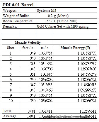

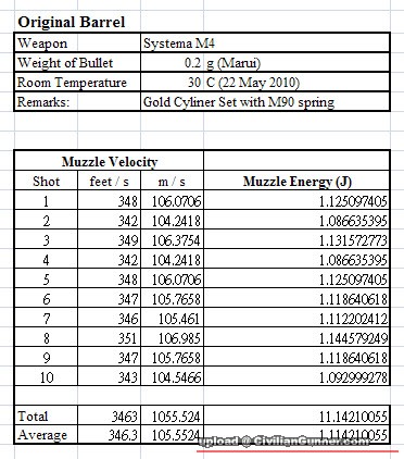

PTW 原裝管 VS PDI 6.01管 (標準M4長度)
All other parameters were kept constant.
[ 本帖最後由 CPK 於 9-3-2011 22:55 編輯 ]
9-3-2011 22:48
PDI 6.01
9-3-2011 22:48
M90力兩者分別不大呢...有冇其他彈弓表?
不過應該都係6.01會大力D
seems no big difference between the original and precision inner barrel in terms of "J".......
but i wonder how various of barrel length affects the "J"? did c hing do any experiment related to it???
thx for c hing's valuable sharing!!!

Sorry, I can't. I don't wanna disassemble the HOPUP and change to another barrel(s) again.

其實用左6.01除左會比原裝管 大力D外 咁會唔會集彈都好D?? THX

我都好想知道6.01管的grouping會否好些。

可能PTW原裝管已經好好。
