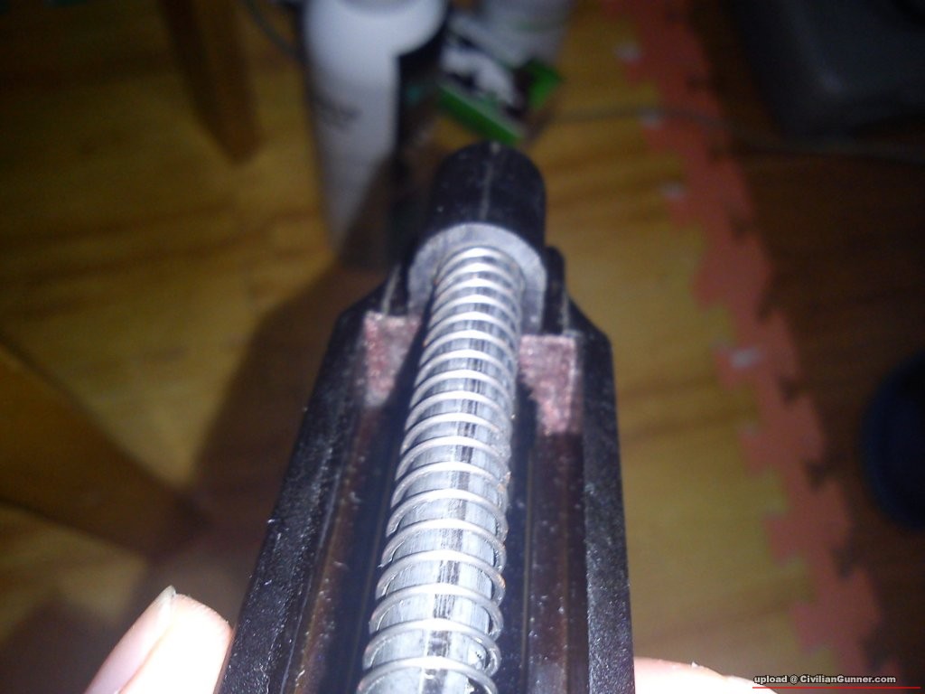

切左少少zip凳腳果D墊片, 入'top gas'就運作正常,
但係入下邊果支'green gas'就依然會獨槍lock.

zip左兩片墊住

考慮緊墊少少軟野係slide同金身之間等佢冇咁硬碰可能會有改善掛
