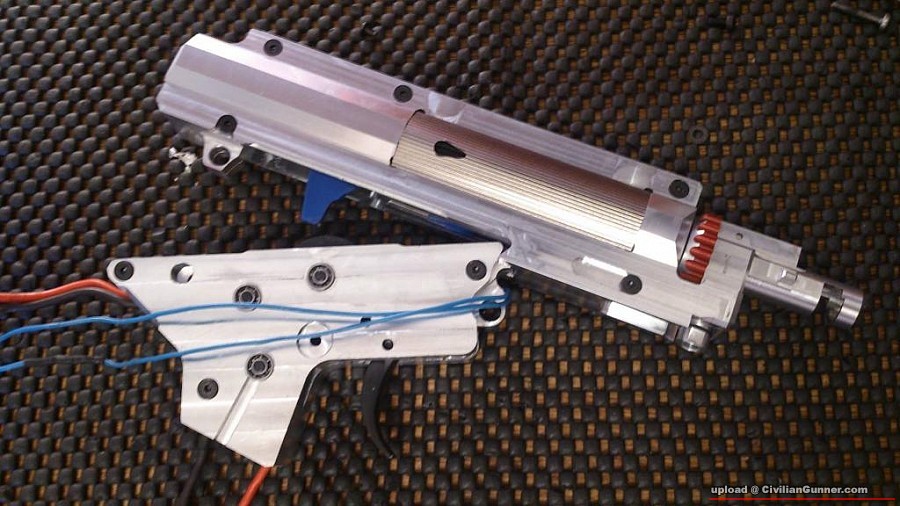

Gearbox Hop up 一体化
Gearbox Hop up 一体化
大家點睇?

I like the materials, CNC machining and one piece design but I have concern over the hop-up, I have experience that when a tight fit barrel and rubber is inserted, there maybe a chance the rubber folded, get out of place etc.  For P"X"C it separate and you are able to see inside but on your design it seems difficult to check out if the hop up is in place and alignment.  Secondary from the photo it is hard to see how you opened the upper part of the gear box because in my mind the hop-up must be in one piece for air tight and that means you have to find a place to separate it on the upper body.  Thirdly I believe this gearbox come with quick release spring guide but a design is not good and at the same time the materials that they use was not good which broken easily.  Hope your design work out good.
原帖由 失去靈魂騎兵師 於 16-5-2015 11:13 發表
Prowi_ 之前出同樣一体過
借圖一用!
效果如何?比普通的有較好表現嗎?

設計上遮住左推彈咀個位,就咁好難睇舊hop up膠有冇裝得好

原帖由 wing383 於 16-5-2015 11:48 發表
效果如何?比普通的有較好表現嗎?
密氣少少(我無數據)五六年前既事.

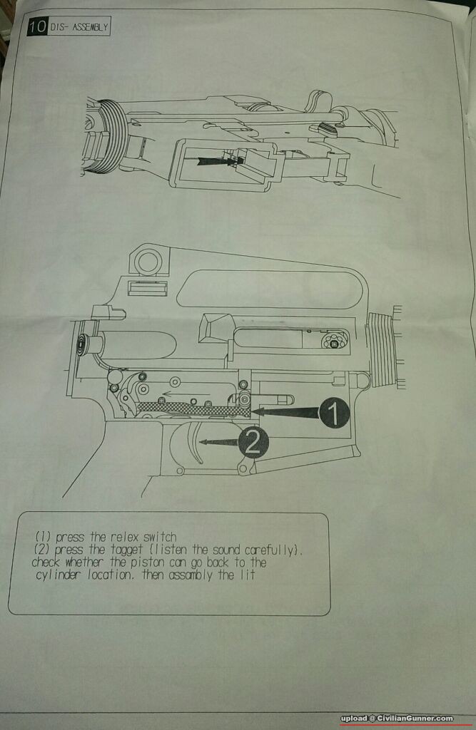

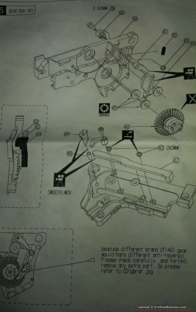

上左上面網址睇過下,果隻波箱和Proxxn有分别調節Hopup位像次世代果隻,下身都有分別Proxxn有粒掣用來放牙才可以柝開上下身(可能我記錯都有可能)新果件吾多見有最後因冇見到安電片位的圖片所以吾清楚。但吾會係亞洲人做因為有D吾像英文的文字同都吾平價當好像賣$180係usd都$1200-1300,歐元重貴好多。
原帖由 當時物 於 16-5-2015 19:53 發表
上左上面網址睇過下,果隻波箱和Proxxn有分别調節Hopup位像次世代果隻,下身都有分別Proxxn有粒掣用來放牙才可以柝開上下身(可能我記錯都有可能)新果件吾多見有最後因冇見到安電片位的圖片所以吾清楚。但吾會係 ...
Pro記可以釋放彈弓
