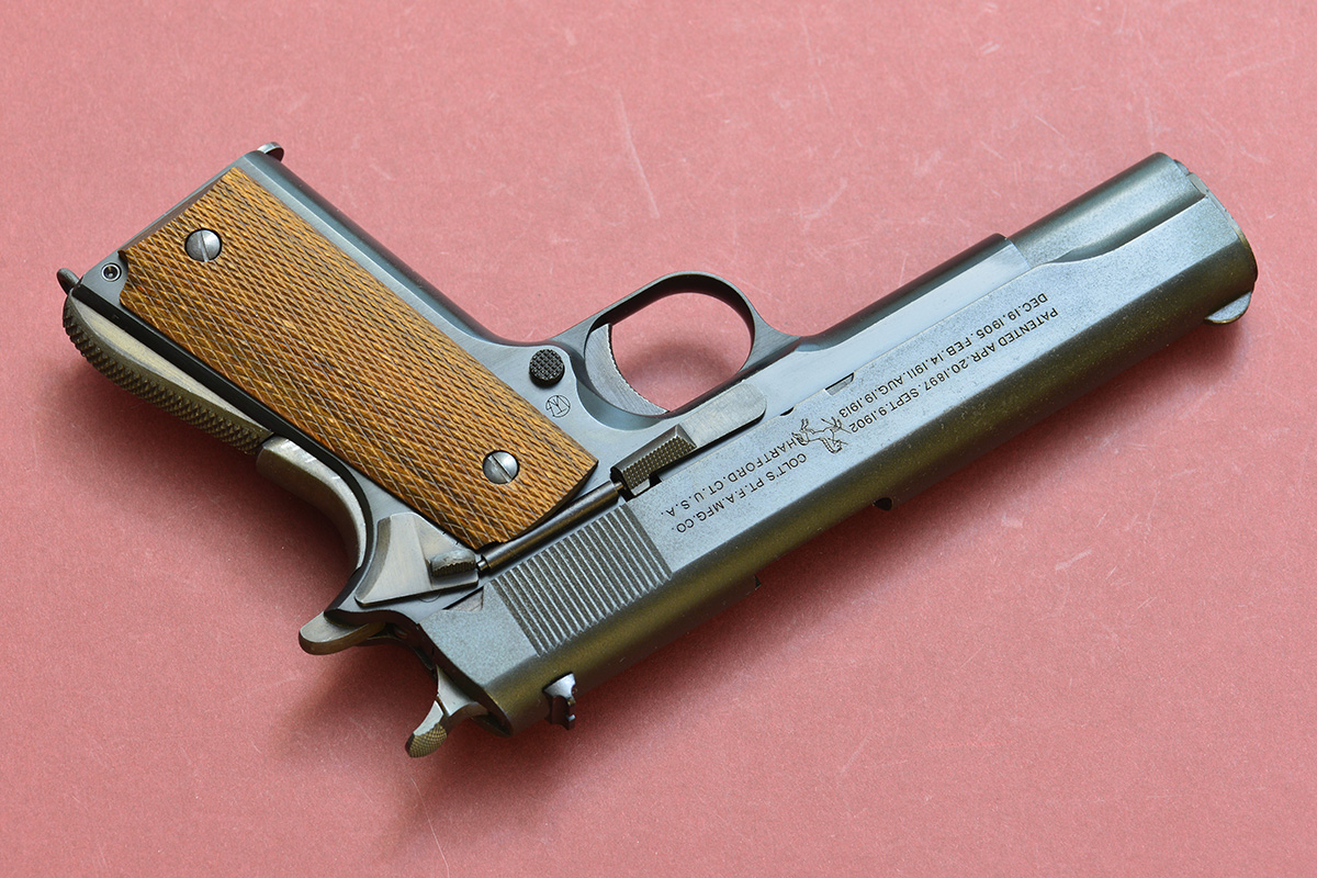

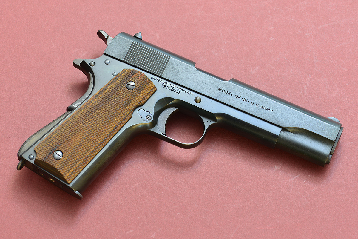

COLT M1911A1 SN.700001 The First 1911 to 1911A1 Transition Model
http://www.coltautos.com/1911a1ci_700001.htm
Colt Model 1911A1 Transition Model Serial Number 700001 - On June 12, 1923, Colt's was awarded the contract to manufacture 10,000 "Improved Automatic Pistols" to include the modifications that were approved on April 20, 1923.  These pistols were numbered from serial number 700001 to 710000.  This is the first of the 10,000 transition models.

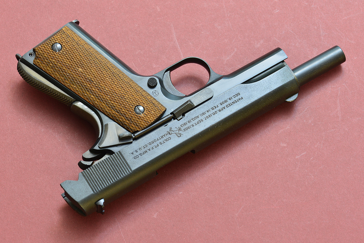

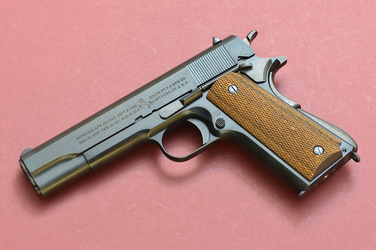

M1911過渡至M1911A1型
實槍生產10000支,序號700001到710000。

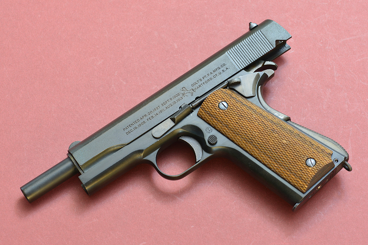

以 KSC M1911A1 為素體
仿實槍外觀製作

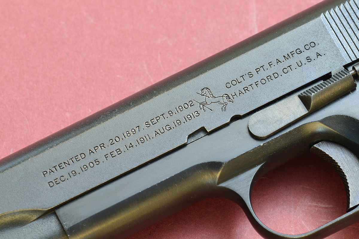

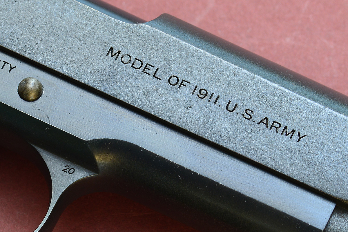

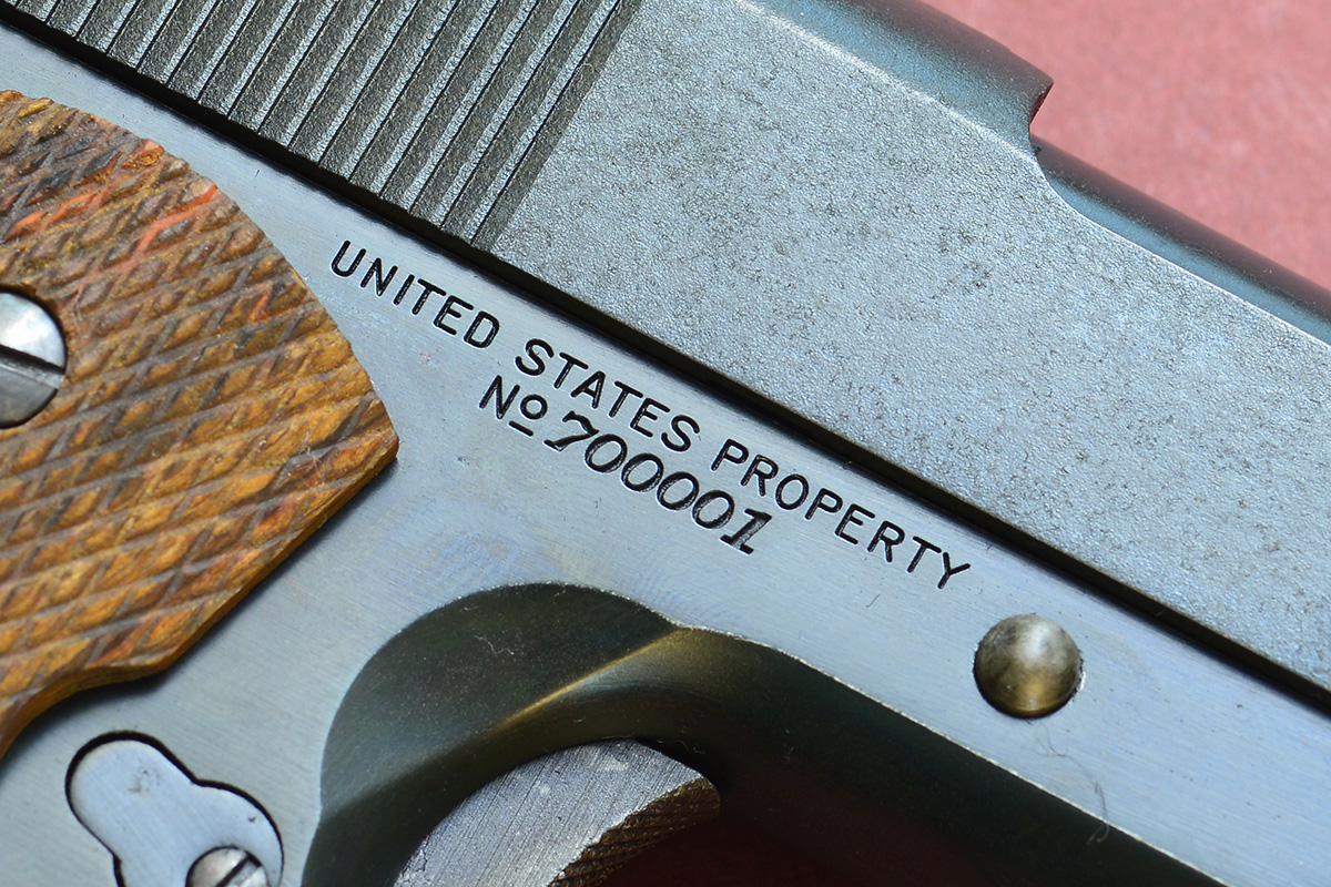

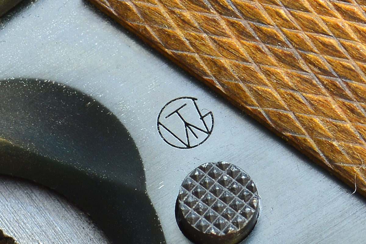

仿實槍刻字,雕刻深度0.3mm深

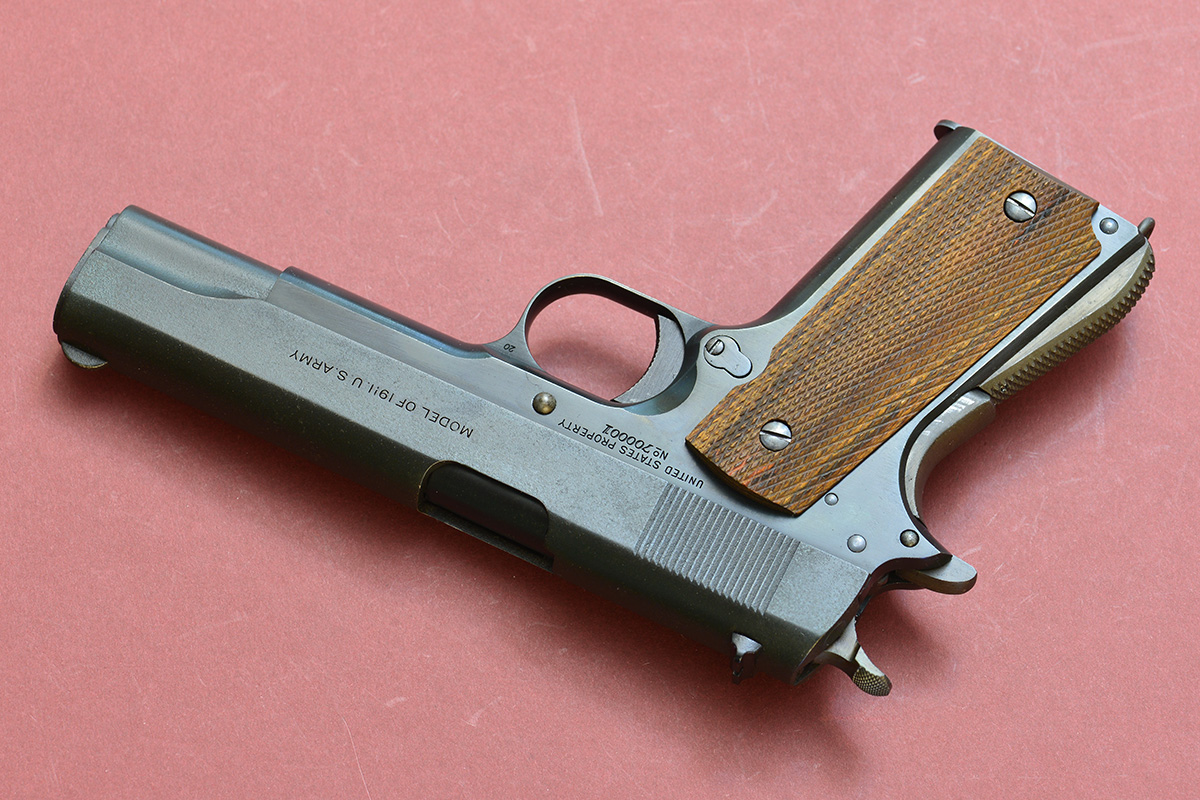

序號 700001 式樣
第一支式樣

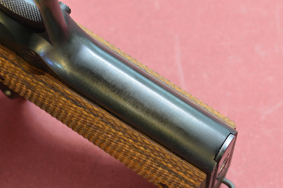

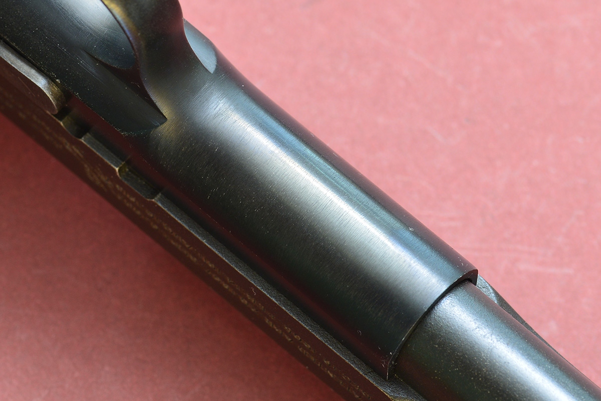

修改如下:

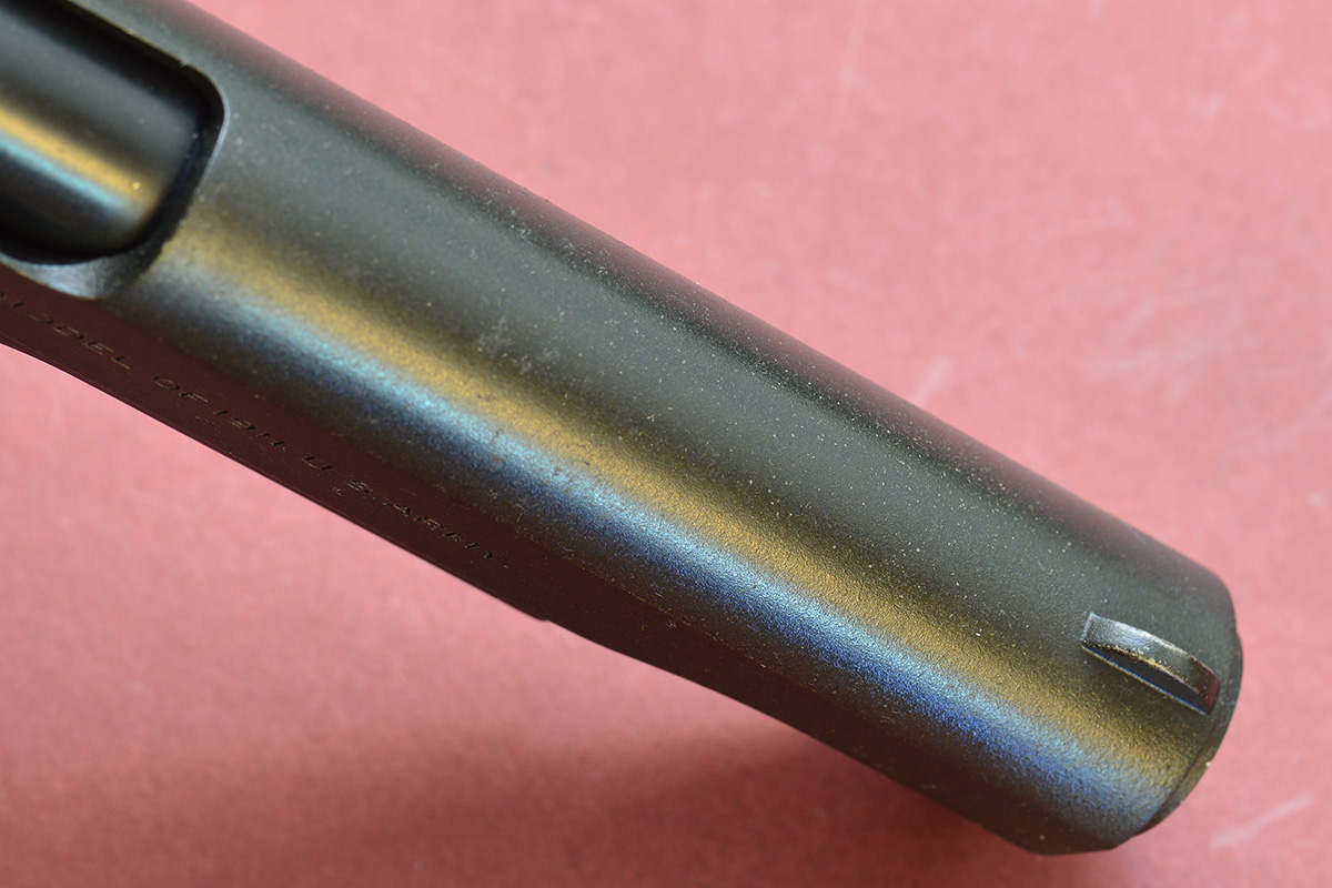

1.全槍噴砂處理
2.全槍分模線去除
3.仿實槍刻字,雕刻深度0.3mm深
4.手工黑染處理
5.修正下槍身後端線條
6.修正握把保險線條

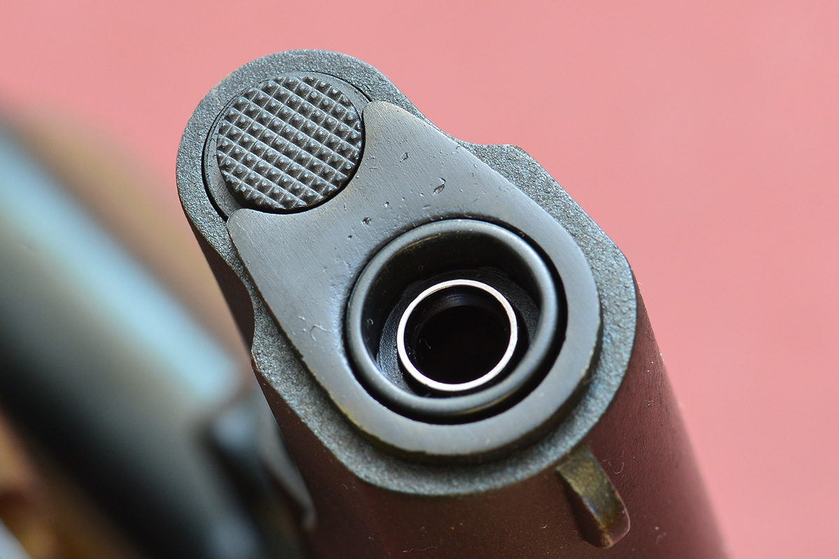

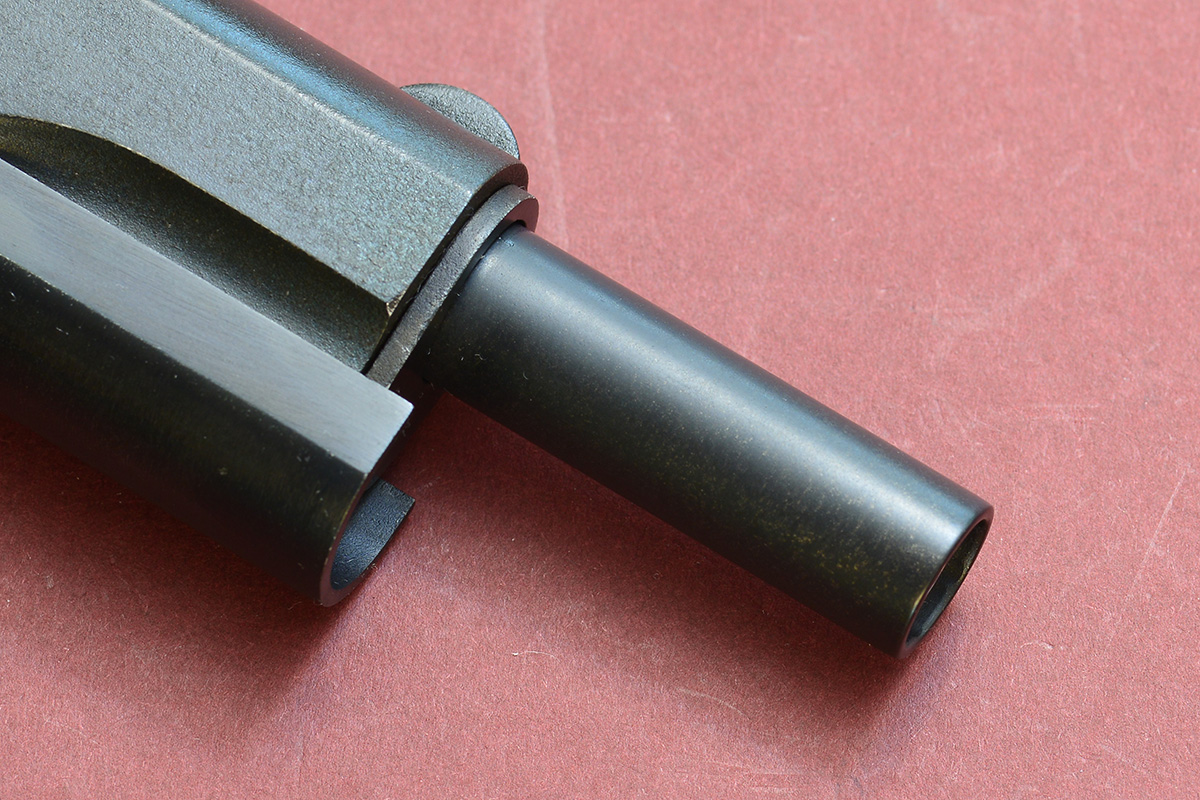

7.修正拋殼口R角
8.修正槍口R角
9.金屬外槍管

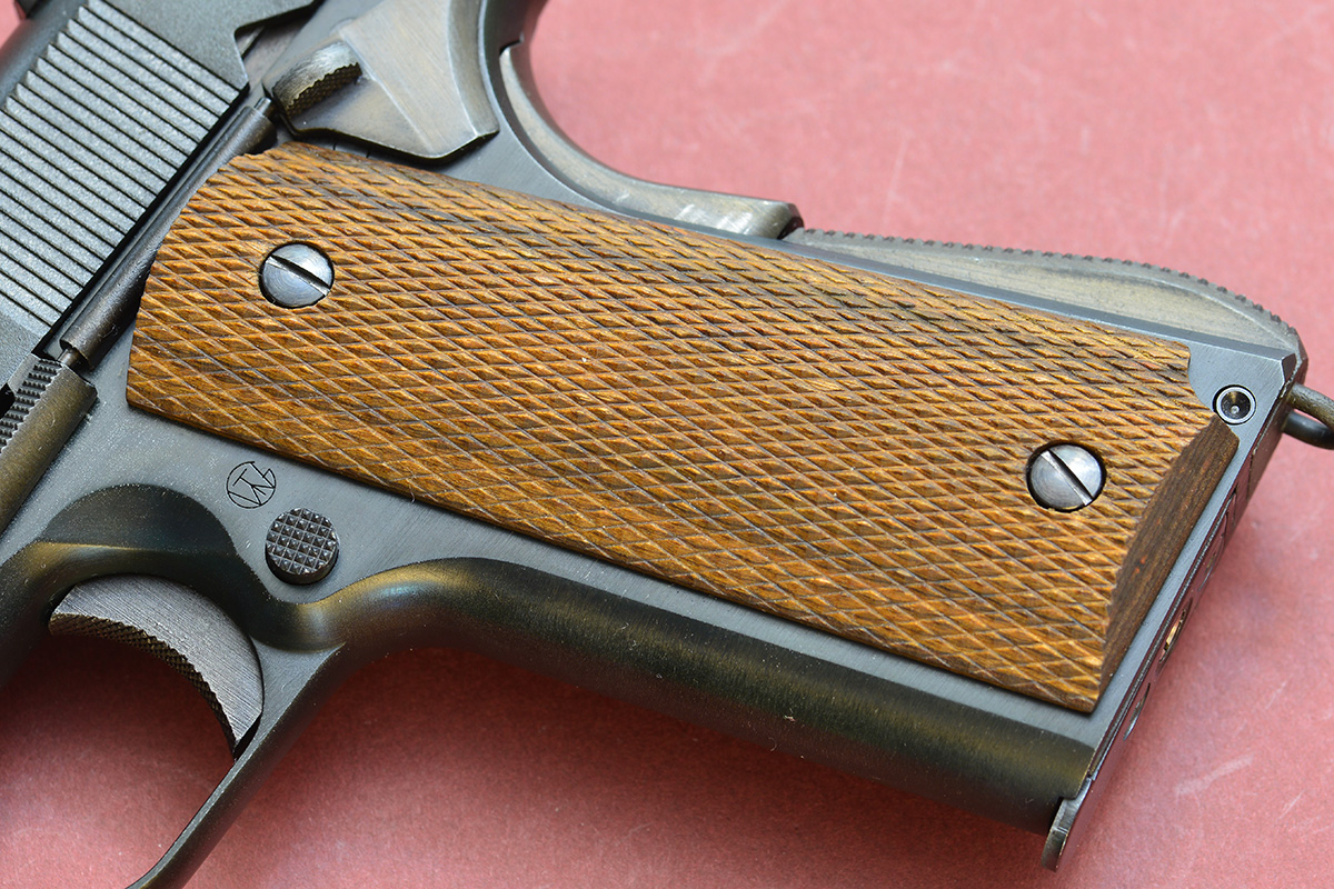

10.木製握把片
玩具槍 & 實槍
玩具槍 & 實槍
玩具槍 & 實槍
玩具槍 & 實槍

蘇兄您好,滑套及鋁鎂槍管,不好染。
