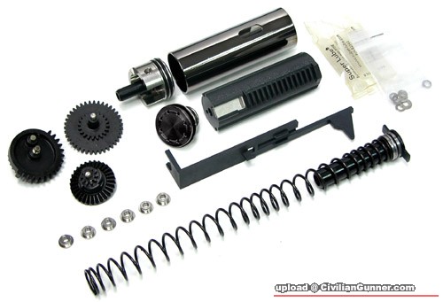

AKS74U 氣缸請問應該用AK47缸 還是AK-Beta缸 ?
看中了吉打 Full Tune-up Kit - SP120
想問會唔會穿底中呀?我想打兩面.
要唔要買Spring( PDI 150% )
謝謝

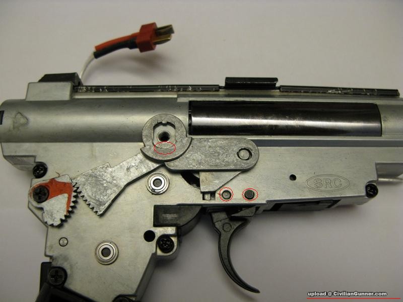

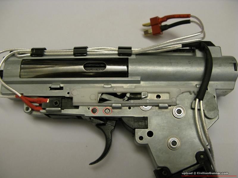

Problem in installation. Please see and help.
http://www.civiliangunner.com/cg ... &extra=page%3D1
Thanks
beta缸
兩面用m100/150%
攝介子唔好攝死, 吉打杯士厚身d...

Only use total 6 介子 , no more use la. Still not know why ar ?
Sales said PDI 150% = bottom middle la.

介子係睇情況用, 唔係事必要用...你上左杯士就咁放d齒入去合埋box上幾口鏍絲試下轉得好唔好...太鬆/唔岩位先比介子

Really ? Let me try
多謝神秘師兄幫忙組裝,學到點樣Set介子啦
最後一不做,二不休,換咗 SRC 8mm Bearing 波箱 ( 外部小
