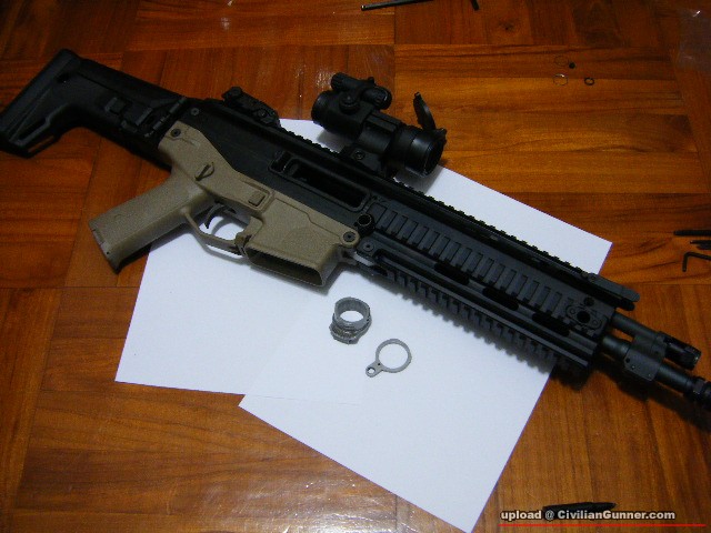

Basically, it is the same procedure that one would go through to replace the hop-up chamber on the weapon. eHobbyAsia did a great video of the unit.
In my case, assembly took about ten minutes with all the right tools.
Initial Impressions
My god is it beautiful! It assembled fairly easily, and the polymer used on the lower matched the stock polymers on the stock and hand guard fairly well.
Trigger was crisp and boy did it sound good to finally have to rack a weapon. The selector felt good to the hand, with solid clicks into Safe, Semi, and Fully-Automatic. Just like the real-steel, you can only put it on safe if you have the hammer cocked.
It used the stock pins, so no need to modify the actual body, it looked to be almost drop-in.

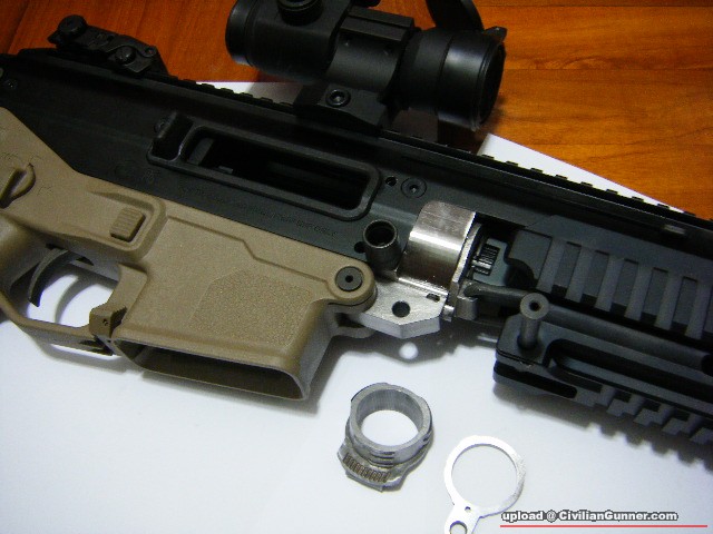

As soon as I started delving into the actual GBB kit, I started to notice wear VERY quickly on many key areas.
Bolt carrier group
Stock Nozzle
Bolt Catch
Hammer
The issues I have had and their fixes (if I could figure one out)
-The bolt carrier is not locking to the rear on empty with all the magazines. The bolt carrier is wearing at the locking point prematurely, causing a cascadingly worse problem.
FIX: I bent up the magazine bolt catch levers. It seems to be working, but the damage was done to the bolt carrier. It now has rounded front edges from the "almost catches." I have since took a Dremel and tried to flatten it out. It has helped, but it is NOT a long term solution.
-The stock nozzle is not "hard enough" to remove BBs from the Beta Project magazines reliably. The BB extractor has bent and no longer reliably strips bbs. Instead of being the square shape, it is now rounded.
FIX: The RA-Tech Hard Polycarbonate Nozzle is so far working well. Cheaper nozzles WILL NOT hold up to use (by use I mean as low as 100 shots). You MUST use a hard polycarb.
Side Note*** The Aluminum nozzle WILL NOT work either. It is a perfect fit, but it damages the nozzle holder pin on the receiver side since the holder is pot metal.
-Often, the BBs will "mis-chamber" by not entering the actual barrel, instead locking in place below it.
NO FIX: I cannot seem to figure out why this happens. It looks to stem from the hard metal feed lips on the magazines scratching the bbs.
-The Hop-Up does not have sufficient force to reliably hop BB. Even at the maximum setting only about 1 in 4 bbs will hop correctly.
FIX: The G&G AEG barrel chamber seems to be doing the trick. The problem is the consistent is utter ######, so your hop setting will be inconsistent.
-The Charging Handle catch has worn quickly and no longer holds the charging handle forward even when the bolt is locked to the rear.
FIX: You have to completely disassemble the charging handle assembly and you can dremel down the lever such that it will hold it forward.
-The hammer surface was not perpendicular to the bolt carrier (it is canted about five degrees), causing uneven wear on the bolt carrier.
NO FIX: This is a blatant assembly or design error.
-The rubber on the back of the bolt guide has cracked and is falling off, causing a "tink" sound on each bolt cycle.
NO FIX: No spare parts are available
-The front of the Bolt Carrier Guide Rod is breaking off, not holding the bolt on the rod when the weapon is disassembled. It is made of pot-metal.
NO FIX: No spare parts available.
-The Bolt Carrier has a lot of friction moving in the upper receiver
FIX: Dremel down the spacers in each of the four corners

Pictures of some issues are below.
