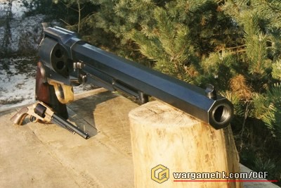

原帖由 screwupman2022 於 2018-10-8 21:47 發表
燒black powder?
前置BB
輕手一點  有這枝:
The .600 Nitro Express Zeliska Revolver is a single-action revolver from Pfiefer Firearms in Austria. The handgun can fire a 900 grain slug at 1,950 ft/s, making over 7,500 ft/lbs of muzzle energy. According to Wikipedia, the handgun costs about $17,000 and each .600 Nitro Express round costs $40, making this far and above more expensive than even the .50 BMG.

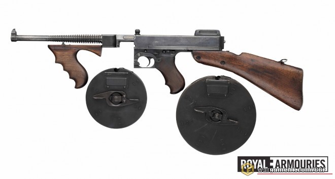

原帖由 olw0978 於 2018-10-14 08:50 發表
It would be rather heavy when fully loaded, but it may be too light when empty.  Seems difficult to balance......? ~?
當年 Thompson 100飛 drum 仲出事
