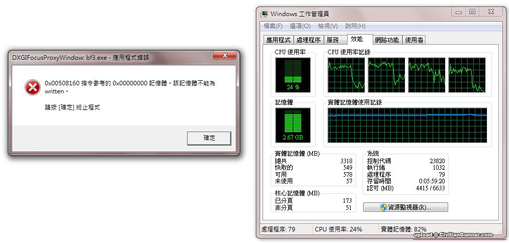

The instruction at 0x00508160 referenced memory at 0x0000000000. The memory could not be written.
解決方法:
暫無

轉玩mw3囉
彈game果陣,ram用量並無特別增多,係咪即係話應該唔關ram事?
9-11-2011 16:28
原帖由 p7009212 於 11-11-2011 00:08 發表
how many ram u got ching?
btw, anyone know how to solve "server disconnected" problem?
4GB
32bit win7(即係得3.幾)
原帖由 p7009212 於 12-11-2011 12:06 發表
then, seems to be not enough ram, can CHing buy one more ram? since 4 GB in Win7(32) seems is "just" enough to run
Win7(32)都唔支援更多ram啦...
