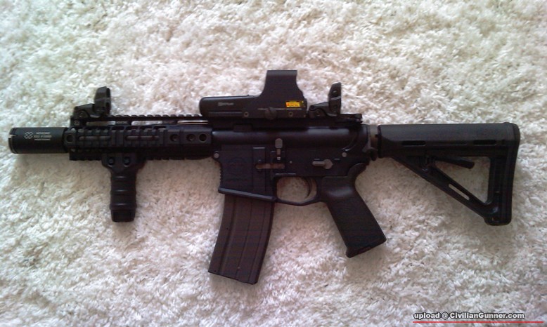

Finally got my new toy!
[ 本帖最後由 jcahmaens 於 7-6-2009 15:10 編輯 ]
7-6-2009 15:10
原帖由 hermanht 於 7-6-2009 12:13 發表
啊! 你條骨and身是什麼牌子? 有沒有高低級or不到位?
It is Neveske RAS (Copy) with Prime Magpul body.... there is a bit of 高低級 at the contact point... still trying to fix it...
These are major stuff in my settings:
P牌 Magpul Body
P牌 Lower Receiver Kit
P牌 Hop up Chamber
P牌 Barrel Extension
RA Bolt
RA NPAS
GnP Nozzle
P牌 7.5" barrel
First Hop up plastic (purple)
GnP Aluminium Buffer
and
Magpul MOE grip
Magpul Moe stock
Magpul M-Bus (PTS)
