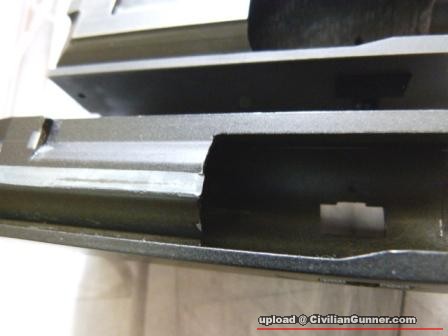

After replacing the Open bolt kit and played for 20-30 mags, suddenly i found there 嘔彈 constantly and the hopup is not working at all. That is when i saw the bolt carrier being deformed.
(Upper is RA tech steel bolt and lower is original WE) Using the finger touching the inside of the cylinder, it seems the cylinder shape has slightly deformed and causeing trouble to retracting of the 飛機.

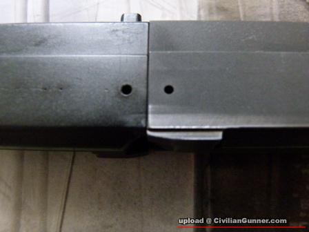

Also not satisfied with the high cycle of the open bolt, I go to get a steel bolt carrier to replace the original bolt carrier. Quite an expensive purchase actually, over 700 dollars.
However it is not without any problems. The 飛機 retention pin hole is slightly smaller than the pin itself (2mm vs 2.2mm). So i have to drill the hole a bit larger.
Also the size for holding the 飛機 retention grove is too small and cannot insert the plastic thing smoothly. So i have to file the plastic grove down a bit.
Finally for a 7xx dollar aftermarket part, I have no idea why they did not fully copy the original copy, and instead made this location so much shorter.
