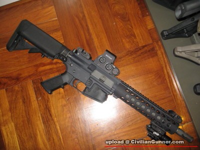

9" Troy TRX Extreme with CQBR lenght

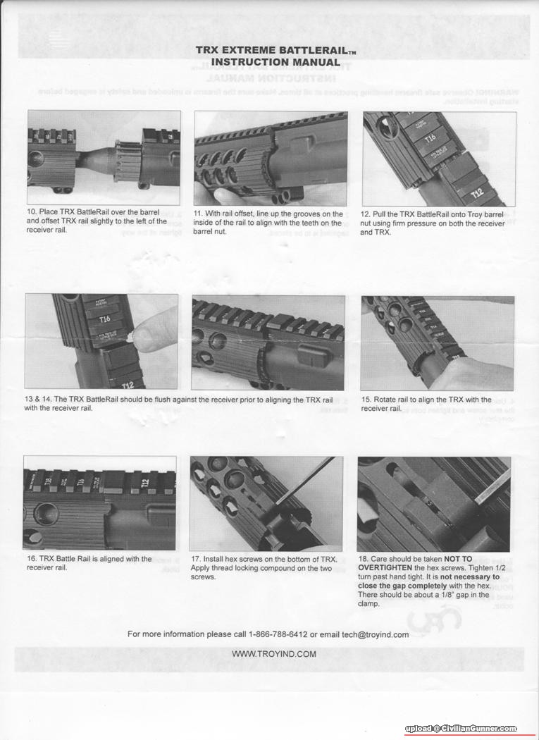

Very easy !! This is a real steel, come with a very good Troy trench to tight up the special barrel nut.  The barrel nut looks similar to the original delta ring but with sharper teeth.  Then the rail is designed to be push into this  (like Noveske) nut with the top rail at 11 o'clock.  Afterwards, just twist it to 12 o'clock and the top rail will be perfectly aligned with the upper

Here is the instruction
TRX 1.jpg.jpeg (128.94 KB)

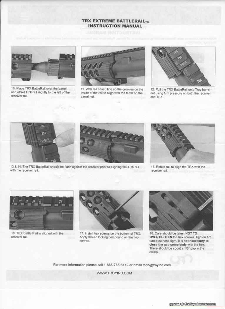

The instruction manual TRX 1.jpg.jpeg (128.94 KB)

Very good, go go go..... it is very light, well balanced, come with one 4 inch rail and two 2 inch rail.  I only install 2 short one, make it light and fast.  Perfect match with surefire X400.

yes, installing, perfect line up, show the picture later
