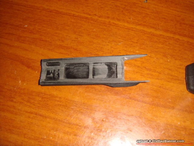

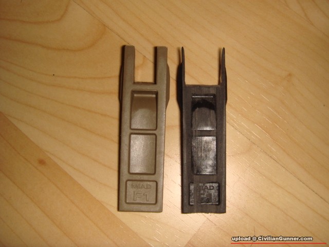

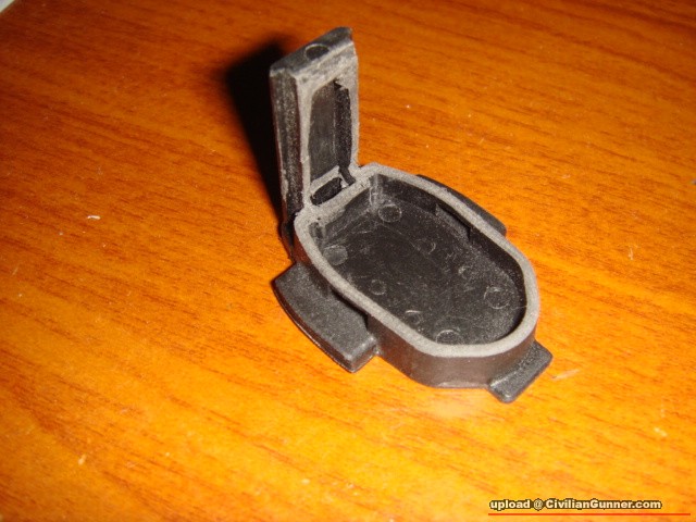

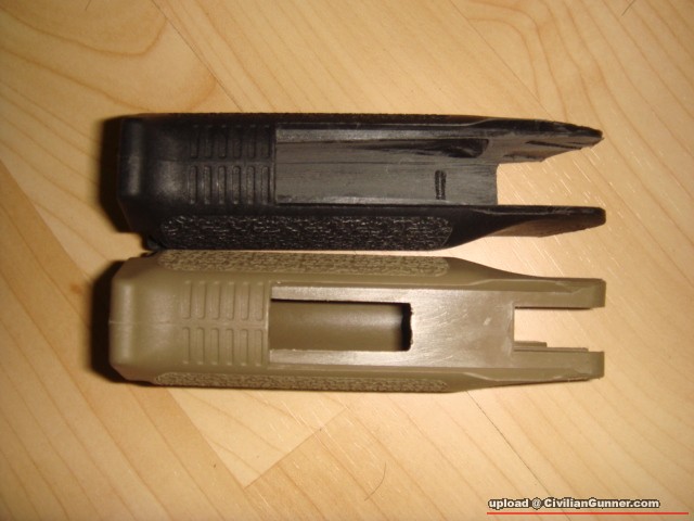

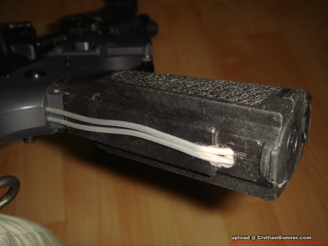

話說上回改完隻ERGO, 覺得唔夠實淨..
所以都係改返老本行.M記. 初呢報到既時候話過會補相, 今次終於可以實踐.
唔知係咪改過一次, 今次快手好多. 用左2 個鐘就搞掂.
講開又講M記D膠易挫好多好多..
OK..

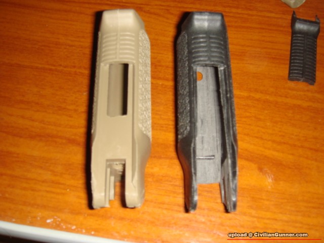

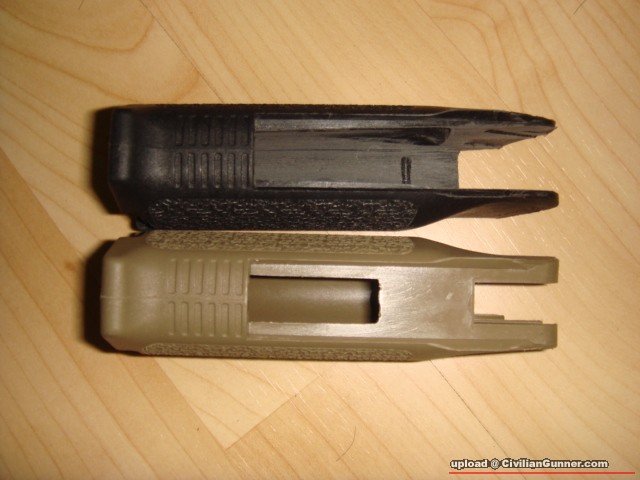

去片.
1. 要界走中間
2. 挫走個頂.
3. 完成應該係咁.
4. 然後要挫前GRIP 位.

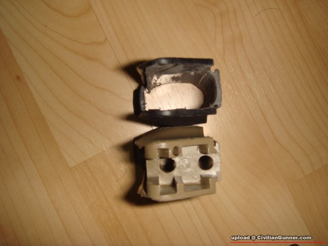

5. 最後CUT 個BASE.
6. 係GRIP 後, 開穿走線.

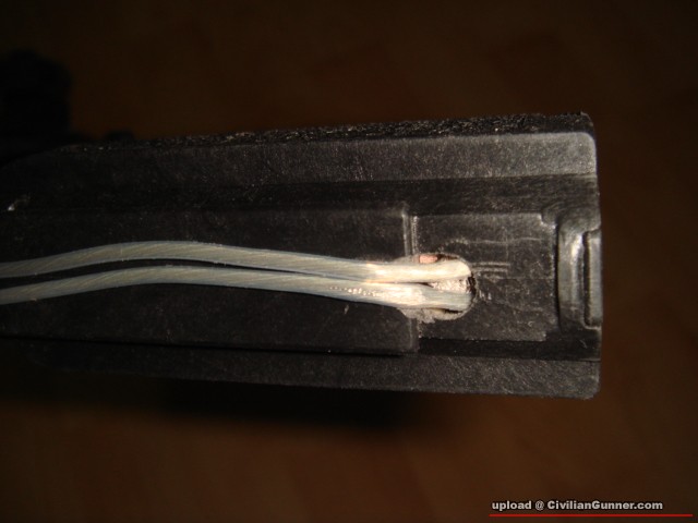

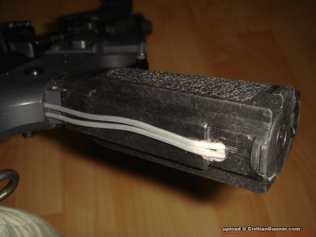

7. 搵機米度位, 鑽穿. 上鑼絲....搞掂..
希望今次既圖幫到大家..

其實挫前GRIP 位, 最好係上落隻GRIP 到挫, 咁就唔駛驚挫多左, OR 唔會挫爛.
反而覺得用MOE, 唔就位, 仲難挫..
excellent! even with a stock one for comparisons, thanks!
btw seems like u didn't use any screw to tide up the cap at the bottom. how did u manage to keep the grip in place? r u using a modified ptw plate to hold the grip?
原帖由 siupo 於 17-5-2011 19:52 發表
he drills 4 holes on the MIAD bottom plate, identical locations to the ones on the original plate and screw the 4 hex screws through the MIAD plate onto motor.

同意,今次真係改得仲好,不過走後出線真係難d清粉
