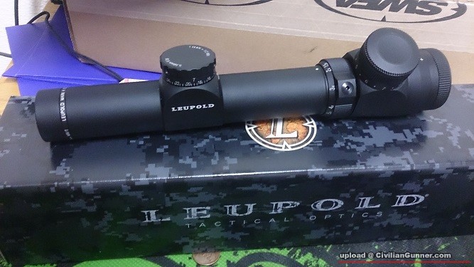

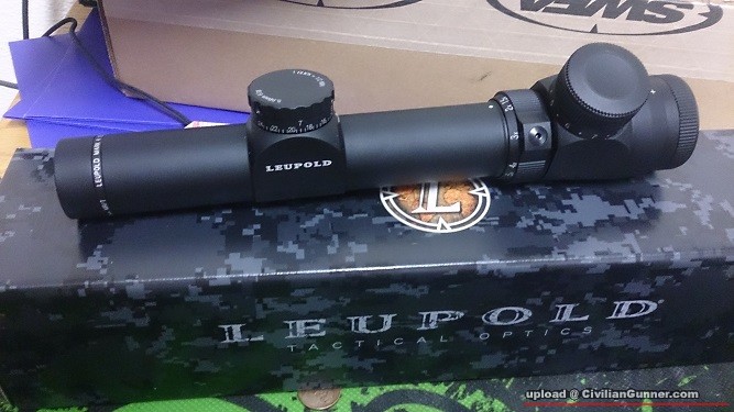

Still thinking for the mount......
Don't want to use the Leupold mount
Can anyone give me some ideas for the mount

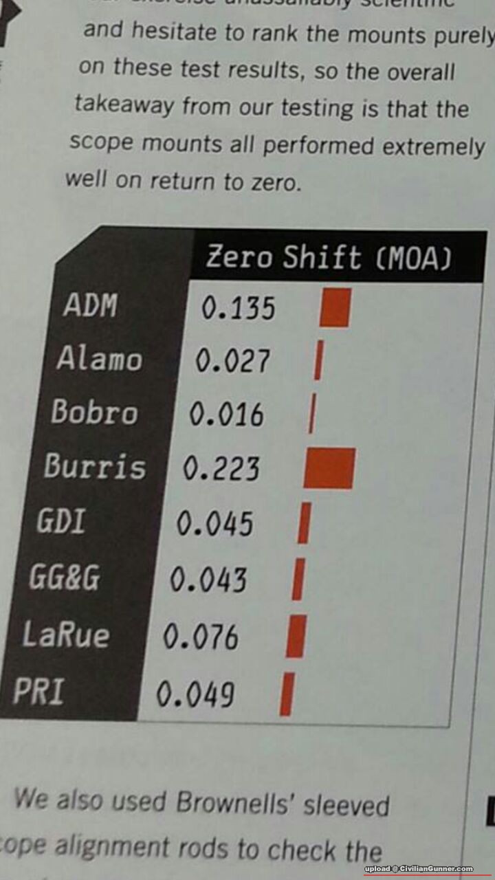

if you want to spend 200 USD, try this brand Bobro. i have it, it is the QD type. it returns zero everytime when i dismount and mount back on my Remy700 and AR10 precision rifle. it Built like a Tank. it highly recommend in US precision shooting community.
Nobody in Asia know that LaRue mount really suck big time. No one use it on their precision rifle or AR. The contact point of the LaRue mount is very minimum on the rail. it will shifts.
If anyone watch the Magpul video, the products crews behind the screen experienced LaRue mount shifted and off zero the whole day while filming. Rifle you can buy LaRue, Mount you should stay away.
ADM QD mount don't return to zero after you taken on and off.
Top shooting community in US use GDI, Spuhr, Seekin, Bobro, Badger.
make sure you mount on the correct in/lbs torque spec. Ring screw tq it down to 15-20 in/lbs. Mount screw on rail tq it down 45-50 in/lbs.

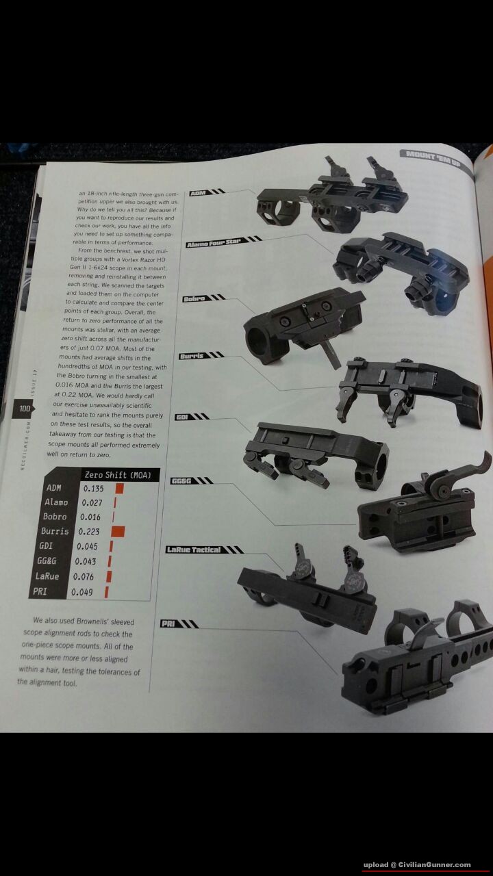

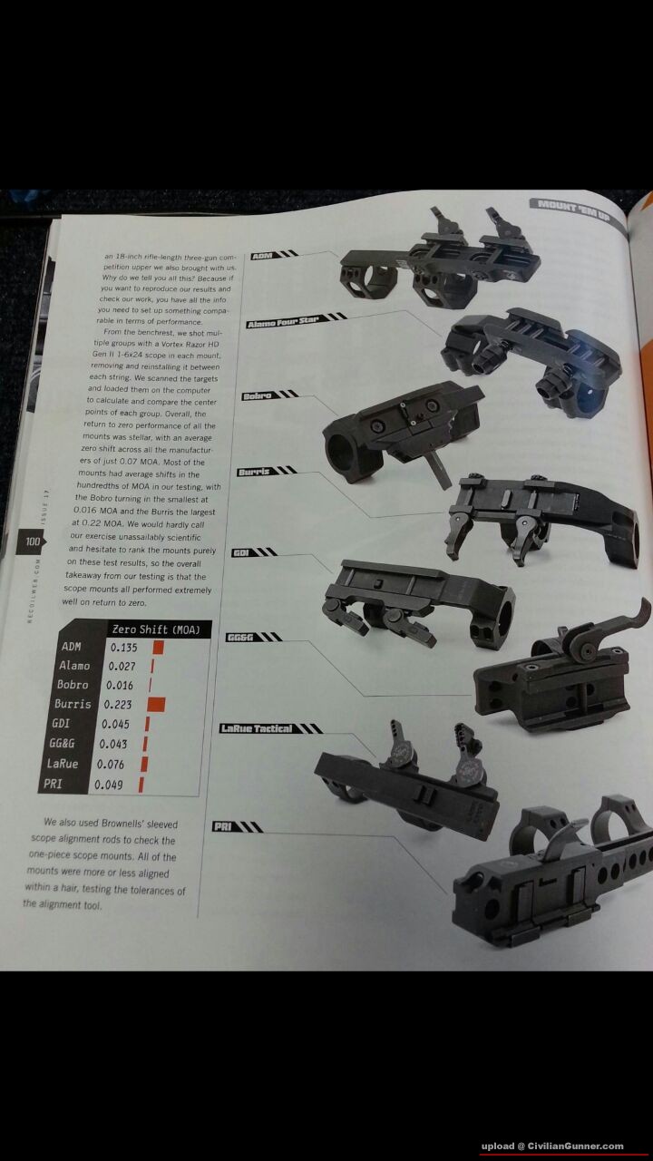

Check out Recoil magazines #17 issue
Battle of the mounts
wow 原來ADM 數據上o甘比下去
真係要睇多D
