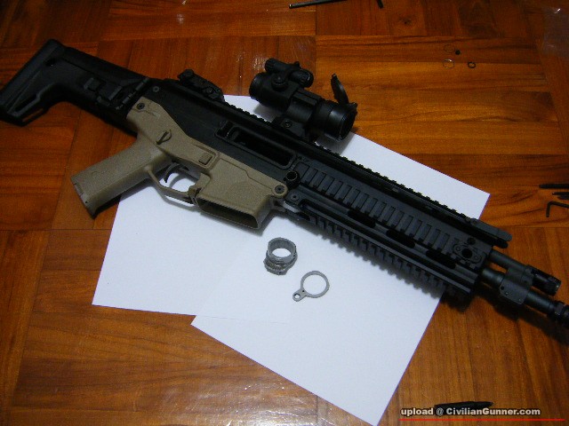

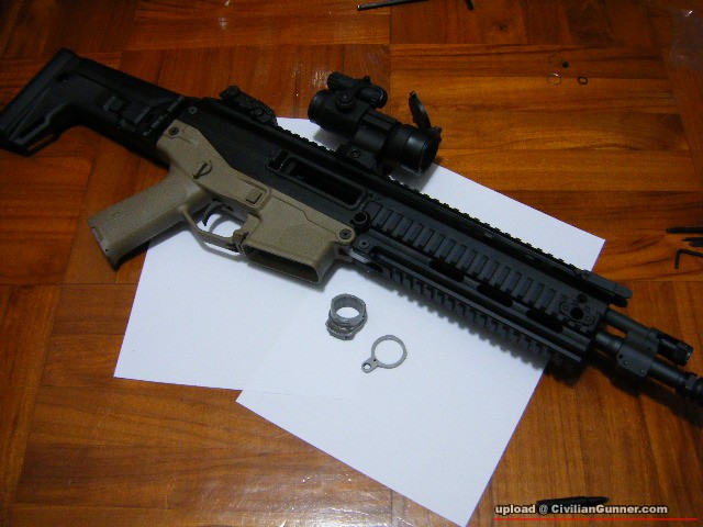

just completed my masada..... , 11.5 inch barrel , AKM upper,  pls advice which sight is better, and may be change the lower in black color,
i wonder if a AKM GBB kit for masada release .....just waiting
