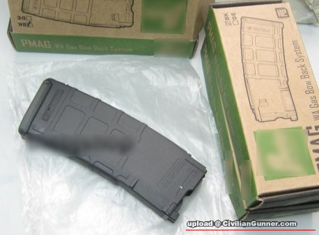

Beta P-mag for WA system GBB
之前係間離台見師兄話有款新P-mag WA system GBB匣賣。
滿心歡喜想去見下真身。
昨晚出去...見到幾間鎗鋪都有。
P-mag有BK, DE color, 仲見到有E-mag添!
不過...再睇下個膽......嘩!
Valve果條pin勁幻...而且成個內金屬比我覺得好粗糙...上面個導軌唔係wheels...只係用KA/ GP Gen1的差不多...
除左外皮真係膠....我睇唔出點解要買
我已經有GP P-mag Bk x3, DE x2....
可能買來做景品匣就得?
有無師兄買左?效果如何?

有ching話頂bolt, 又見2手區甘快有人放.....我死心了~~
原帖由 lololo 於 22-7-2011 22:04 發表
我無買,因為見個質數仲差過AGM...要成4百???
緊係睇定D啦...反正我有5個猪標金身P-mag..用得好好

Actually I think the Beta Project Pmags are ok. Using my blow back monster (Steel bolt + heavy buffer) Can clear mag with single shot without problem. Have not tested auto shot but i think it should also be fine. Still plenty of gas after clear mag. The mag gets cold after use, but not as dramatic as become watery.
The advantage is really light, and also up to standard WA size (same as G&P, bomber etc). So it is ok to interchange with WA system actually.
The disadvantage is it required removing the lower plate for charging gas. And the fact that my friend is selling me G&P mags relatively cheap (because they leak and etc) I just dont want these anymore.

On a side note, i found Prowin 2 is not exact WA dimensions. The 出氣膠 is slightly higher than the rest and sometimes the valve cut mechanism interfere with the bolt causing dents to the bolt or wheel, about 0.5 - 1mm.
Any ching have experiences to solve this?

插GP 既WOC系列/BOMBER....緊到近乎入唔到....
我wocx kit 插係緊d 不過ok,可接受, 反而ghk匣我入唔到....
e隻pmag我用到, blowback 唔錯
單係真係p已經值回票價

我都有3隻豬標金身p-mag , 2沙1黑用到而家效果都好好 , 但聽老友講最新呢款膠身p-mag會頂bolt , 所以暫時放棄購買計劃 !
咁我都係睇定d先...
Just tested. 30 rounds only.
