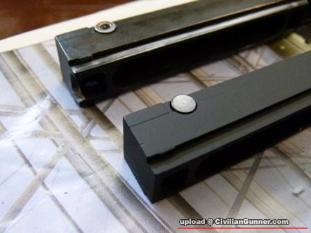

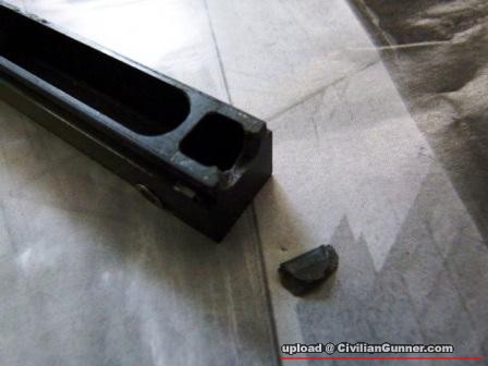

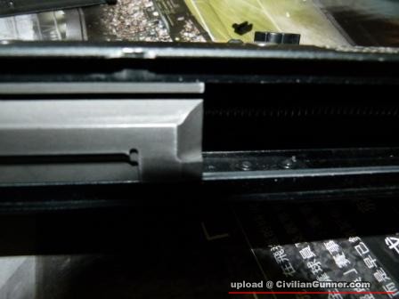

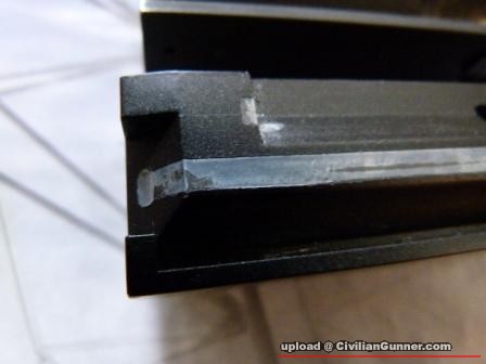

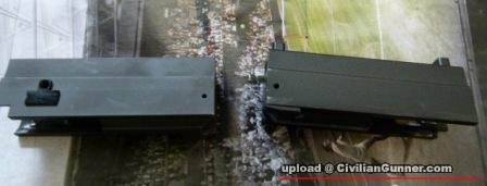

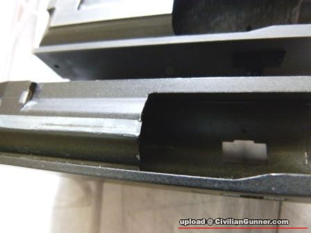

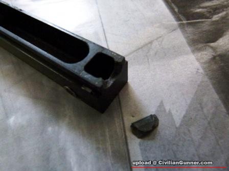

After replacing the Open bolt kit and played for 20-30 mags, suddenly i found there 嘔彈 constantly and the hopup is not working at all. That is when i saw the bolt carrier being deformed.

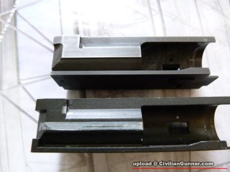

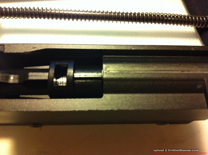

(Upper is RA tech steel bolt and lower is original WE) Using the finger touching the inside of the cylinder, it seems the cylinder shape has slightly deformed and causeing trouble to retracting of the 飛機.

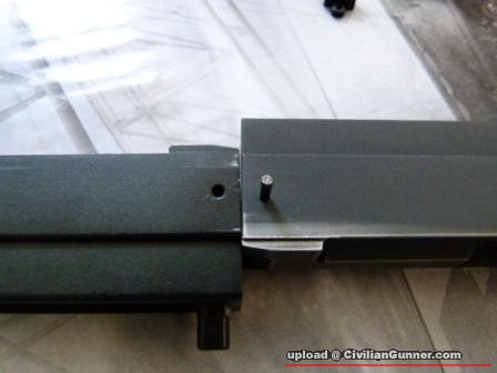

Also not satisfied with the high cycle of the open bolt, I go to get a steel bolt carrier to replace the original bolt carrier. Quite an expensive purchase actually, over 700 dollars.

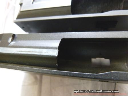

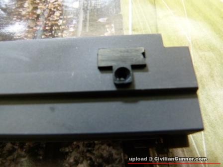

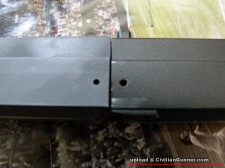

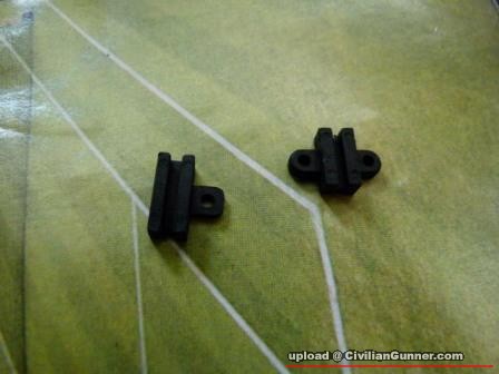

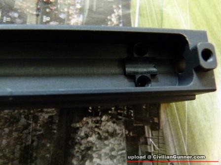

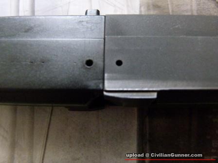

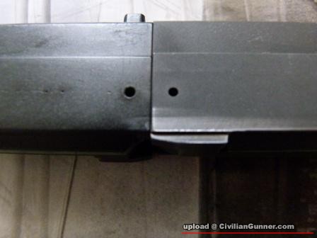

However it is not without any problems. The 飛機 retention pin hole is slightly smaller than the pin itself (2mm vs 2.2mm). So i have to drill the hole a bit larger.

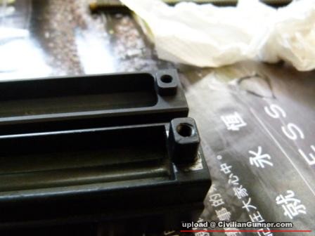

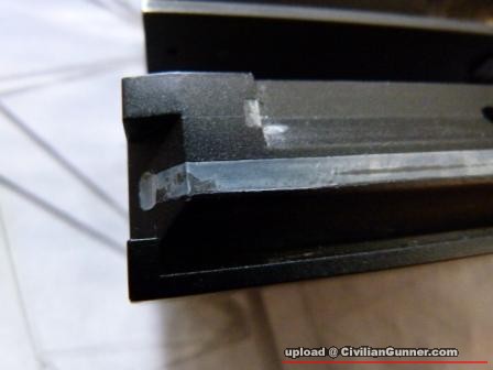

Also the size for holding the 飛機 retention grove is too small and cannot insert the plastic thing smoothly. So i have to file the plastic grove down a bit.
Finally for a 7xx dollar aftermarket part, I have no idea why they did not fully copy the original copy, and instead made this location so much shorter.
This maybe the cause on the reason why i broke the charging handle

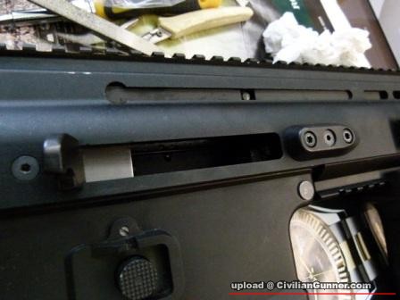

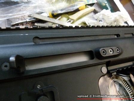

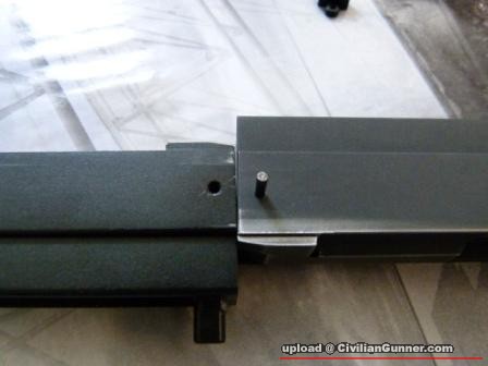

Several dry runs have to be made in order to ensure everything fits perfectly. I have also sanded the bolt carrier on all sides to reduce friction with the body.
Finally is the installation of the 飛機, which i have customized to reduce power. Afterall the original setting is over 1.5J, way too much for indoor CQB purpose.
The final product - The steel bolt carrier gives high blowback, but one mag can now only shoot 28- 29 rounds. I will have to test more with that.
Final thoughts: on WE GBB - I will avoid models that have alternatives. The M4 Mags are just bad, and the gun's material is just not up for use. For M4 i will definitely not buy WE.
on RA-TECH - Material itself is seen to be of top quality, but the dimensions should be better as this is one expensive aftermarket parts.
But since only WE produce the SCAR, there is no other choices. Also given the simplicity of the SCAR, WE should be able to work out a better design for the gun and minimize the use of aftermarket by the buyers.
Meanwhile we will have to wait and see who else will come out with a better SCAR.

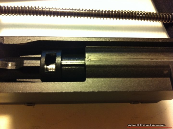

個bolt成日變型又zip實隻飛機,係因為回鏜彈弓果個圓筒唔夠長做成,
zip長少少試下啦
原帖由 rYaN 於 30-6-2011 17:46 發表
zip長少少試下啦
其買小弟也有做足功課
新槍買回來已即時在圓筒墊厚5mm以縮短槍機行程
先試過用手拉槍機時也是只有剛剛能Bolt Lock 才放心試打
但打了約5匣飛機巳不能正常縮回Bolt Carrier

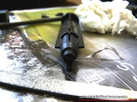

拆開發覺Bolt Carrier 底部前端己被擊錘的轆仔咬到變型
而最後發現兇手其實係回膛彈弓桿最後面個塊吸震軟膠
每次槍機後退時衝撞圓筒及把吸震軟膠壓扁超過5mm
所以就算墊盡圓筒加厚
槍機行程還是太長而讓Bolt Carrier 底部前端被擊錘的轆仔咬到
所以問題重心還是在那塊吸震軟膠
太軟會令槍機超出行程
但太硬又怕把摺拖底板打爛
頭痛

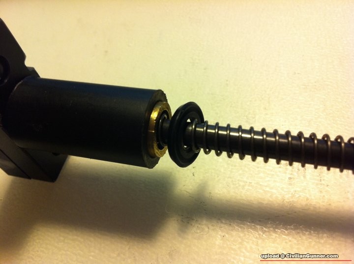

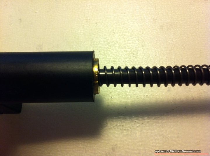

水喉膠墊 + 熱縮膠就得
原帖由 katotaka 於 1-7-2011 02:56 PM 發表
水喉膠墊 + 熱縮膠就得
要多留意有冇變型,一變即換
原帖由 rYaN 於 1-7-2011 16:08 發表
要多留意有冇變型,一變即換
我用緊o個 D 比較硬身少少
再用熱縮膠固定位置,中間個洞仲可以掂唔到 recoil spring
原帖由 katotaka 於 1-7-2011 05:53 PM 發表
我用緊o個 D 比較硬身少少
