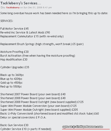

I had the motor rewind service + moisture proofing + hop mod.  Must send the whole lower body assembly to him for the repair. The total is over $2700 HKD including shipping cost.  Hope it is worth the money!

I send it by Fedex and he send it back using UPS.  I had no problem with the custom of both places. But of course, I have to write clearly that this is airsoft gun parts and cannot be modified to fire real ammunition. The UK guy had done this many times and got no problem with the custom.

If I have a choice, I wouldn't spend so much on a repair job.... but even the stock systema motor is not reliable, and I can't wait for Sailun CHing's solution... so finally decide to give this UK guy a try.
I didn't disassemble the lower part after I get it back, so I don't know what he did for the moisture-proof.  Maybe I can test it when I have a rainy day game.

防潮喺喺電子版喥塗coating,喺鴨記可以買到材料,好簡單既我覺得唔需要搵佢整,不過摩打佢真係整得好掂加改良。
你到時候落完雨都一定要擦乾槍身啊如果唔喺好快生鏽。
