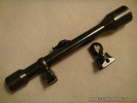

今日番埋個mount同支鏡 可以開工啦 但我發現個白痴問題
個前mount點套落支鏡度 同點樣固定支鏡唔會氹氹轉
請各C-Hing提点指教!非常感謝

原帖由 MANKF 於 16-7-2011 23:35 發表
請各C-Hing提点指教!非常感謝
You will have to take justment tower off, which means disassembly to mount the front turret.
You will have to silver solder the scope on the rings.
Some suggest arcaglass for re-act only.
For me, I am thinking about drill tapping the bottom of turret rings and use a small jimi screw to hold.

Thanks Natrium C-Hing for all suggestions.  Due to my scope's front justment tower is very tight!  I need my friend's machine help to turn it out.  For fixing the scope firmly on the mount, what C-Hing suggested "silver solder", isn't it means 點焊,as my friend suggest 點焊at the bottom of the ring to fix the scope in position.  However, after that,  you can't take it out again.
原帖由 MANKF 於 18-7-2011 23:22 發表
Thanks Natrium C-Hing for all suggestions.  Due to my scope's front justment tower is very tight!  I need my friend's machine help to turn it out.  For fixing the scope firmly on the mount, what C-Hin ...
you'll have to remove bluing of position that soldered, apply thin layer of solder on the rings and the scope tube, then heat them.
REMEMBER you must remove all optical elements when you apply solder as heat may crack them.

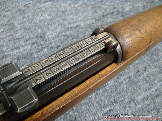

裝個rear sight上去睇吓點先
