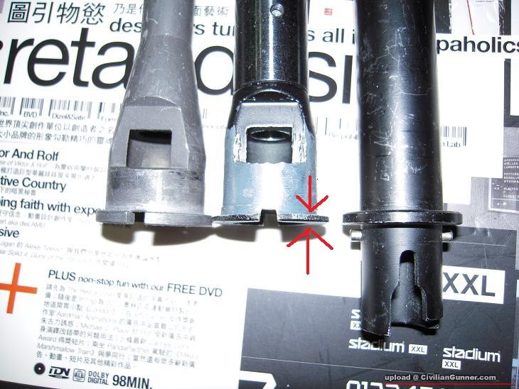

DD Lite玩具骨執法:
其實就唔洗執條骨, 要執就執外管
上WA   中AEG  下豬禁
咁就執左個gap了.
之後到高低級就執呢個

手汁ma!? 好耐性wor

佢執, 不過馬力唔夠, 都好惡搞, D鋁又食曬入去, 越來越難磨...
我發覺自己好似post錯地方...
p.s. 千奇唔好執個身, 因為如果執身, 個頭短左, 咁個啤佬就會入左, 會發生什麼事就唔洗講了.

正~啊!!!!
THX C兄POST圖教學.!
明白晒~!~
緊就要等D件齊晒開工時就知到洗唔洗執了~~~

C兄,如果有GAP.係唔係執薄呢個位啊???

我真係用手執........................

冇錯, 但睇住來做, 果個位唔可以太小, 由其是你用長管. 而且果個位要盡量平, 如果唔係可能會搞到條管唔正中, 聽落好難搞, 但其實好易的.
磨太多要zip介子, 磨太少又有gap, 所以要一路磨一路試.

Really extensive modification. Just what I was thinkng about. Taking out 2mm of steel is really a pain in the ass if you're doing it by hand.
