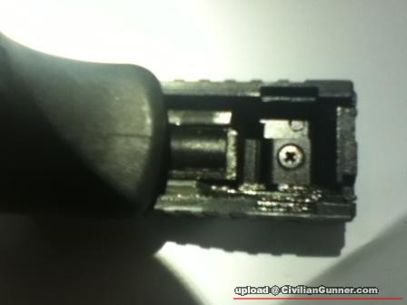

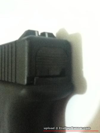

WE G17 拆唔到slide

I have told him la....
Maybe the hammer is stuck...
影個飛機座(slide尾)黎睇睇

唔知係咪o甘。不過其實我係咪可以試下入氣打下睇下可唔可以番去原位,琴日打game打曬D氣XD 唔該ching :-)
G17 - slideback.JPG (15.99 KB)
6-8-2012 21:52
G17 - slideunder.JPG (17.43 KB)
6-8-2012 21:52
原帖由 sinner 於 6-8-2012 21:52 發表
你隨彈甲拉雞,扣唔扣到雞?

除匣之後扣到呀,但係就之前扣就會有啪一聲,而家無。ching介唔介意我聽日買番支氣之後先搵你><
