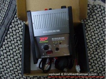

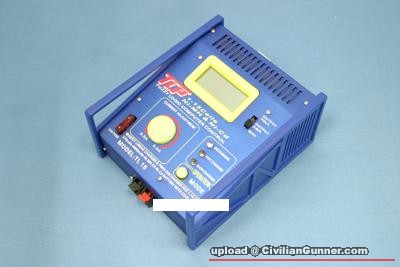

想請問各位, 這一部叉機好嗎 ?
我現在用緊一TLP 4000C Battery Charger,
但我成日唔清楚佢幾時 charge 完 `
不停 Beep 足一晚甚至兩晚 tim ...
我要幫朋友買部, 但又怕 advice 部唔好野給他, plz help ... thank you `
另外 APEZ charger 又好嗎 ?
Thank you very much much much much much again `
萬分感激各位的幫忙 ~!!!!!!!!
TLP 15.jpg (20.3 KB)
7-2-2009 12:12
我想買的
TLP 4000C.JPG (34.72 KB)
7-2-2009 12:12
現在用的

nonono, the shop keep told me that, it will keep on beeping, but until it finished, it will stop ...
But i dont think i have ever seen it stops beeping ...
and i have already lost three 8.4 V Intellect batteries on the 4000C already ...
Three of them both burnt down ...
一路差一路bit.....
唔會呀...你係咪唔會咗
Ken's Custom Magpul M4
4000c 慢charge係會keep住beep架喎

btw, 我用4000c, 對付個慢叉係咁咇嘅方法係.........
拆左個buzzer去
拆左個buzzer去8 ...
有師兄試過換做LED
有心機d的可以整個switch,鐘意led就led,b就b
