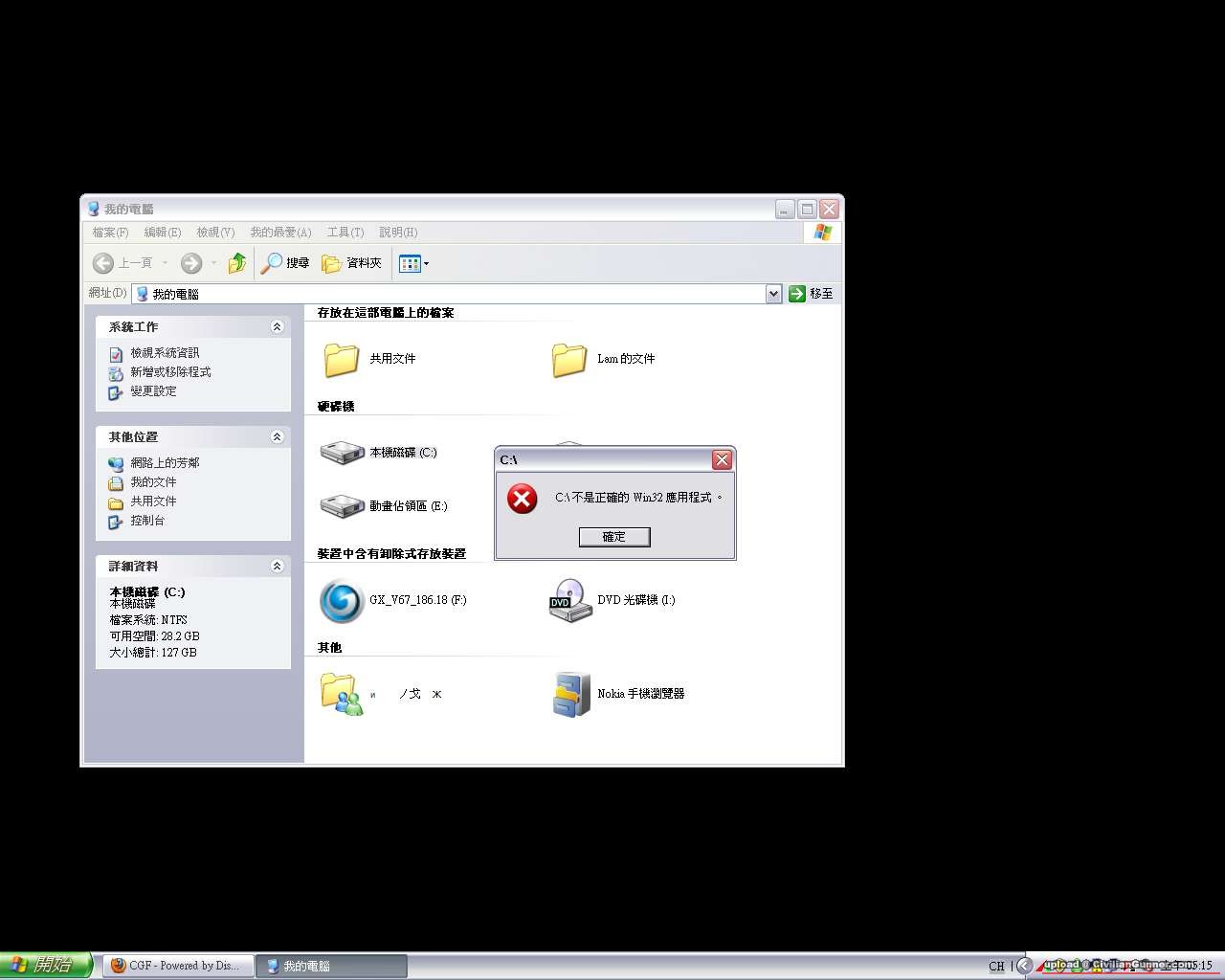

唉...岩岩換完張Display-Card,諗住都掂既..
點知...我即晚中左毒...
快手裝左個"成龍防毒",清哂d木馬之後..reboot完我部機,我係我的電腦就入唔到d drive,只係出呢個野..
下? 咩事? 係咪防毒又刪除左d咩?
點解個天要咁對我? 我係咪可以去拎隻Windows碟來修復? 定係有其他方法?
希望大家幫幫我....唔該哂...
用IE入
網址 C:\
入唔入到?
ps.真係多謝你,我部電腦都lai埋野....

其實兜個圈係入到既...
不過...我想解決嘛...而家個firefox又唔可以整番d bookmark出來..

By what you said your computer OS was damaged with the Virus/Spyware. You can try to use the Windows Installation disk to repair the OS. I hope you know what you doing.
After that, you need to scan your computer again with the Anti Viurs/Spyware programs.

我尋晚用nod32掃到e家都未掃完阿

而家咪就係果隻毒發出來的後遺症囉
你right click 選open應該都入到既
詳情要搵返果隻毒的fix先得

我用果個Kapa斯基掃完哂....都唔知點咁..
夜d問個friend借隻window來restore下囉....
而家開機如果唔按制就會去scan disc,之後就會停左係 0%, 因為佢搵唔到d drives.....
