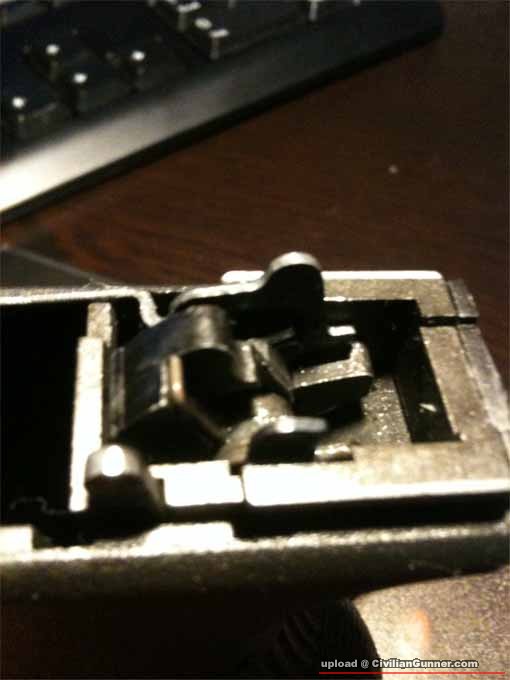

請各位ching幫幫忙

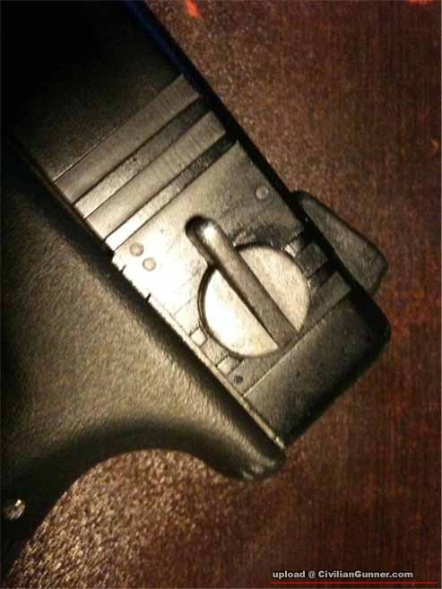

支KSC Glock 23F就算將保險制較到SAFE
(60.38 KB)
26-12-2010 10:37

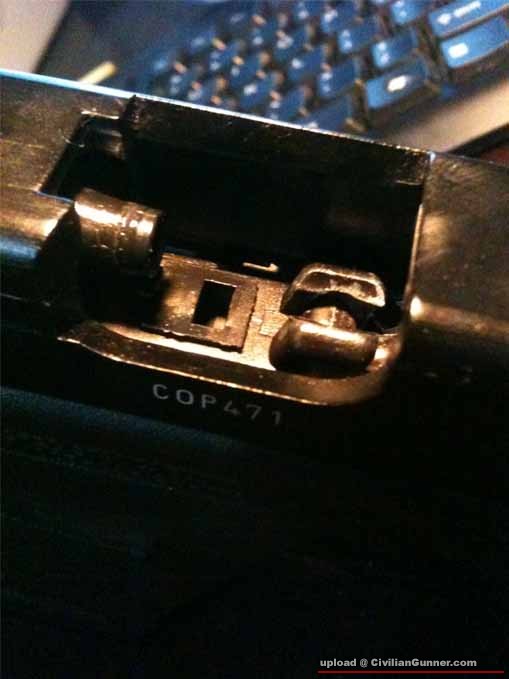

佢都係keep住單發or連發而且如果我入彈匣開槍仲會變成咁

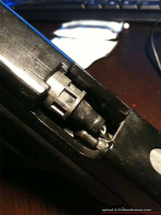

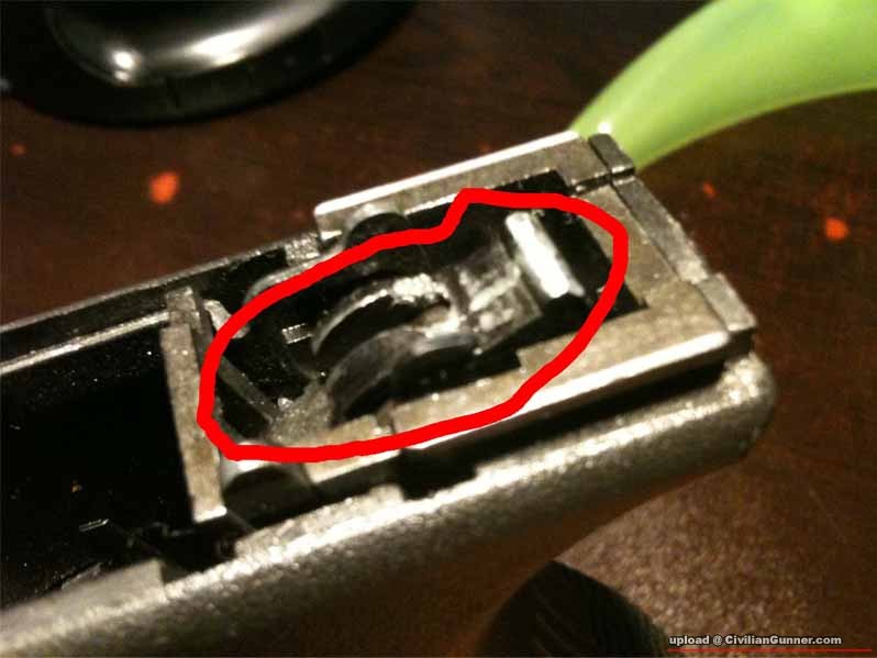

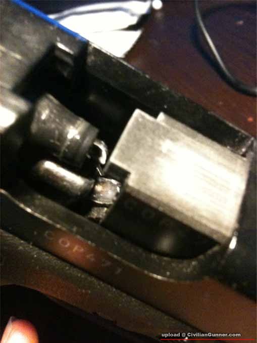

之後我拆開個滑架發現e個位好似出現問題
(64.29 KB)
26-12-2010 10:38
我一開槍紅圈個位就會彈上黎
(40.48 KB)
26-12-2010 10:38
~正常應該唔會

C hing this is no safety catch. It is the auto and semi-auto switch, the lever pushed upward is semi-auto, downward is full-auto. If you pushed at the middle., it is to release the slide only.

邊位師兄咁大整蠱話你知中間係safe?

姨~唔係咩?我一直以為係.....
~但係我較到單發or連發都冇彈出,而且仲噴氣,咁支槍仲有冇得救??
thank c hing

detail 太少
hopup 組問題?
匣既出彈口撞過黎變左形?
隻匣頂得條slide 太緊?
....等等, 太多可能, 而且ksc 既glock 我都唔太熟

滑套卡到飛機,用約四層的紙片去墊在飛機座跟滑套之間就OK了~

跟擊鎚磨耗無關,這是KSC G系列的通見毛病~

如果無改善,再檢查一下#92是否變形,對擊發有很大的影響~
