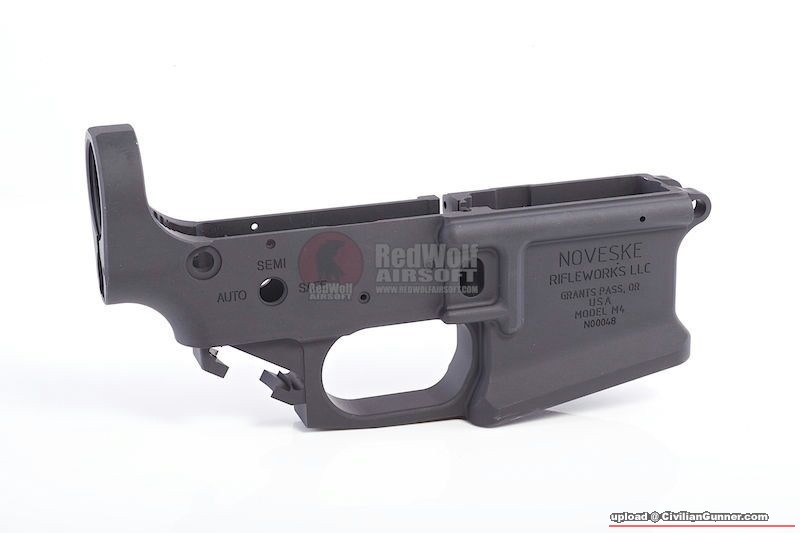

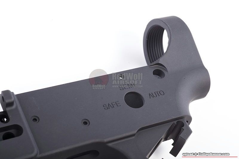

啱啱想係FCC買,點知無貨,咁岩見到紅色的狼竟然有,我想問買唔買得過呢?

OME-ed by Prime, Socom gear have come out with a beautiful CNC 6061 aluminum lower receiver for Systema PTW M4 series, CNC Aluminium proccessed with realistic and fully licensed Noveske Gen 2. trademark engravings on it. It's good to use this for decorating your PTW M4 with this high-quality stuff considering the PTW is a high quality product on it's own. Since the new PTW's have a ambidextrous fire selector, this one is made especially for them but it will also fit standard PTW gear box without ambi fire selector.

我對prime無咩信心,聽得多佢成日錯數,所以想問吓師兄有咩意見

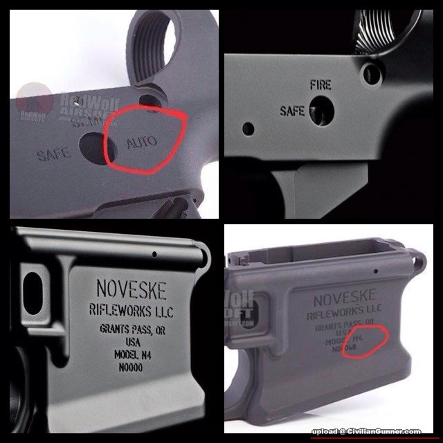

師兄,呢隻喺有啲唔同,
留意右面刻字,FCC版本同真槍下身應該喺"MODEL N4",非此處的"MODEL M4"
另外,N4下身是民用單發,不會有AUTO刻印,所以亦不應有FIRE上面的仿連發組件pin hold
此為較顯眼差異。不過點解唔造好佢呢
其它magwell邊切割工夫,可以執好啲
Prime真偷懶了,可能要就番成本同價位,多一事不如少一事吧

原帖由 fwkwong 於 14-3-2014 14:29 發表
師兄,呢隻喺有啲唔同,
此 ...
嘩!好彩無買到啫,多謝師兄提點!!!
N4變M4,多咗個Auto,真係好離譜.....
唔知ayaka師兄買咗未...買咗就慘了!

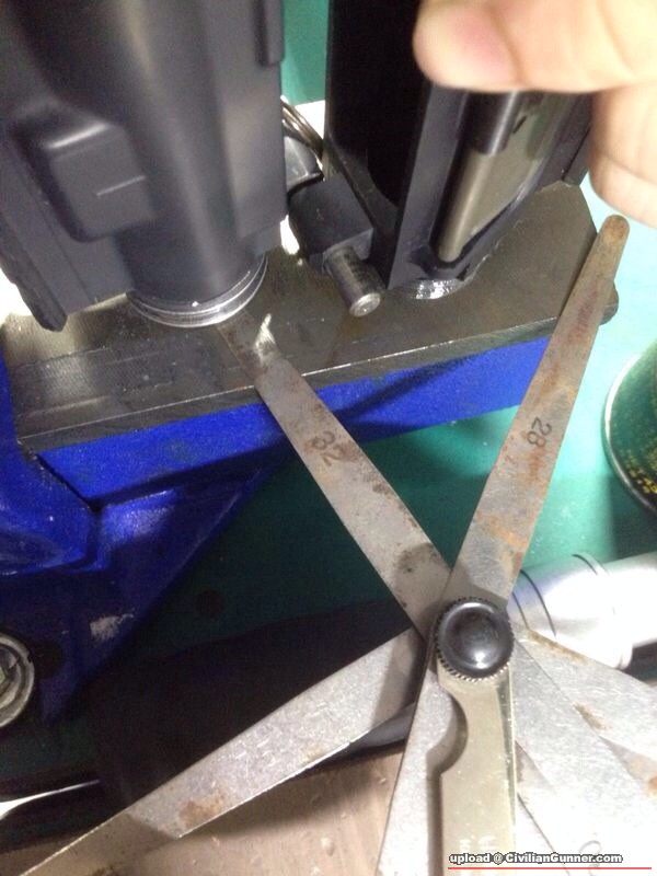

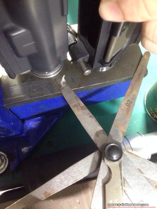

講起錯數,佢近來同PTS出果隻Mega上身都長左啲啲,唔執會chok彈
14-3-2014 14:46
Give a critic an inch, he'll write a play
原帖由 fwkwong 於 14-3-2014 14:46 發表
請問係咪呢啲位?
14-3-2014 17:04
原帖由 Ancestor999 於 14-3-2014 17:04 發表
請問係咪呢啲位?
喺咯

點解可以差咁遠…………大嗱嗱幾千銀………………

原帖由 wing383 於 14-3-2014 18:38 發表
搏大家玩玩具唔做功課咯
搏大家以為佢個Prime牌頭一定好咯
無理由唔知,就是懶,比多少少心機都唔做
冇計啦, prxxe 只知noveske 個名,唔知佢出過支野。。。。。 唉。。。
