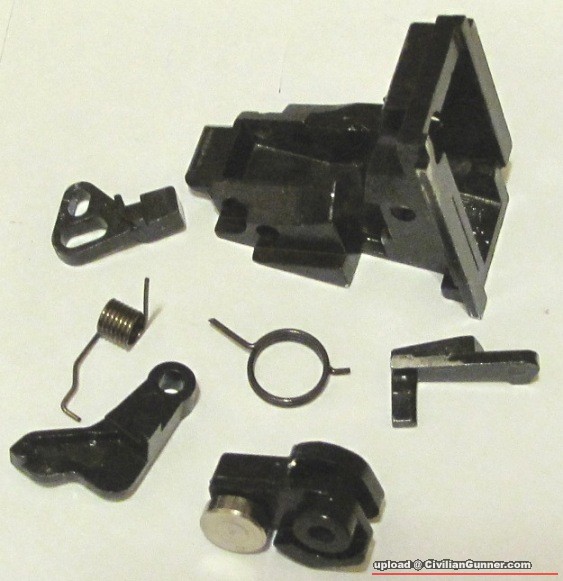

Dear All Ching,
Does anyone know how to reassemble the hammer part itself? I have taken it out so it won't stuck my metal slide. But after I took it apart, there are so many tiny parts and 3 springs wHich i have no idea how to put it back together. Please help.
Thx!!!!

i'm not familiar with TM G17, but maybe other Chings can help you better if you post some photos of those tiny parts?
Good Luck

I have this part map, but does anyone can teach me which part to go in 1st? Many thx!

我尋晚都打散咗差少少砌唔返, 好彩後尾都搞掂
師兄, 你好似唔見咗一條彈弓仔 (G26-48) 喎......

25 , 54 , 47 , 23 , 51 , 50 , 24 , 45
試下得唔得....
個hammer組係好難正.....
搞咩爆散佢?

http://www.civiliangunner.com/cg ... 6962&highlight=
希望幫到你少少先......
