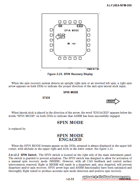

CF-18見到的是Tailspin stall, 係F-18上係有Spin Recovery System, 會指示recovery, pilot亦要maintain指定AOA.

MFD+HUD(If function select)+VOICE會出
"bleed air right" + "engine right", "Caution" + "Warning" button + Alarm.
讀個Civ PPL都會教你點做, 一個熟練的Pilot理應了解自己部機的Aerodynamic同flight control, 唔會做出Over Limitation 既事, 由求會致命, 可述係一個Combat Aviator, 唔會你Left Eng INOP敵人就唔打你架ma
