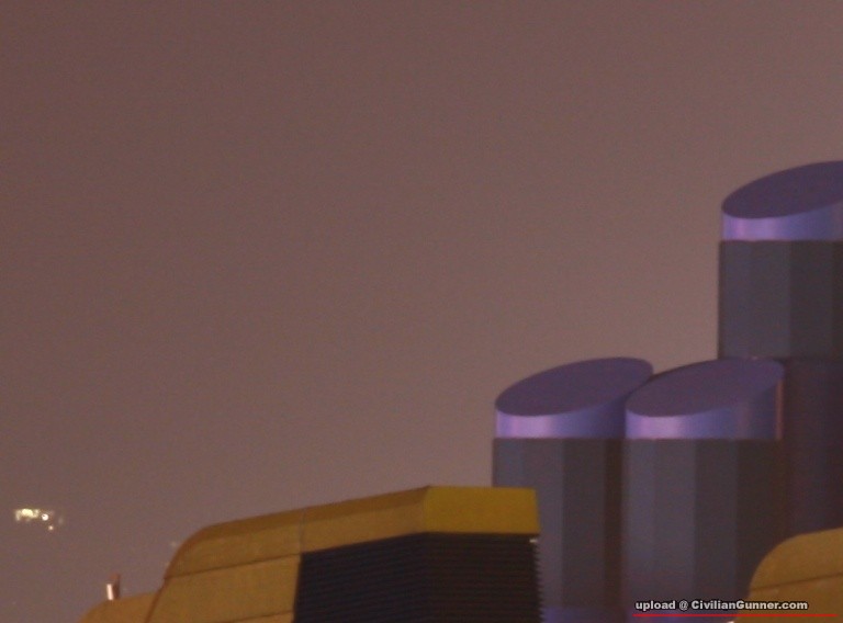

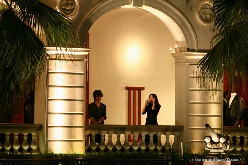

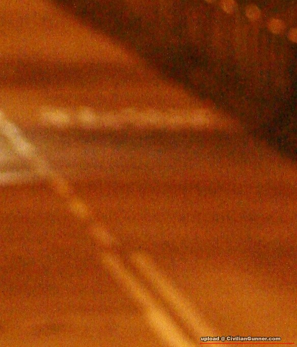

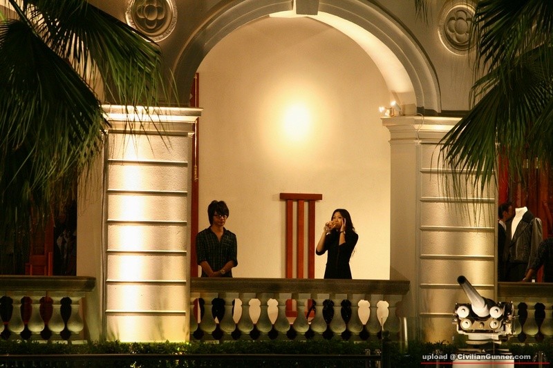

test-1 : 手持,200mm,f4,iso1000

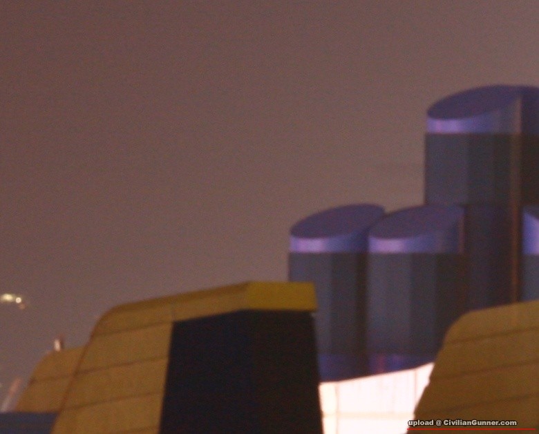

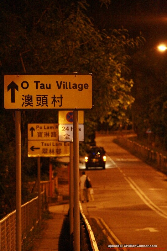

test-2 : 手持,20mm,f2.8,iso640

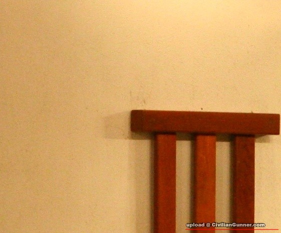

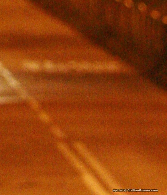

test-3 : 腳架,f8,iso50 & 100比較

test-1 : 手持小小白is用上iso1000都算理想,如果唔聞相...
test-2 : 手持17-55is用上iso640都唔差,幾實用~
test-3 : iso100的noise少過iso50~

test-1 100% crop

test-1 rezise

test-2 100% crop

test-2 rezise

test-3 iso50 100% crop

test-3 iso100 100% crop
