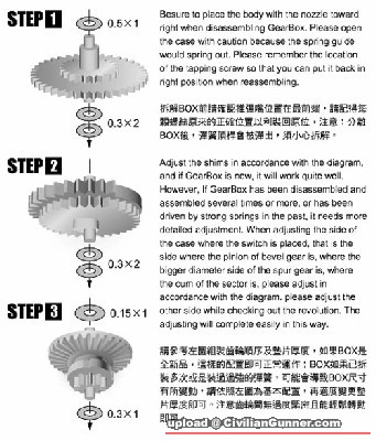

本人果枝係marui的mp5,波箱正大改造,本人正想放一套First的加硬平齒落去,但唔知點set介子先好 ,想問下D介子係唔係底面都要set?同埋D介子的厚薄應點分佈?請各位指點一下?
另外想問,如果D介子set得唔好會好嘈,其實D齒撞到D咩呢?
底面都要set, 詳細d可以參考下li度:
http://pageproducer.arczip.com/daedalus03/shim.html

但點解我跟住整後,合埋波箱時D齒轉唔到~?

只作參考only.....要加要減介子要自己試

夾死左o的齒~~減返小小試下~

first of all, you need to know the rules of setting shims.  For the rules, you could follow the link given by Dominic.
I could tell you that there are no universal shims setting, there are only shims setting rules, if you read that, all are about the same.
