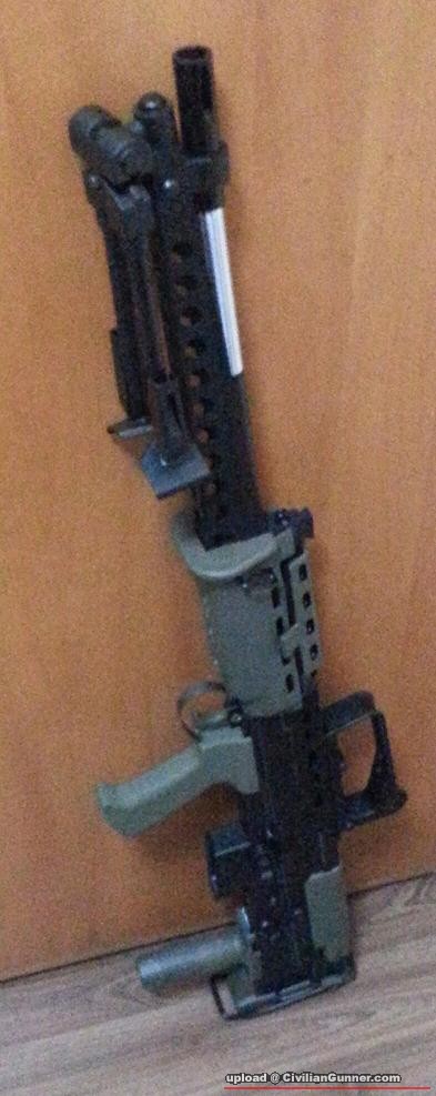

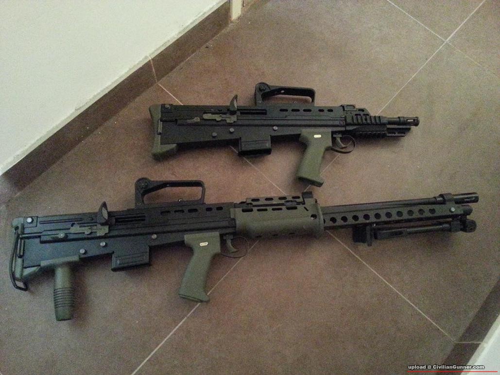

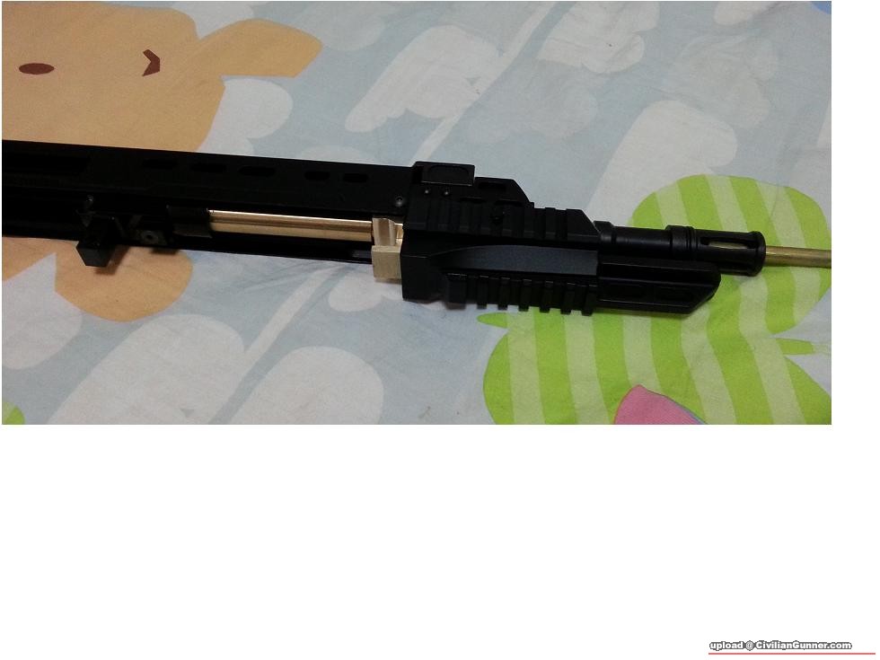

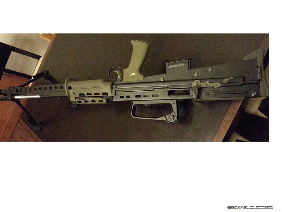

[local]1[/local]小弟用star前節剛改還未噴油的L86A2

waa 師兄好有心,請問前節要汁咩位?
Bill of Material

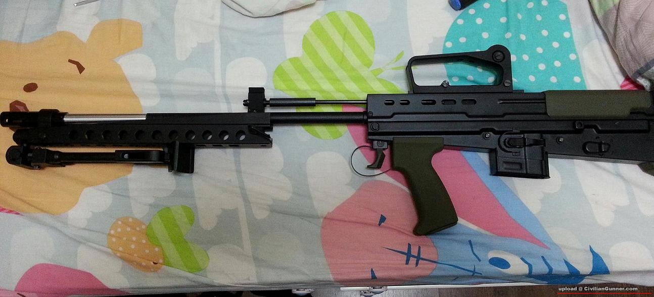

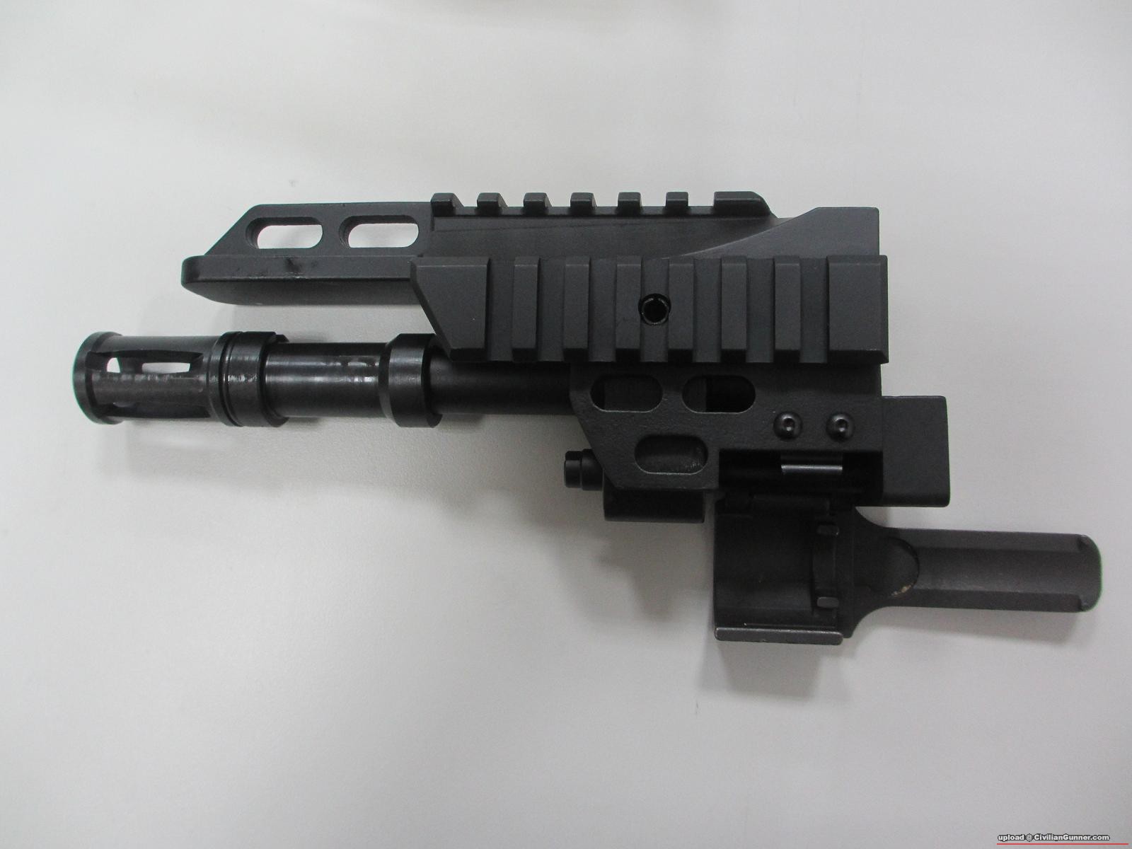

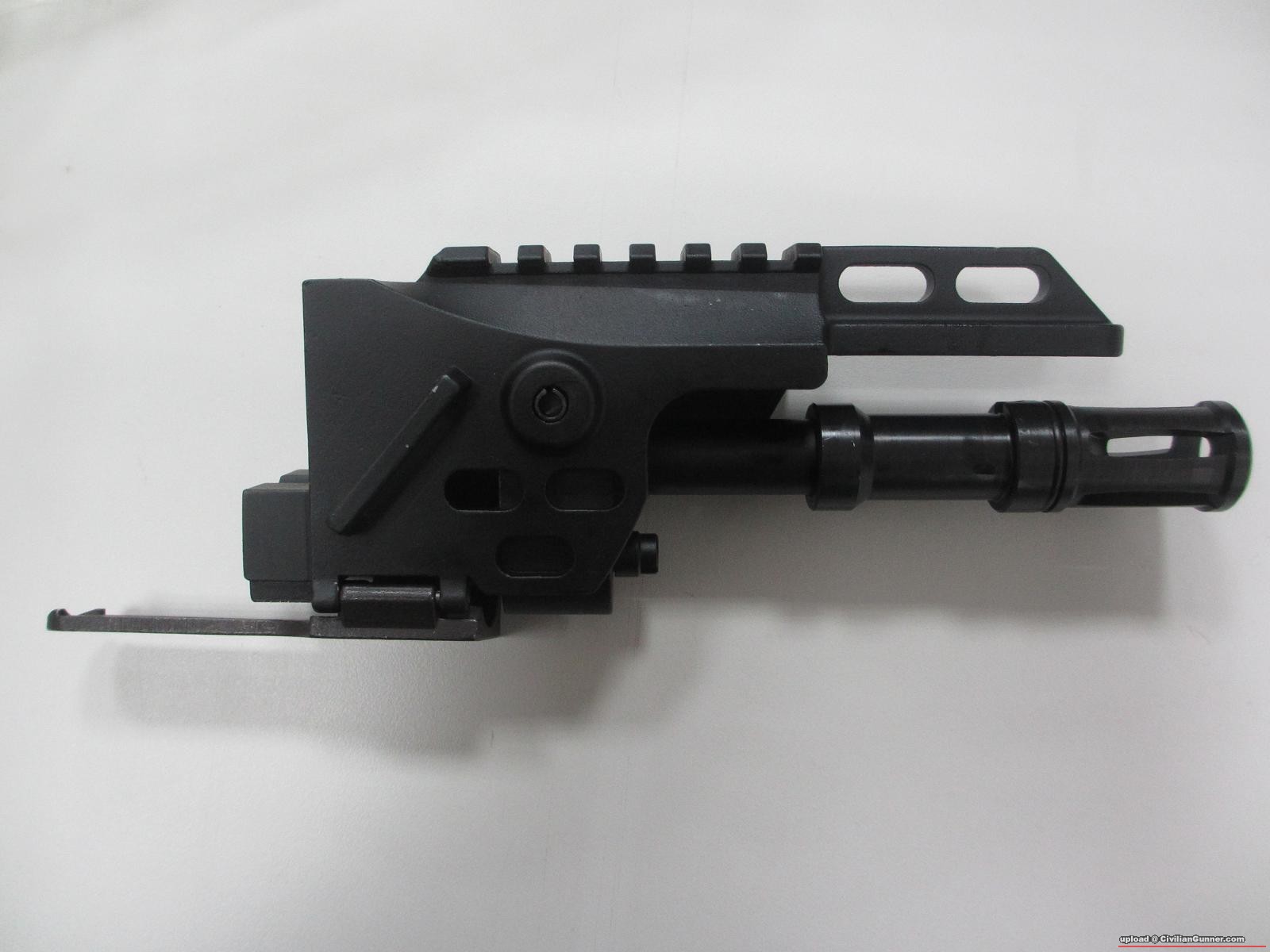

1. 'Hornbill Products' RIS CNC conversion kit with sling loop for ' WE ' GBB L85 / SA80 rifle
2. Star L86 front barrel set
3. Pro-Arms Aluminum Outer Barrel Kit for WA M4 GBB – 40mm section of extension barrel only and modified to 16mm outer diameter.

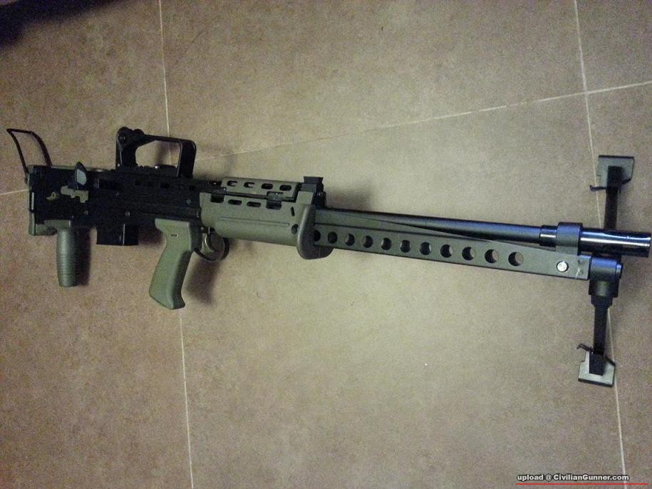

原帖由 luke-luke 於 5-6-2013 20:58 發表
193369
強呀~

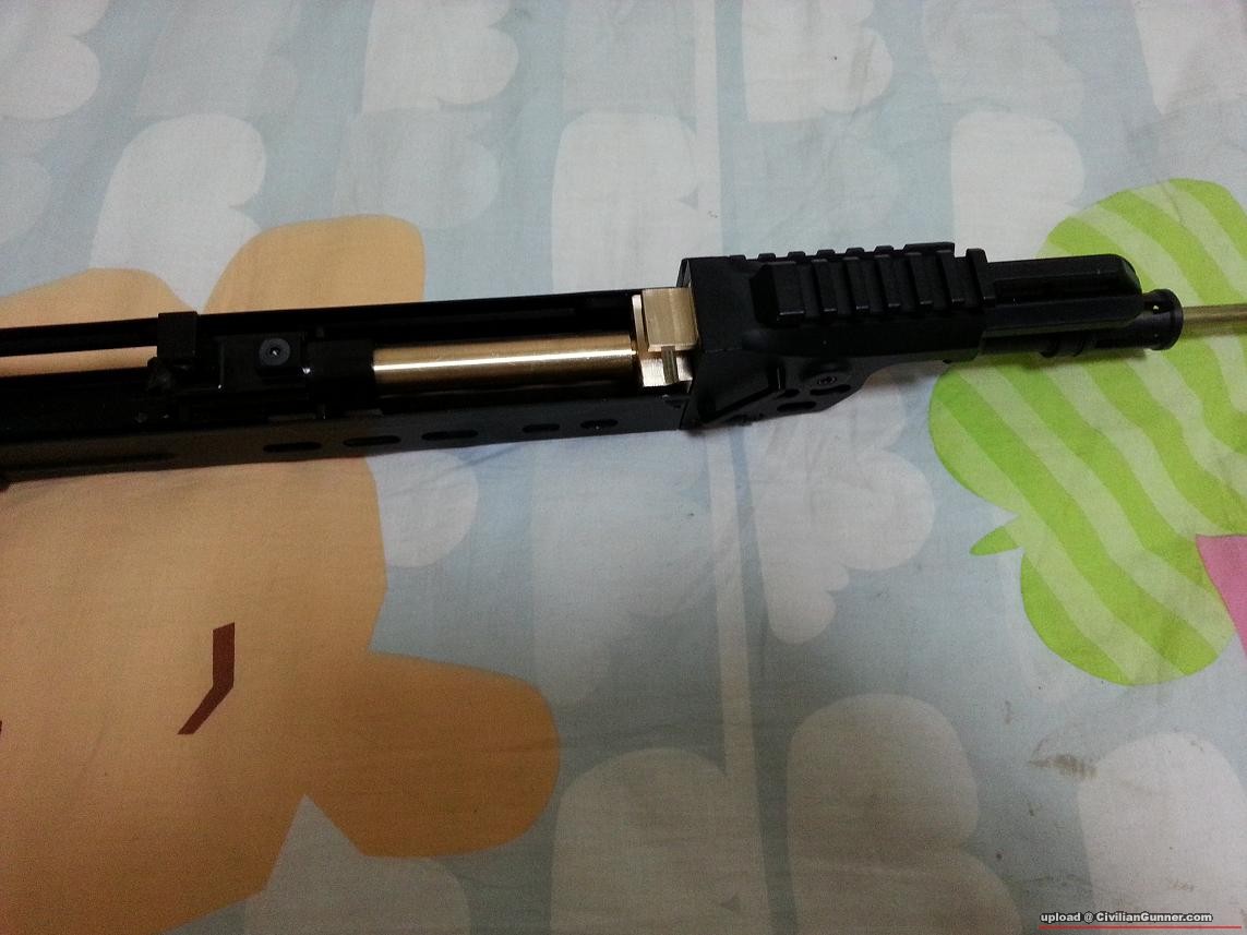

不過想知內管有幾長?

現在是運作良好因未有時間換內管.
內管可能是540mm長.

AFV L85 GBB 攪掂
