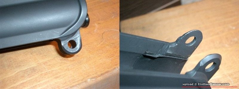

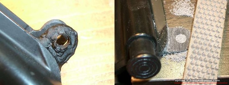

1st find out the broken part
22-3-2008 16:47

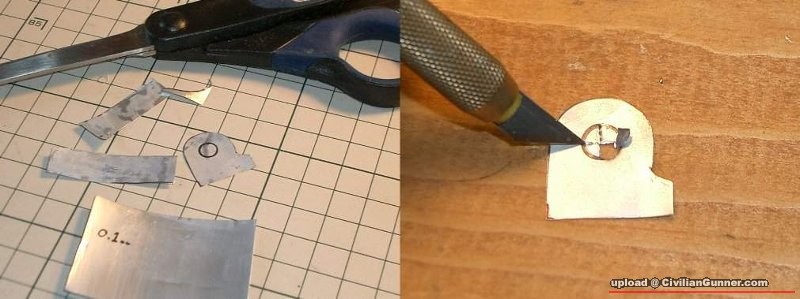

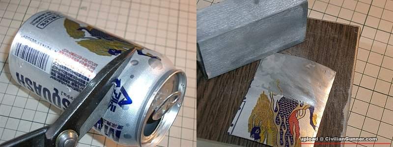

sut some part from a can to prepare
22-3-2008 16:47
measure the size of the material u need.don' forget that's precion requied
22-3-2008 16:47

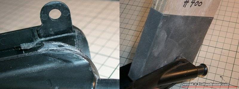

editing
22-3-2008 16:47

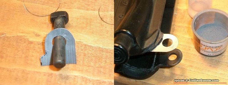

fix a pin to check
22-3-2008 16:47
22-3-2008 16:47
22-3-2008 16:47
22-3-2008 16:47
that's elastic and bendable

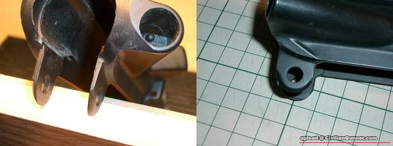

22-3-2008 16:47

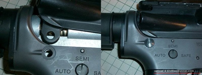

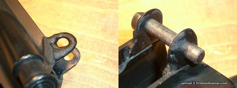

finished
  • 追逐者 威望 +10 原創內容 23-8-2009 20:41
  • 追逐者 金錢 +10 原創內容 23-8-2009 20:41
of coz . that 's for temporarily use only . u may have to buy a metal body in shortly
