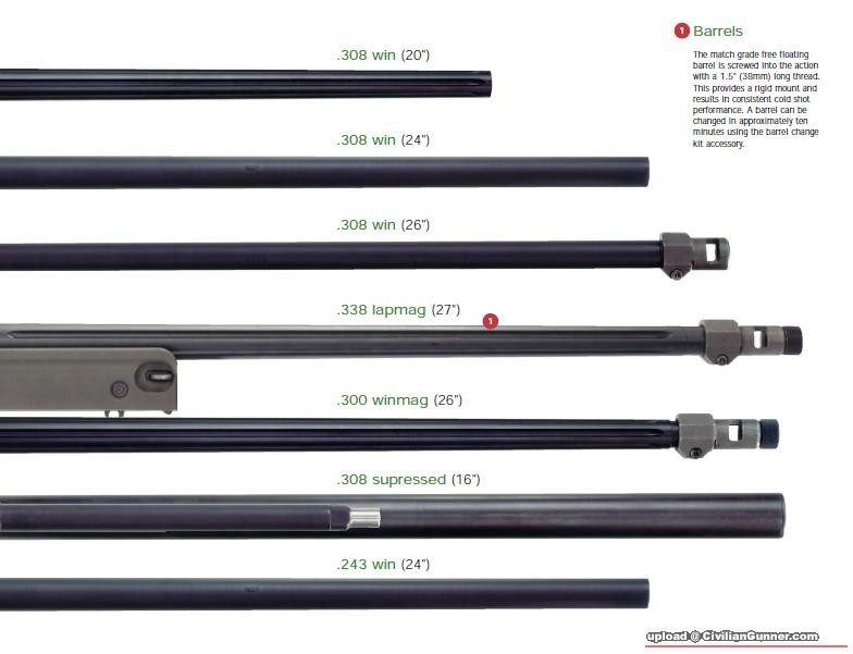

Barrel length
I'm a little confused of how they measure the barrel, does the flash hider counts? let say for the standard .308 barrel for L96, it's 26 inches, does that includes the flash hider as well or just a barrel is 26 inches?

.308SUPRESSED(16")咁長????個圖唔岩比例定係印錯字?

發表於 14-2-2009 19:43
回復 2# 的帖子
16吋係內管
佢比左斷面圖你睇
外面咁長果part係SUPRESSED

發表於 14-2-2009 23:43
如果師兄有留意
.308win (26")
.300winmag (26")
便會發現, 如果把火帽計入計算內的話, .300winmag 是會比 .308win長, 從此可見,
火帽是
被無視
的. (大誤

發表於 8-3-2009 22:34
It should be count by the length of barrel with rifling("Loi Fuk Sin'"
