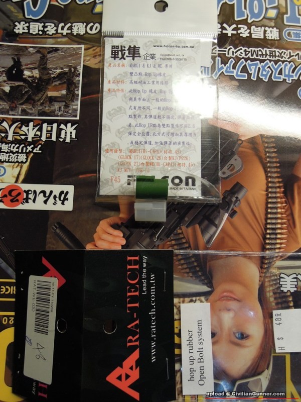

I guess in response to F22 Ching's recent post in arms cool, i also want to further the discovery that NONE of the market claimed hopup rubber is 100% for WE SCAR. Have a look at the picture and you will understand.
Quite a bit of disappointment that despite the claim these manufacturers did not really invest in the detail of a small piece of parts that is so vital.
[ 本帖最後由 dennislau1 於 22-5-2011 22:25 編輯 ]
Hopup comparison.JPG (131.66 KB)
22-5-2011 22:25
Falcon and RA-Tech = same size! Not the same as WE SCAR original part size!

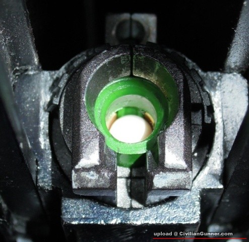

Also I encountered another problem with my WE SCAR. The BB was always pushed too far inside the hopup chamber after each shot, leading to '小便彈'. Any Ching have solution to this problem?
[ 本帖最後由 dennislau1 於 23-5-2011 00:00 編輯 ]
Too far in.JPG (67.72 KB)
23-5-2011 00:00
Now it is too far in and 小便彈

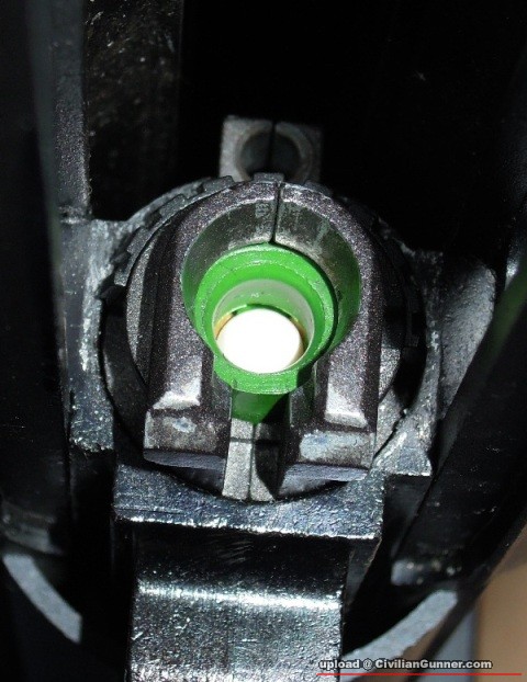

Good position.JPG (85.53 KB)
23-5-2011 00:00
COrrect location of BB
你想咁樣?
