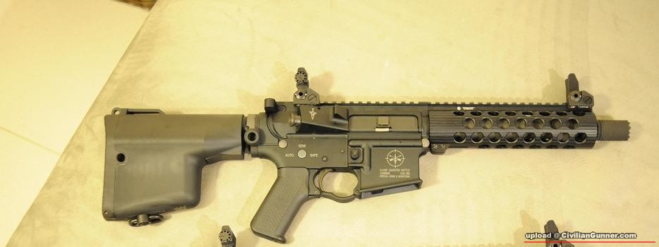

Just砌完支Prime身Troy M7,用下面呢d真品
Troy Low Profile Rifle Gas Block .750
Troy Battle AX CQB Pistol Grip
Troy Enhanced Trigger Guard
Troy CM Tactical Muzzle Break 5.56mm
Troy AX CQB Stock Kit
Troy Ambidextrous Bolt Release
Troy Ambidextrous MAG Release
Troy Industries M4 Sight Set
Troy OEM Sling Mount
Troy Combat Grip Grip Black
Troy TRX Extreme BattleRail M7 - 7.6"
Vltor Charging Handle - 5.56 (買唔到Troy Charging Handle)
Daniel Defense Gas tube
Forward assit button
Dust cover
[ 本帖最後由 henryhhy 於 30-1-2012 10:24 編輯 ]
Troy M7.JPG (47.12 KB)
30-1-2012 10:22
8# 本人覺得如果用一般M4 flat top上身會平常啲 !
個Grip好唔好揸?
[ 本帖最後由 rho837 於 30-1-2012 11:47 編輯 ]

枝槍太毒啦~~我都想請問下個Grip好唔好揸?
我隻手細就ok,如果手大就
