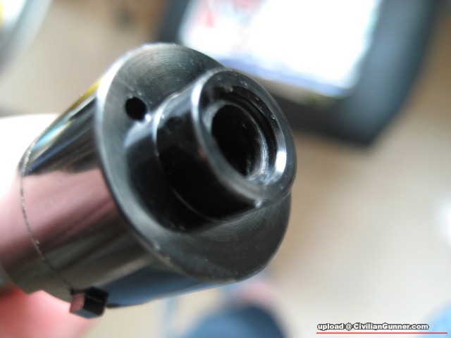

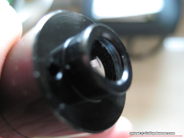

至於國產hop up座就算用番aeg hop up皮都要鑽一鑽先用得,唔係就會好似你咁隻hop up皮會唧入去........
此乃prime,hop up皮係差唔多貼到底............
此乃5KU,一對比下會發現個窿位唔夠prime咁深.........
用9.5mm鑽咀隊吓佢,唔好心急,一隊穿就玩完...........
加工之後隻hop up皮就唔會唧入去啦~~

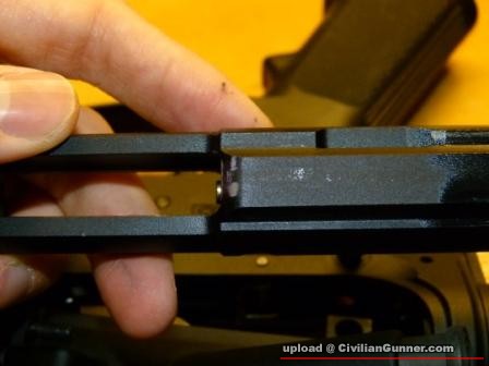

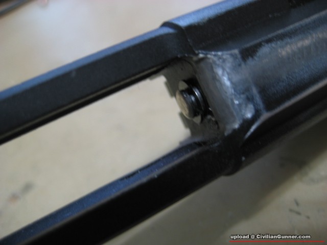

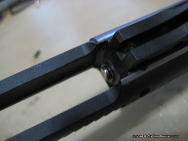

But i still encountered some other problem in the bolt carrier. I know it need some grinding at the back, but it seems the energy bolt does not perfectly match the BC so need to enlarge the guide hole in the guide plate a little. Dont know if you have encountered such problem.
Also i found the C-clip sticks out a little from the BC, and it is quite loose and can move back and forth. I was thinking to add a small copper plate to better protect this fragile 'thing'. If ching have any advise very appreciate!

1.  9.5mm鑽咀唔係咁難揾呀?
2.  塊版唔平就磨到佢平............
3.  只要隻C-clip鎖得緊有少少前後郁問題唔大,我都冇理佢咪又係咁打.......... 如果真係介意攝介子都係好方法...
