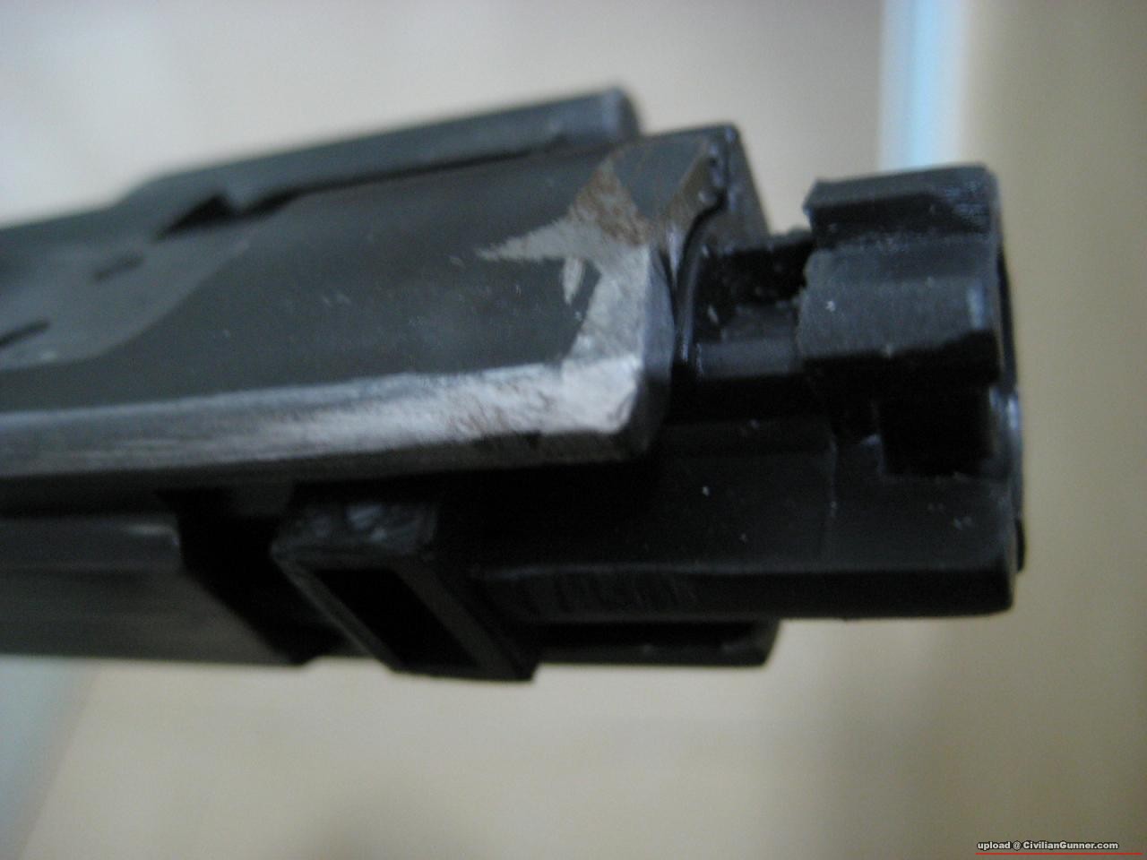

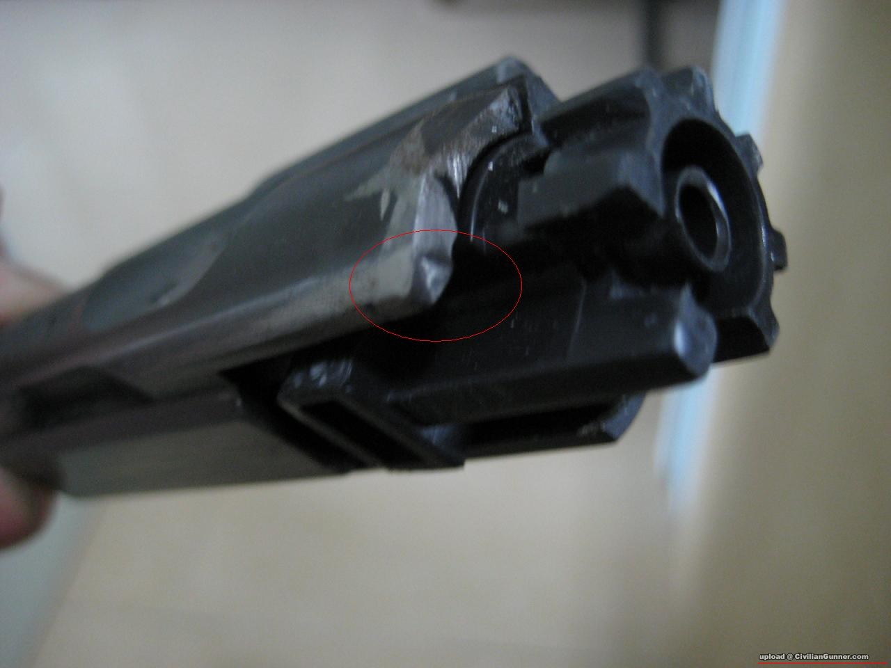

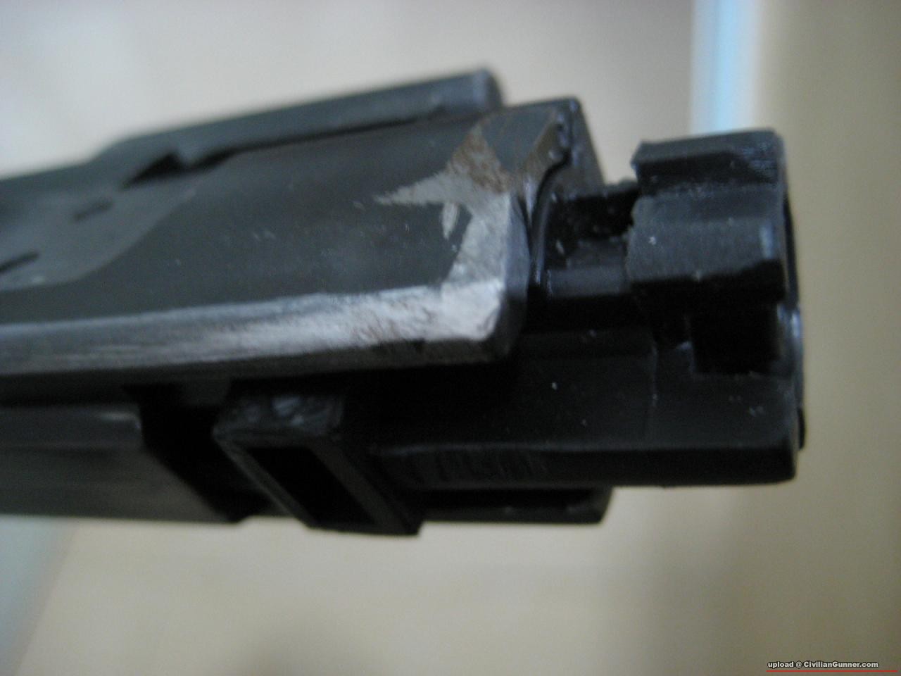

Anybody got a good way to deal with the wearing out of the bolt locking area on the carrier?
I have been filing the part whenever it g ...

已經用原裝試...估計係BOLT低磨左條坑出黎..連發時BOLT低因為有條坑係到頂唔返個擊鎚個扣去前面
所以個扣仲扣住左

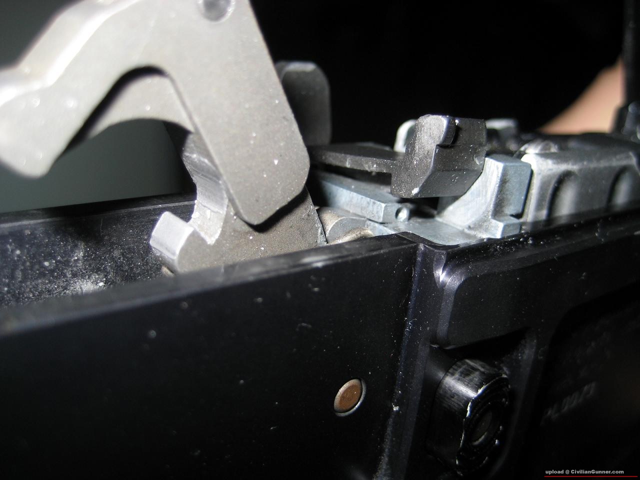

1.甩匣
2.撥連發
3.扣實板機
4.拉上膛捍
5.慢慢放回上膛捍,聽吓hammer有冇响條bolt回位之前彈起..........
其實撥去連發....扣實板機...再係隻匣位望入去..佢推出氣個舊野有無出黎得唔得...
岩岩睇左...單發個時佢推曬出黎..連發推得一半...咁可以點搞搞佢~

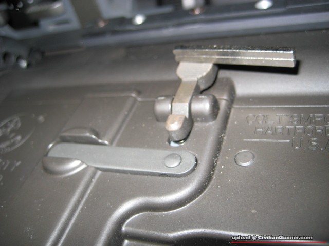

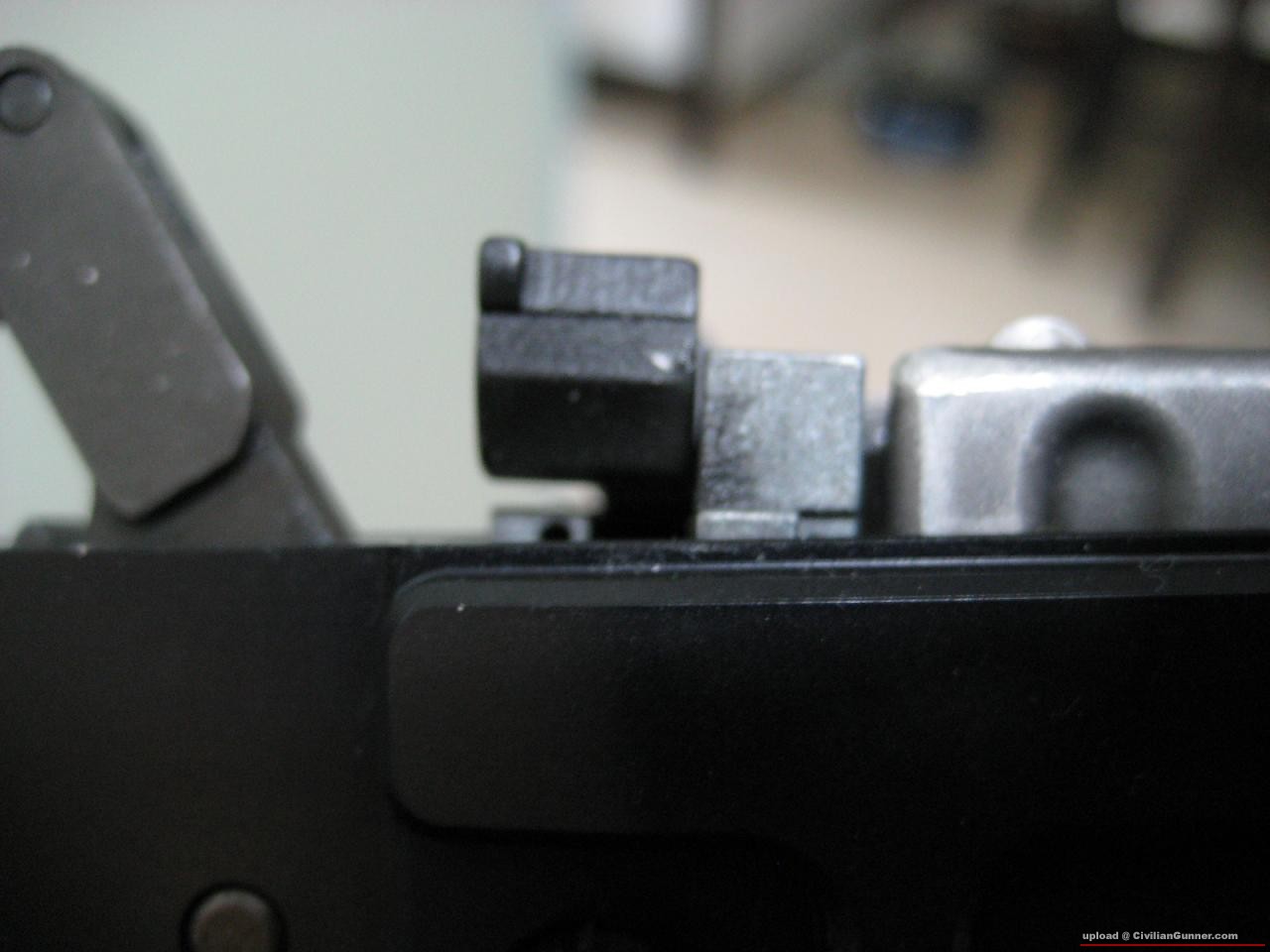

I mean the position of the screw on picture 2.....
Did you put your own screw in or it is the one by Iron airsoft....?
Mine is a prime bolt carrier.....and they don't have screws.

嘩,乜你咁好眼睇得出係416條bolt? 粒螺絲冇錯係我自己上.......
咁你條prime bolt係鋁定鋼呢?可以燒焊救番喎........
I guess only bolt carriers made by iron airsoft have screws on them.....that includes 416 / Adams arms / POF bolt carriers.
I have both steel and aluminium bolts made by Prime. They all have the same problem after using for a while......
How do you drill such a small hole over that area??

我只有Prime steel bolt,因為係鋼所以可以燒焊救番,鋁bolt都可以燒,不過效果冇鋼咁好..........
我呢條bolt 燒焊後已經打過超過百幾匣,都只係個角圖咗啲啲...........  prime鋼bolt係唔平,但可以燒焊乜都抵返晒........

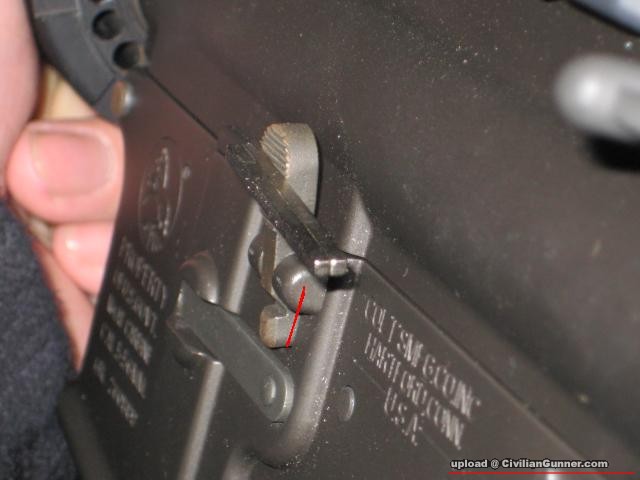

將bolt stop 做啲手腳,响底部內側磨個斜位令佢彈得更高,可令lock bolt更實在,可靠.........

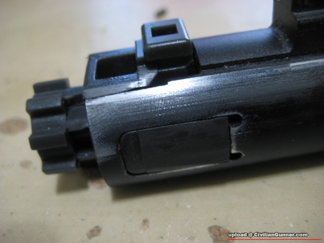

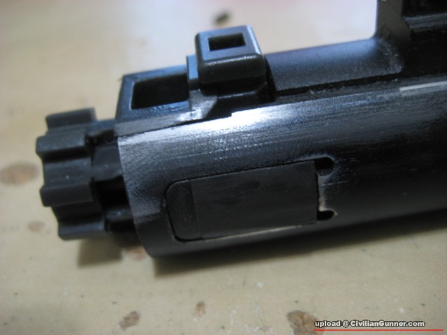

bolt stop改法:
拆隻bolt stop出嚟大約係咁角度磨斜位..........圖為KA...........

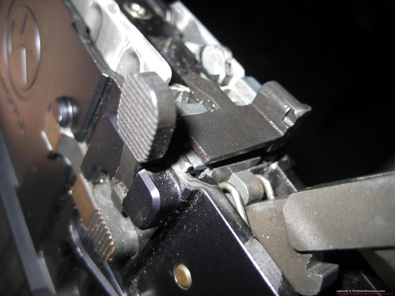

另一角度可以睇清楚啲..........

It is indeed a good method - to let the bolt stop rise a bit higher.....but my main problem still lies on the wearing of the bolt.
I don't have welding equipment nor that I know anybody who has.....I guess drilling a hole and putting a screw in is a better alternative.
Thanks for your info anyway.
我諗我直接換鋼bolt試試先,反正都磨損左,prime bolt 大約幾
Prime steel bolt - $12xx-13xx
I would suggest using the stainless steel version....appears to be more durable. (I have both steel and stainless steel bolts)
