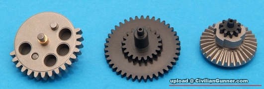

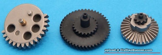

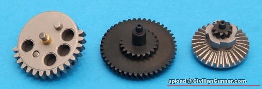

師兄...咁"第一"牌呢三隻用起上黎有咩大分別呢 ?
First - Original Torque.jpg (23.15 KB)
7-6-2007 11:55
First - Double Torque.jpg (21.24 KB)
7-6-2007 11:55
First - Triple Torque.jpg (23.65 KB)
7-6-2007 11:55

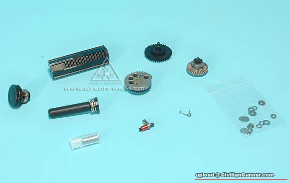

我睇過d價錢, 與其剩係買套齒都要$4xx, 其實買呢一set係咪應該仲抵呢...?

咁恐怖...睇黎都係買"第一"好咯...
Prometheus - Torque Gear Full Set for Ver.2.jpg (22.87 KB)
7-6-2007 17:52
原帖由 大武士69 於 6/7/07 17:52 發表
depends... if you do have some extra money then go for set to start with it... is much easier...
Guns... lots of Guns...
一於扑鎚買呢set !!!
又返番老問題, 呢set野最多可以用到pdx幾多%既彈弓呢 ? 如果有需要換埋摩打, 應該換邊隻呢 ?
p.s. 唔打快頻, 大約rof26-27左右(其實咁算唔算快?), 最緊要襟打 !!!
原帖由 大武士69 於 7-6-2007 17:52 發表
唔好用佢d 啤呤!!!

原帖由 大武士69 於 6/8/07 09:48 發表
咁邊隻好d ? s記 ? 吉打 ?
I am not really sure...  but if the set come with 6mm bearing... don't use it... since it won't last long...
but if you want to use M120 spring or even higher... use brushing is better...
