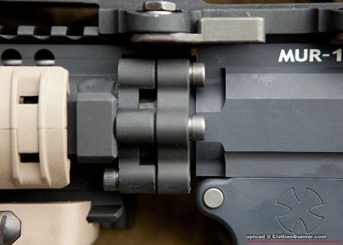

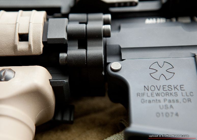

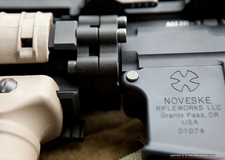

Yes. A 2mm gap. I'm not able to eliminate it. Aesthetically it's acceptable.
可否影張相看看嗎?

For you my friend....
DD Lite is not too difficult to install. The offical requirement is to use their barrel nut wrench to tighten up....but I found out that a GP pipe ring key works equally well.

究竟點解會緊樣呢???
內面究竟有咩阻住左呢???

It is the combined rim thickness of the outer barrel and barrel extension that caused this to happen. If you have means to file away 2mm of the outer barrel's rim, you've got your gap-less flat top rail.

ya~ Depands on your barrel
that's why some ching had modified tapers on both barrel nuts and the RAS to reduce that gap

That's quite true. I'm happy with the small gap that I'm having right now.
