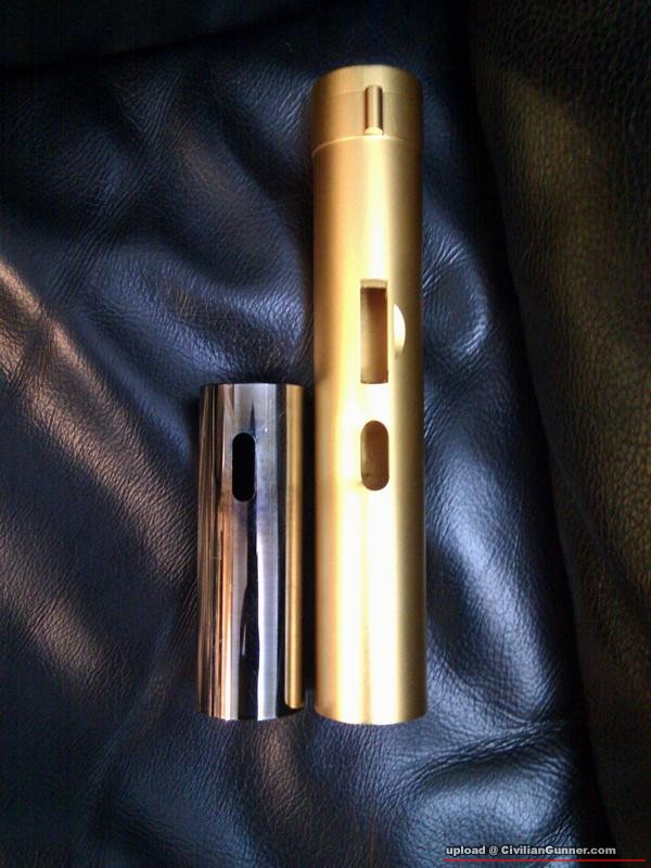

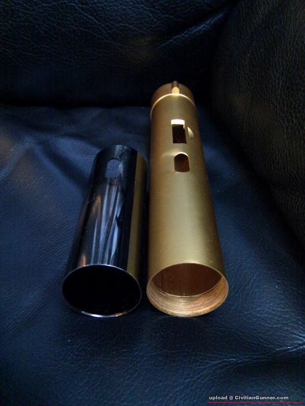

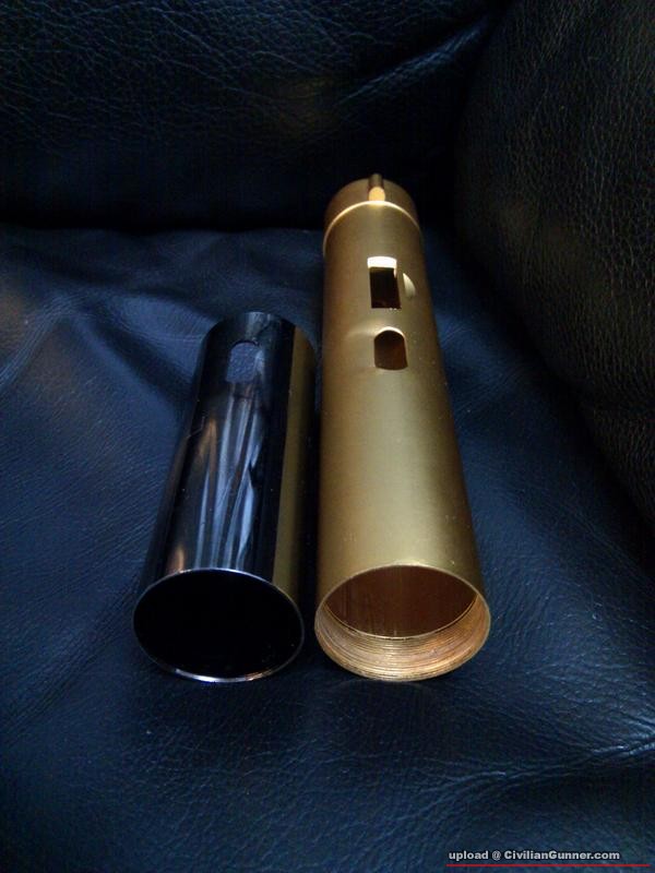

AEG 筒 (M4) VS PTW 金筒
小弟作了一些量度。
AEG 筒 (M4)
r = 1.18 cm ; h (行程約) = 4 cm
容積 V = pi X r^2 X h = 17.5 cc
PTW 金筒
r = 1.18 cm ; h (行程約) = 3.11 cm
容積 V = pi X r^2 X h = 13.6 cc
