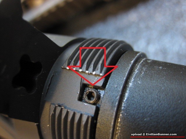

新槍接近完成,發覺全鎗顏色較黑,重量較舊版輕。
原帖由 joehon2012 於 31-3-2011 16:47 發表
ching請問有遇到jacky ching所講呢個問題嗎...?
31-3-2011 20:57
唔好意思...借jacky ching圖一用
應該所有DYTAC PTW外管都係咁
不過可以DIY一粒縲絲解決
其實可以挖大小小個0隆,之後打返原裝果粒野入去.
原帖由 jackypoon 於 1-4-2011 02:33 發表
又係辦法喎.....

can someone tell me what exactly the problem with the dyetac barrel is?  i've look at the pic so many times and still don't get it but i want to get one to lower the weight of my gun.
also can you install the iron sight with the aluminum milspec barrel?
the allen screw on the barrel is smaller than the slot on the upper receiver, there would be some rotational movement after mating the barrel with the receiver. You can either put some shims in between or you could use a larger allen screw.
想問下ching,原裝果粒野係要打曬入去定係打一半?
