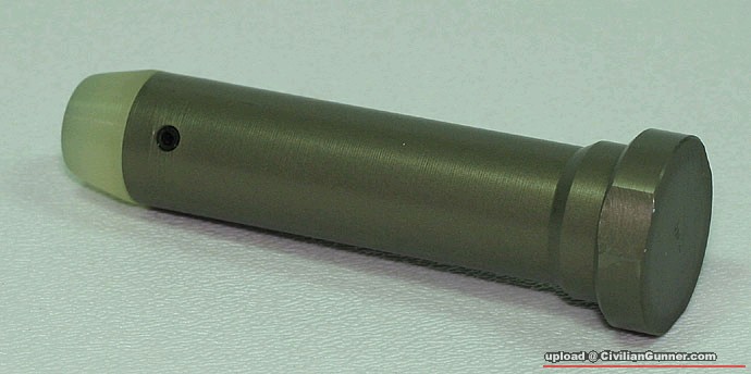

GBB M4 Buffer 有乜用?

o岩o岩手痕抽走左個 buffer , 再拉 bolt ... 結果知到其中一個原因了 .
如果無 buffer ,個 bolt 成組會後退過龍,比個 hammer 頂住回唔返去。

最簡單答,模擬真鐵構造,頂住份Bolt

Why aluminium better orginial buffer?
原帖由 B20_hk 於 7-9-2009 10:55 發表
Thanks
I guess, same theory as hang gun with plastic slide
lighter material = less energy need to move the bolt = faster bolt movement

首先鋁buffer硬d, 耐用d, 二來像真, 三來有隻hr buffer, 令gbb動作個recoil力度加大, 更模擬真鐵動作, 而且如果係@gm, 原裝果個係膠buffer, 又唔好睇, 又唔耐用

people who like a harder "recoil" will choose a heavier buffer or put weights into the buffer. However soft metal such as lead will deform in the buffer easier. That's why some manufacturer choose to use polythene-based material

I changed to HR butter today
