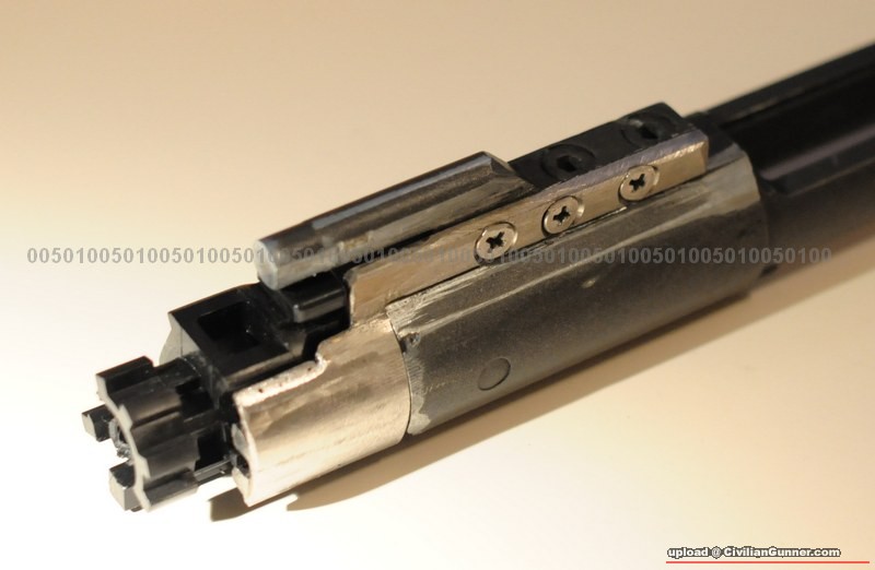

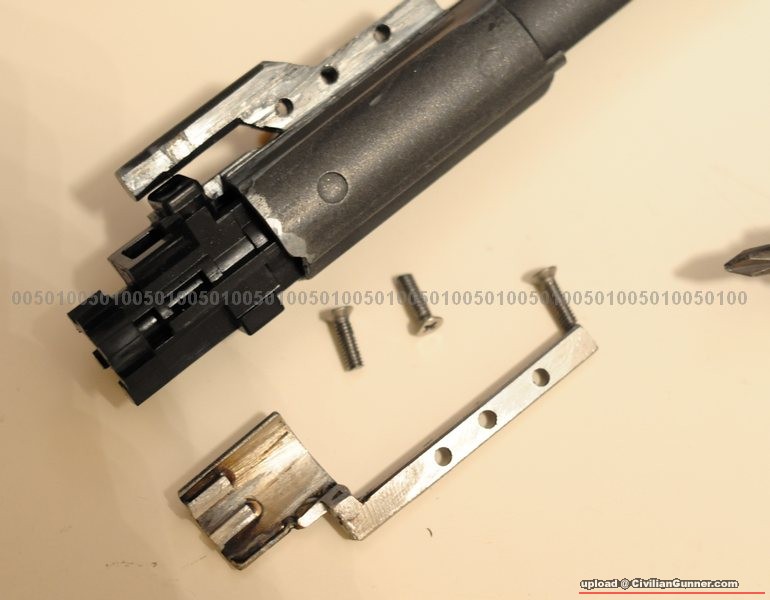

有有 有料到,但係重欠個Bolt.攪攪下攪禁耐.雞啼啦!
等到秋來冬又到,攪支電槍爽過年.(LMT)

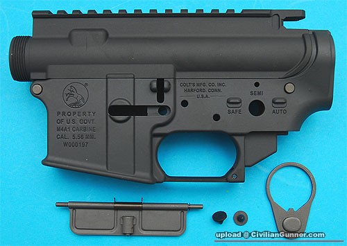

始於見Colt 身啦 !!

How Much ???
$1250
$1250?!?!?!??!??!?!
抵!!!
係wor, 有無師兄知, GP 個身裝真grip 會唔會都係有高低級?
Thanks
The fit between the upper and lower receiver (the $1250 metal receiver)is not as tight as you would expect by comparing to the WA one (which is exceptionally tight).
The good thing is (a) it works and (b) real steel m4/ar15/m16 do have some play between upper and lower receiver as well.
The bad thing is of course it rattles!!
There are a number of methods (some with side effects) ussed in real steel to fix the problem, i.e. o-ring, the "accu-something" or epoxy bed the upper and lower receiver...In other words you could either fix it like real steel or leave it as it is

唔知有冇廠肯出呢件改Bolt件呢,可能都幾好賣.

拜服~!!!
