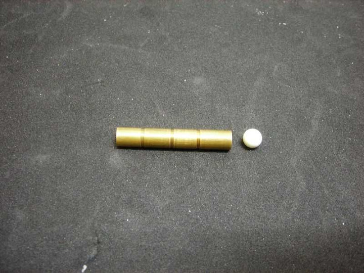

»s§@¿z¼uªO«e, ¥ý»s§@¦n´ú¶q¤Õ®|ªº gauge rod
Gauge rod ¤W¦³¥|¬q, ¤À§O¬O 5.93mm, 5.95mm, 5.97mm ©M 5.99mm ªºª½®|
Gauge rod ªº¥Îªk: ­è boring ¦n¤@­Ó¤Õ, ©ñgauge rod¶i¥h, gauge rod¥d¦b¤¤¶¡, 5.95mm¬q¥i¥H¶i¥h, ¦ý 5.97¬q¶i¤£¤F, ³o¼Ë«K¥i½T©w³o¤Õªºª½®|¬O 5.96mm

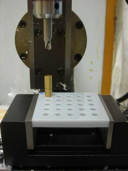

»s§@¹Lµ{:
¿÷¤U¨Óªº½¦ªO, ¥ý fly cut ¤@¤U¥|Ãä
¦A center drilling , ¦@ 25­Ó¤Õ

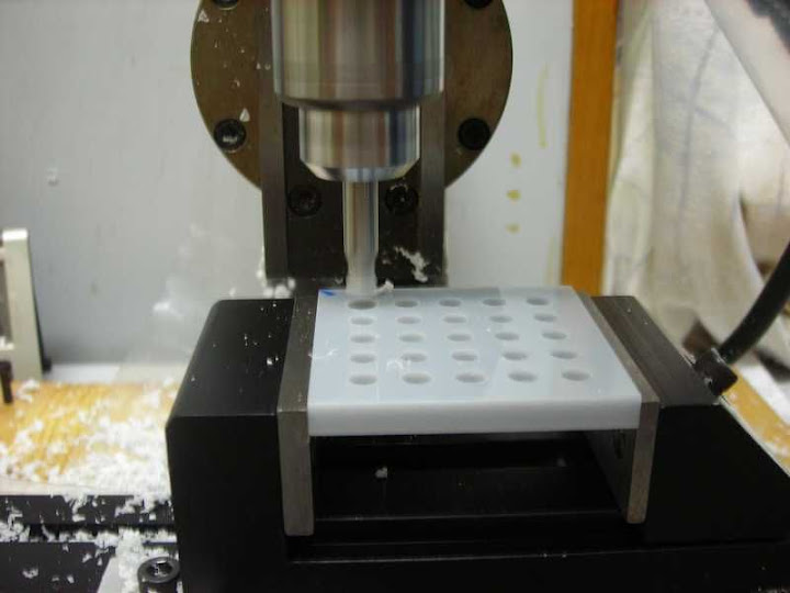

¦A¨Ó 5.5mm drill through

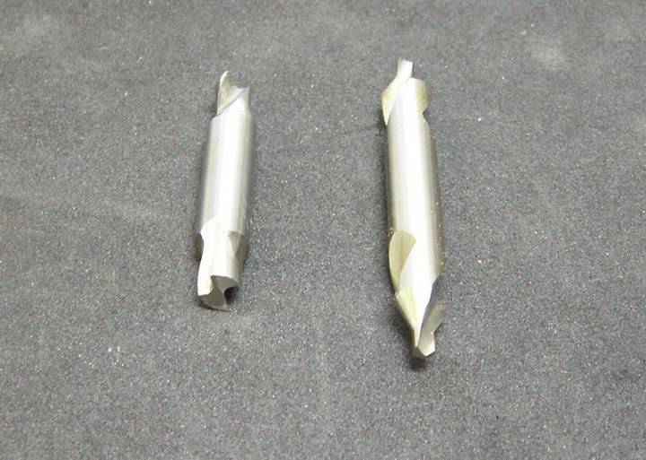

³Ì«á, ¥ç¬OÃø«×©Ò¦b, 5.9x mm boring, ¦]¬°¼È®É¥u¦³³o­Ó¿z¼uªO project »Ý­n¦bªO§÷¤W¥[¤u¥X «D¼Ð·Çªº¤Õ, ©Ò¥H§ÚÁÙ¤£±Ë±o¶R¤@®M±M¥Îboring tools
§Úªº¸Ñ¨M¤èªk¬O: §â¤@¤ä center drill ¿i¦¨ boring tool, ¸Ë¦b¼Ð·Çªº drill chuck ¤W, ·íµM, self centering ªºdrill chuck¤£¯à©M¥D¶b¦P¤ß, ¦Ó¥B off center ªº¦V©M¶q³£­nºCºC§ä¥X¨Ó, §Q¥Î³o­Ó°¾¤ß, ¥Î¿i¥X¨Óªºboring tool ¥i¥H¥[¤u¨ì 5.94mm 5.96mm©M5.98mm ªº¤Õ (·íµM§ä¥¿½Tªº¦ì¸m»Ý­n®É¶¡©M­@¤ß)

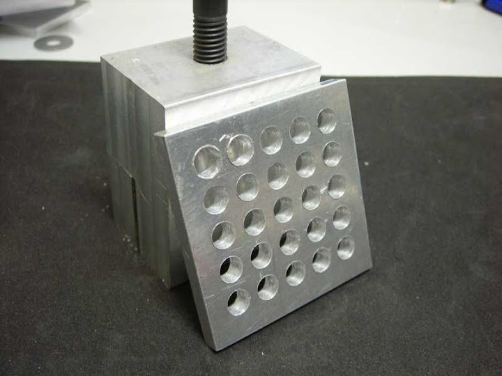

§¹¦¨«áªº¼Ë¤l
¤é«á¦³¾÷·|, ¦A¦b¤á¥~´ú¸Õ¤@¤U, ¿z¿ï«áªºbb¼u, ·|§_¦b¶°¼u©Ê¤W¦³©úÅ㪺§ïµ½§a!

²Ä¤@½»¹Ï¤¤ªº´N¬O¥Î¤FÁnºÙ¬O6061ªº¾T¦Xª÷¨Ó»s§@(¶Rªº®É­Ô¦ÑÁ󻡬O6061), ¦ý¬O, ¤£ª¾¬°¦ó, ¸Õ¤F¦h­Ó cutting speed »P feedrate ªº²Õ¦X, ¥[¤uªí­±¨ÌµM¤£¥­¾ã(·Pı¤ñ¥¿±`ªº6061³n), ¥Ñ©ó¤£·Q®ö¶O¤@¤Ñªº®É¶¡¥~¥X¦A¶R§÷®Æ, ©Ò¥H¤~¥Î¤F¤âÃ䪺½¦ªO, ¤é«á¦³®É¶¡ªº¸Ü, À³¸Ó·|¶R¨Ç¦n¤@ÂIªº§÷®Æ¨Ó»s§@
