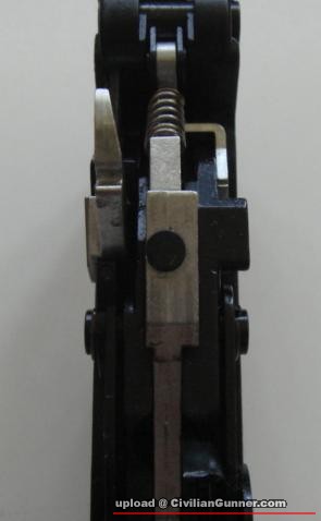

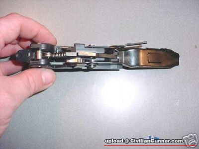

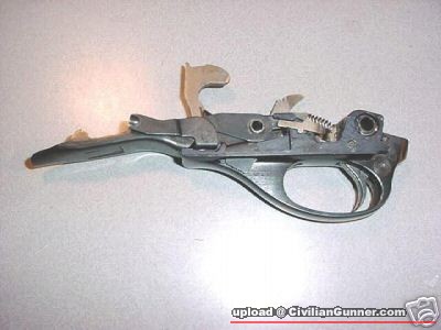

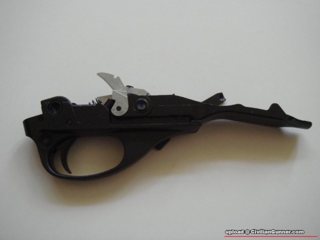

You can find that these trigger group is very similar, The dimension is same and the trigger pins location and the size also, But Tanaka Tigger pin (Small one) is not like realsteel is pass thru the receiver. For the Maruzen, Trigger location is not same as realsteel even Tanaka, So it cant install New KAC RAS
28-1-2007 11:52
Tanaka Trigger
28-1-2007 11:52
Tanaka Hammer
28-1-2007 11:52
Remmy Trigger
28-1-2007 11:52
Remmy Hammer
  • 14692 威望 +10 非常詳細 28-1-2007 20:25
  • gtoray 威望 +10 原創內容 28-1-2007 13:03
  • gtoray 金錢 +10 原創內容 28-1-2007 13:03

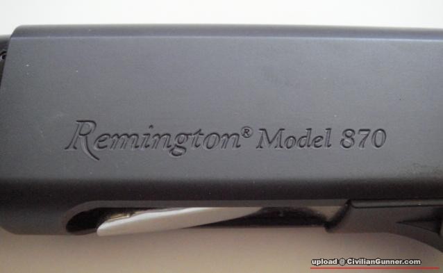

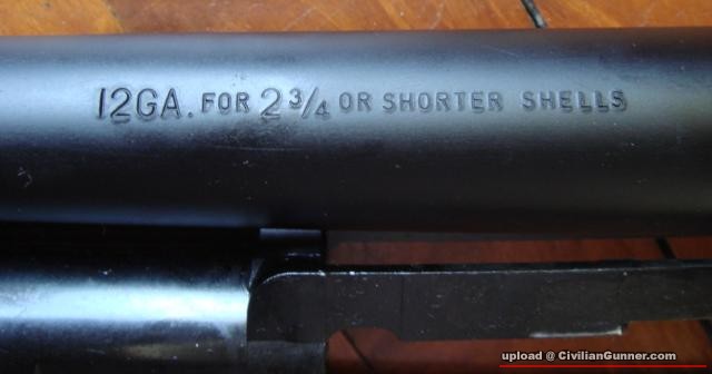

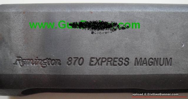

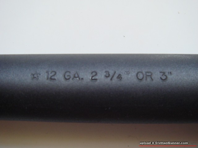

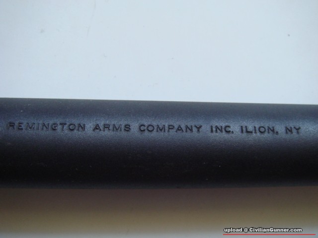

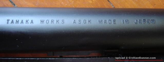

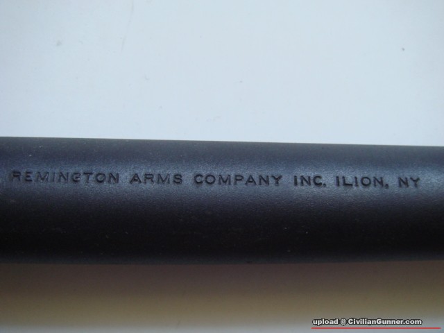

For the Barrel marking:
First 2 pics are realsteel, other is Tanaka
28-1-2007 12:18
28-1-2007 12:18
28-1-2007 12:18
28-1-2007 12:18

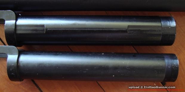

For the Slide tube of the forearm of the Tanaka is slightly bigger(2mm) than realsteel slide tube, So if you want to install realsteel forearm it need to do some modification.
28-1-2007 12:30
原帖由 candeocic 於 28-1-2007 12:18 發表
As I remember different era or type of 870 have different markings on the barrel.

原帖由 sunny 於 28-1-2007 12:45 發表
Usually, Shotgun barrel is divide by few type , 1: Shell type 2-3/4" or 3", 2: Slug barrel or Normal barrel, 3. Rib or non-Rib, 4. Rifled or Smooth barrel.
For now, Remington shotgun also have few line for different purposes, Wingsmaster(Wooden stock and forearm), Express(PA 6/6 GF filled stock and forearm Usually Home defense), Youth, and Marine(treated with heavy duty anti-corrosive surface finishing)
Candeo
原帖由 candeocic 於 28-1-2007 13:00 發表
For now, Remington s ...
U had missed the Super Magnum 2 3/4-inch or 3 1/2-inch.

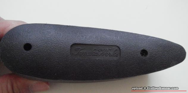

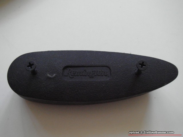

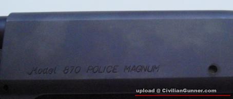

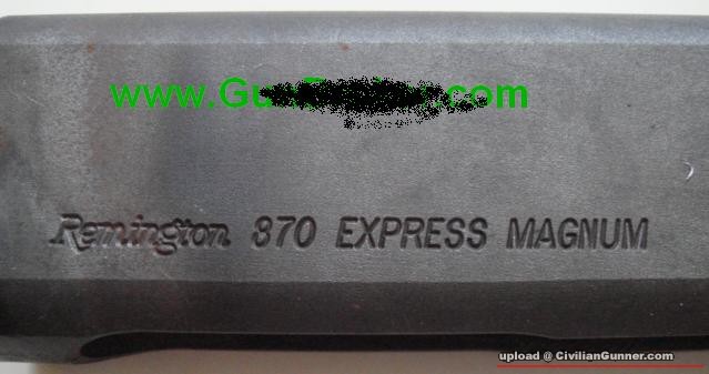

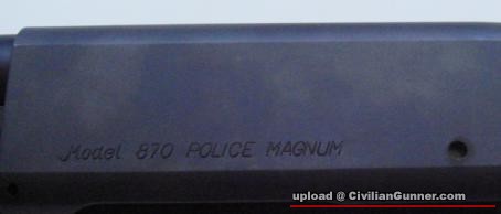

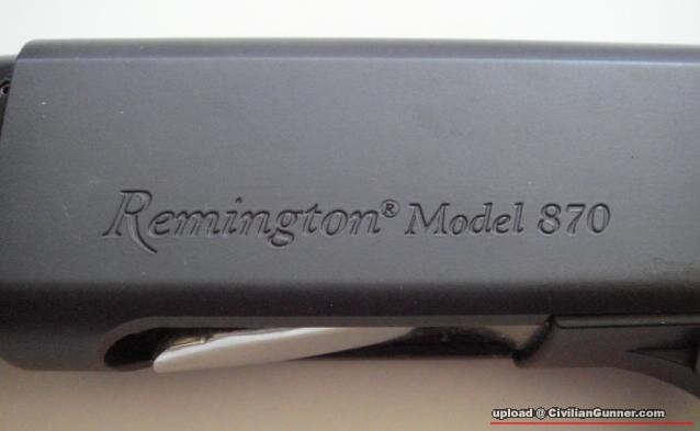

More compare on the recoil pad and Receiver Marking
28-1-2007 14:52
Tanaka
28-1-2007 14:52
Remmy
28-1-2007 14:52
G&P
28-1-2007 14:52
Tanaka
28-1-2007 14:52
Remmy
  • gtoray 威望 +10 原創內容 28-1-2007 23:41
  • gtoray 金錢 +10 原創內容 28-1-2007 23:41
