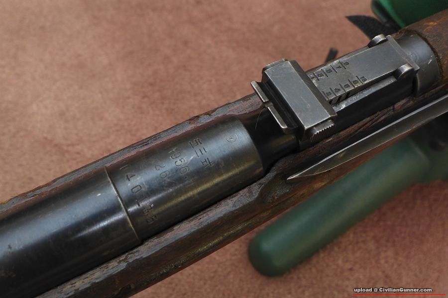

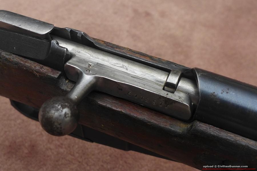

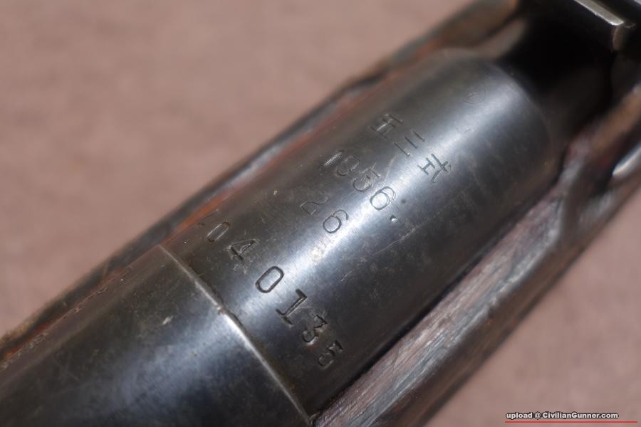

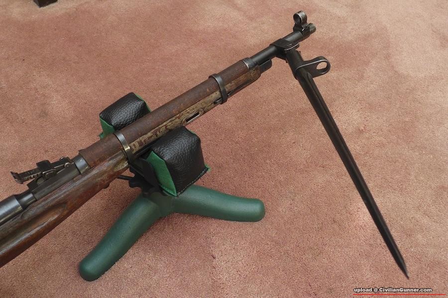

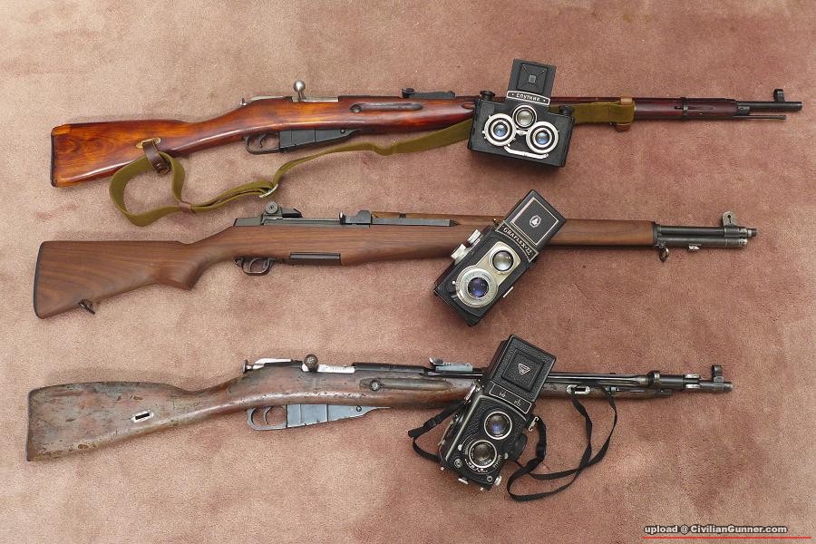

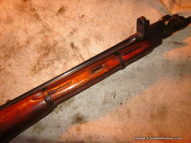

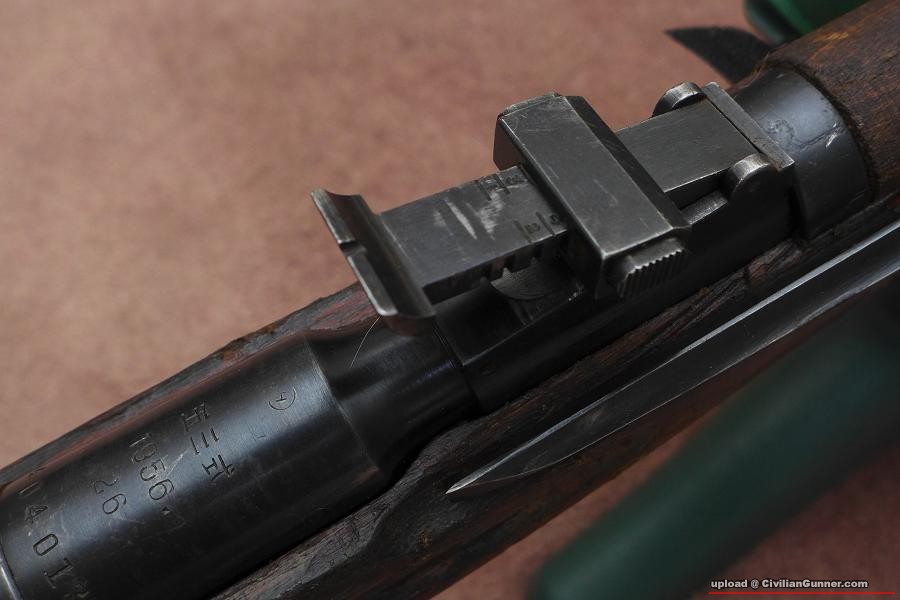

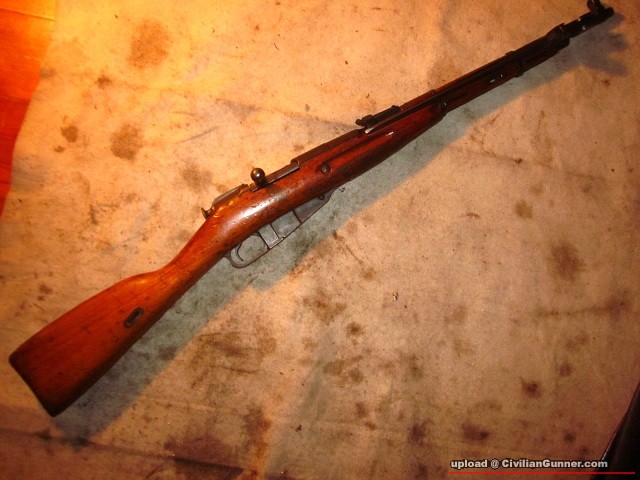

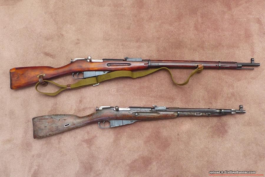

今日去攞咗支大陸 Mosin-Nagant,中文叫 53式步騎槍,係蘇聯 Mosin-Nagant M44 的完全 copy 版,用料比蘇製的差,木材用料差好多好多。呢支 56 年出產,韓戰冇佢份,可能文革或越戰時殺過人都唔奇。
買呢支槍,因為未擁有過國產槍,雖然中正式,漢陽式都唔貴,但大多已經不能夠安全發射,有爆 chamber/槍管可能,而 53 式較容易買到,所用子彈 7.62x54r 周圍都買到,所以就選擇佢為我第一支國產貨。

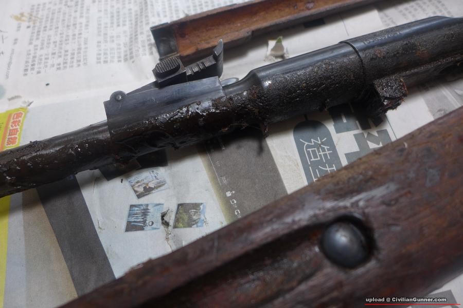

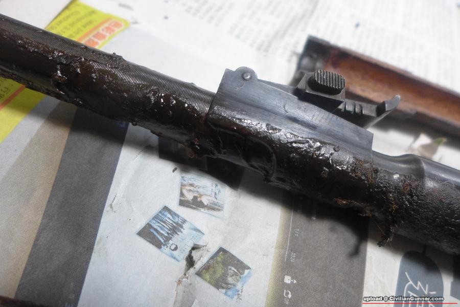

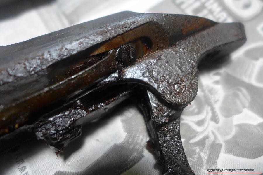

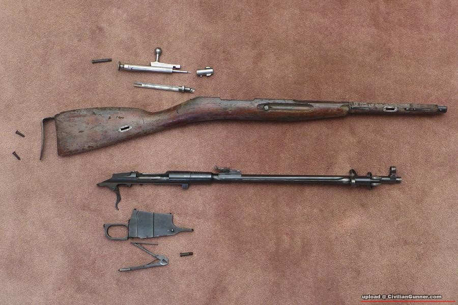

網上買的,舖頭講到明唔 check 槍,來貨袋都唔拆就寄走,話到明 condition 差,所以預咗溶溶爛爛。第一眼望落去唔差,以為冇咩 cosmoline,點知一拆開,嘩!!! 入面全部都係,煲桶熱水,用洗潔精、牙刷搞咗幾個鐘,用銅刷清埋槍管頭先終於搞掂,聽日裝返好支槍再影過啲相。所有 parts serial number 都唔對,冇咩所謂啦。
本來打算磨滑槍身,而家都費事喇,殘殘地咪幾好。
講住咁多,明天砌槍!!

煲滾水做咩
原帖由 Lolanto 於 21-2-2013 00:19 發表
煲滾水做咩
所有部份全部用滾水浸,一邊浸一邊刷,一定要用熱水先可以洗走啲 COSMOLINE,而家個木身乾緊,所以未可以合體住。

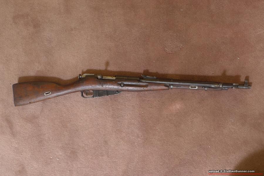

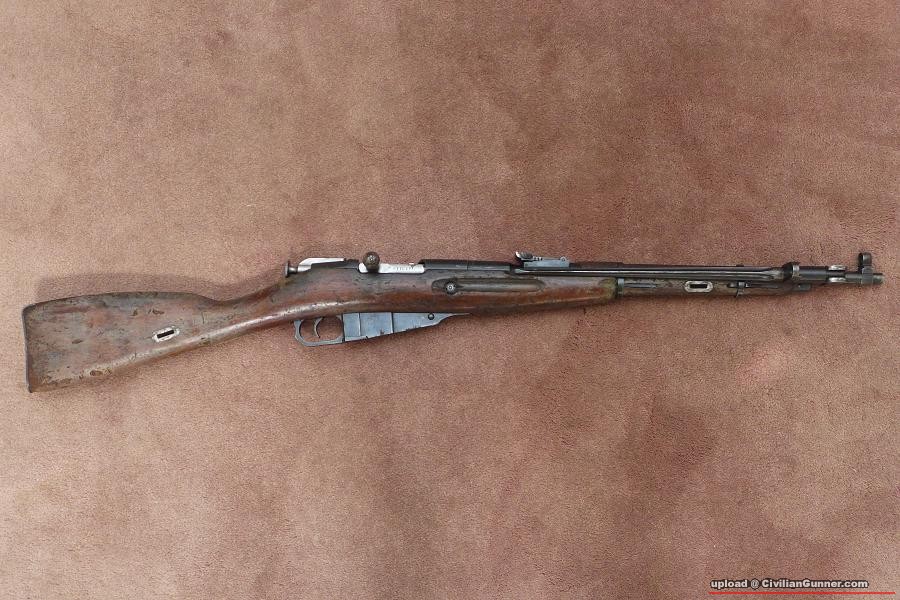

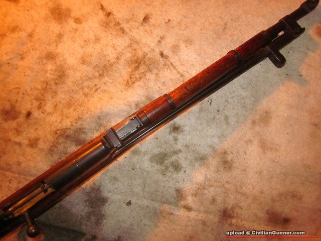

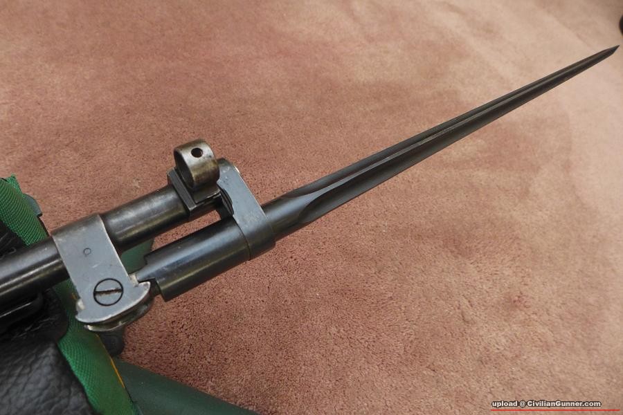

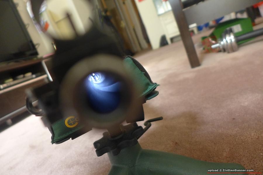

琴日搞咗幾個鐘,今日支 STOCK 乾了,大部份 COSMOLINE 都清理好,今日將把槍回復原狀了。想 sand 吓個 stock,但都係懶,唔整喇,由得佢咁樣都唔錯丫。
CHINESE MOSIN-NAGANT M53,五三式騎步槍,又名「水連珠」。

Ching how did you remove cosmoline from the stock?
原帖由 Tekkno 於 21-2-2013 16:00 發表
Stripped down the rifle. I tried to put all metal parts in the oven to remove cosmoline, but the heat only softened it a little. At the same time I boiled water and pour it into a big bucket. Put everything inside including the wooden stock and all metal parts. Soaked them a while. Put a lot of dishwashing detergent. Used a tooth brush to scrub all parts. Put more detergent and scrubbed over and over again.
The wooden stock is difficult. No matter how hard I tried, there's still some cosmoline on it. I just leave it. Used kitchen towel to rub all remaining cosmoline over and over. Dried the stock then put them back together.
It was tiring!!
you soaked the stock in water?
原帖由 Tekkno 於 21-2-2013 18:15 發表
Everyone does the same when cleaning off cosmoline. Search YouTube and you'll see.
NO! never soak oldass wood in water, the proper way is to use heat to oooze out the cosmoline in the stock, soaking stock in wood will destroy the wood   I put my stock in the oven and baked with low heat, now 90% of cosmoline are gone
原帖由 Tekkno 於 21-2-2013 19:27 發表
NO! never soak oldass wood in water, the proper way is to use heat to oooze out the cosmoline in the stock, soaking stock in wood will destroy the wood   I put my stock in the oven and baked  ...
Absolutely no problem. When soldiers carrry their rifles in the battle field, they have to cross rivers and lakes and all kind of terrain. They can sustain rain, snow, and heat. Soaked and dried repeatedly.
Rifle stock is not made from cheap low grade wood, not even the Chinese Mosin-Nagant. Today's new rifle/shotgun stocks made of wood, the factory would soak the wood in water to see the wood pattern. Of course those are made of excellent quality wood. Just want to say, rifle stock can be soaked in water without any problem.
